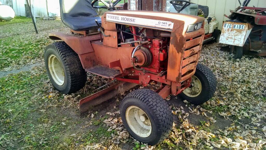

Achto 29,427 #7 Posted January 7, 2021 5 minutes ago, ebinmaine said: Do we know if they run true to size? Not sure on the size being true or not. I recently posted a pic of my 1076 with the Deestones on. I'll add some here for a refresher. 2 Share this post Link to post Share on other sites
TJ5208 1,841 #8 Posted January 7, 2021 thanks nice tractor older one to 1 Share this post Link to post Share on other sites
Achto 29,427 #9 Posted January 7, 2021 2 minutes ago, Tj salyers said: um what kind of tractor do you have achto I have multiple tractors ranging from 1960 - 1989. More tractors than I have roof for. 2 Share this post Link to post Share on other sites

Achto 29,427 #13 Posted January 7, 2021 (edited) 21 hours ago, Tj salyers said: how about a 800 special like mine My C141 is the same body style as your 800 Special. Edited January 8, 2021 by Achto 1 Share this post Link to post Share on other sites
