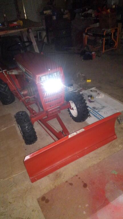

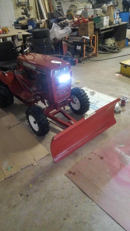

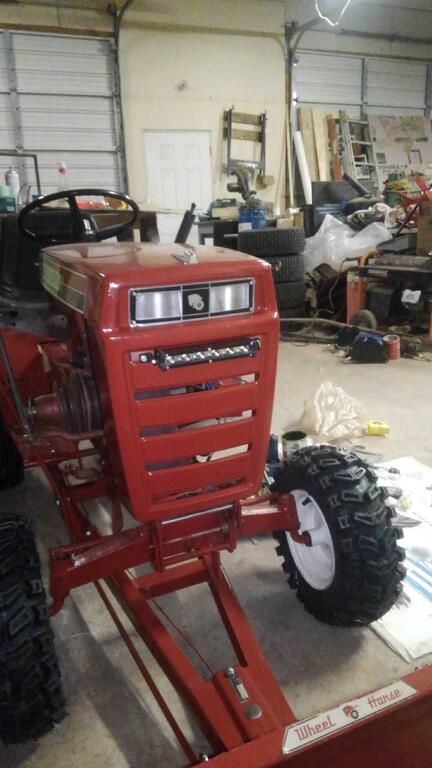

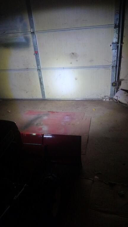

Rusty Tinsnips 477 #1 Posted January 6, 2021 (edited) 11$ from fleabay. It's set up without drilling any new holes and wired in without changing anything. I can unplug it and plug the hot wire back into the original bullet connector for the OEM lights. I did run a separate ground wire to the frame. The OEM lights still work, was waiting for the 1156 LED's to come in the mail that I ordered 3 weeks ago. It is 18watts and seems plenty bright enough to plow snow at night. Edited January 6, 2021 by Rusty Tinsnips 5 4 Share this post Link to post Share on other sites
roadapples 6,986 #2 Posted January 6, 2021 (edited) I used the same one on a C160. Only I removed the light assembly and put it where the original was. Drilled 2 new holes in the brackets that came with the light. None in the hood. The light is 7" long. Six cree bulbs, 3600 lumens. I think only 1.3 amps. CRS. Really lights things up... Used original wire-5 amp fuse... Edited January 6, 2021 by roadapples 3 Share this post Link to post Share on other sites
