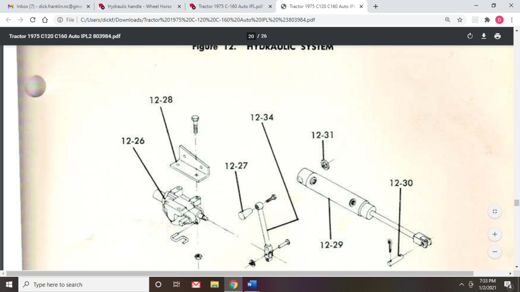

953 nut 69,147 #5 Posted January 3, 2021 Is the lift handle like the one shown below (12-34)? If it is you should contact Lincoln at A to Z Tractor parts, https://a-ztractor.com/, he will fix you up. Share this post Link to post Share on other sites
