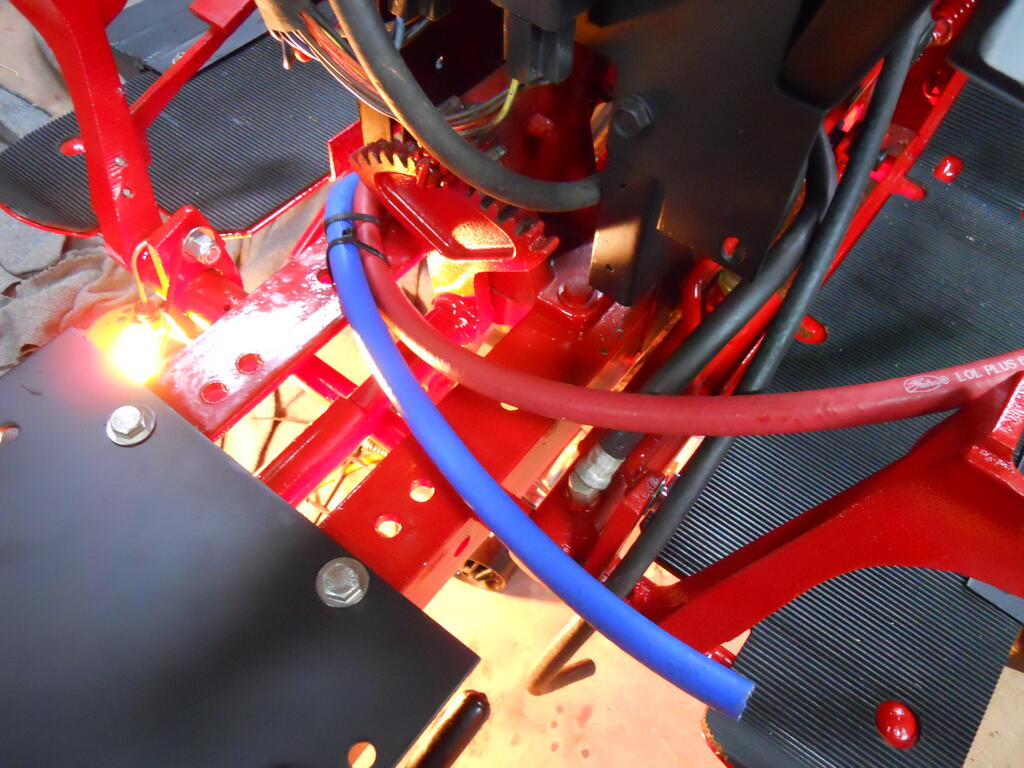

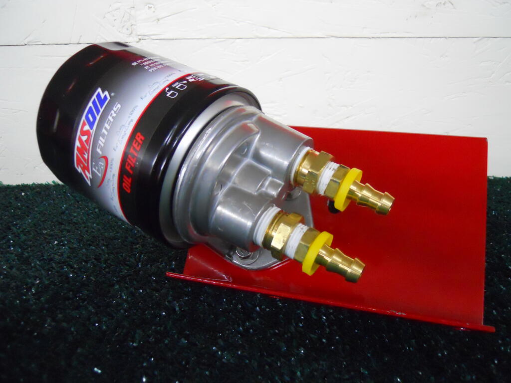

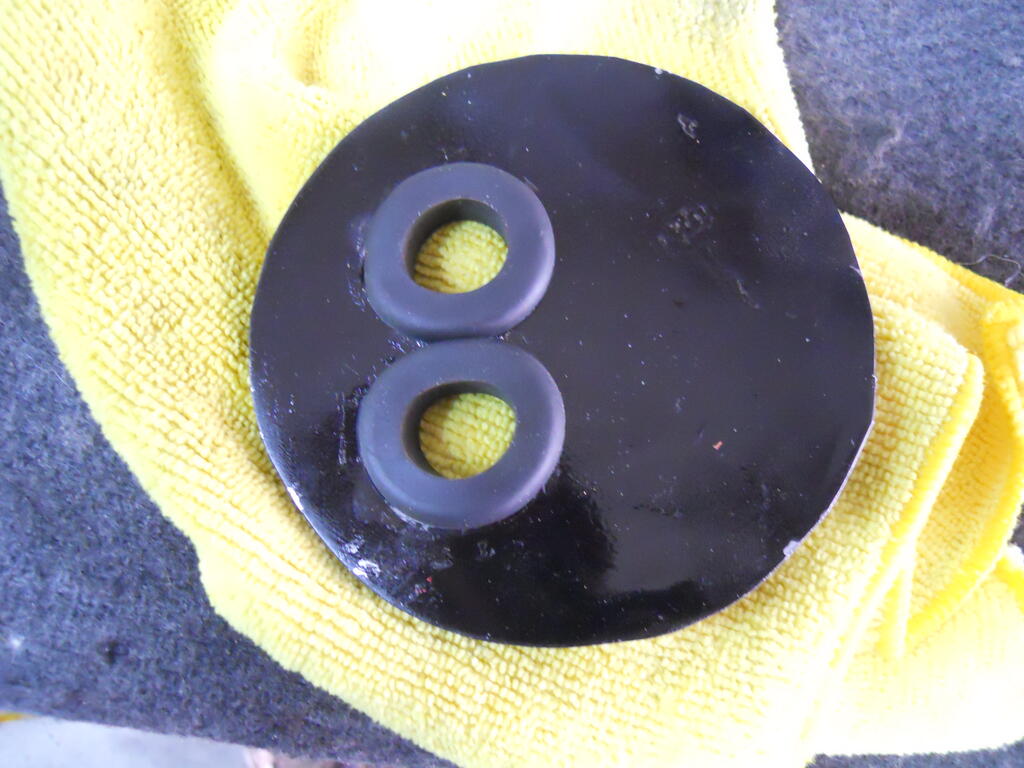

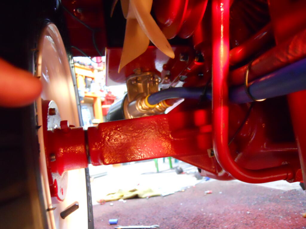

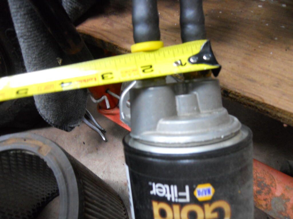

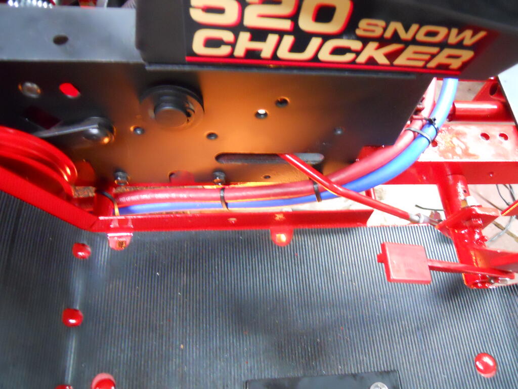

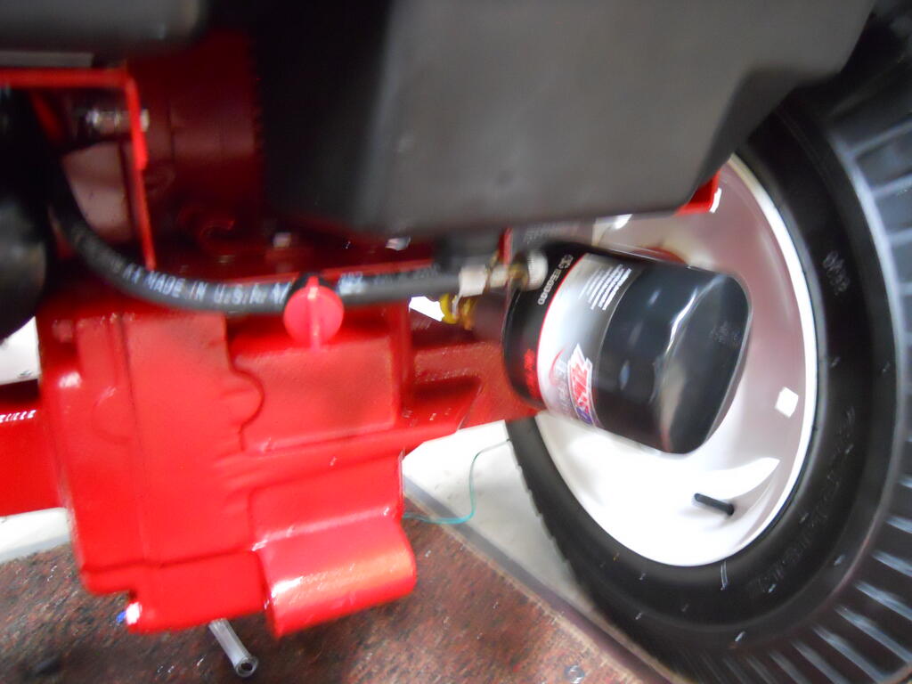

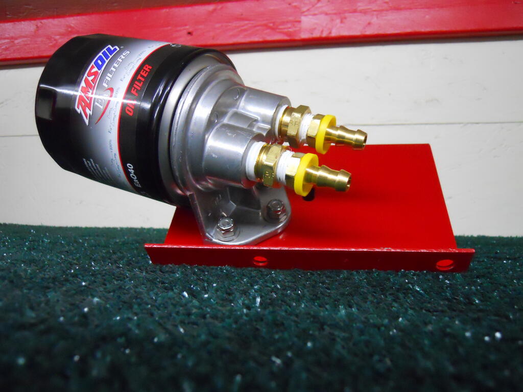

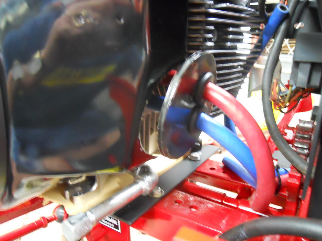

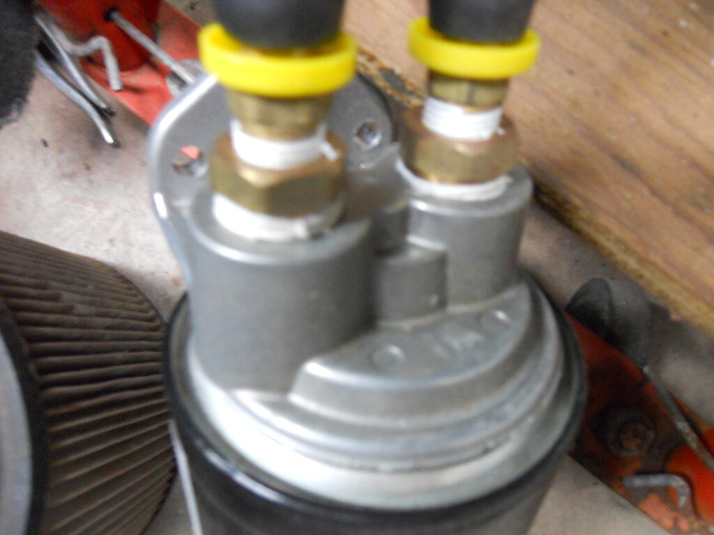

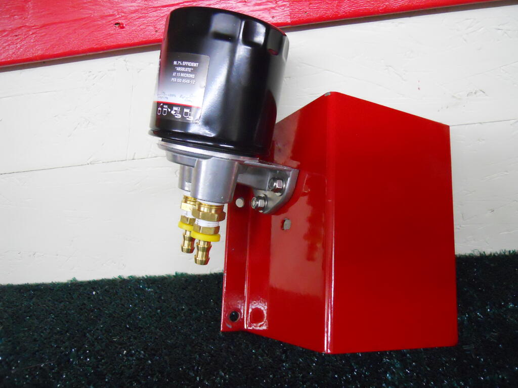

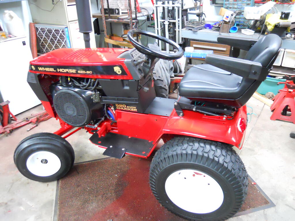

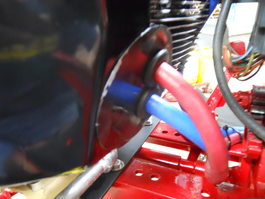

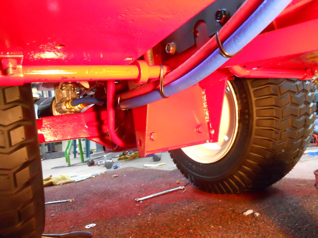

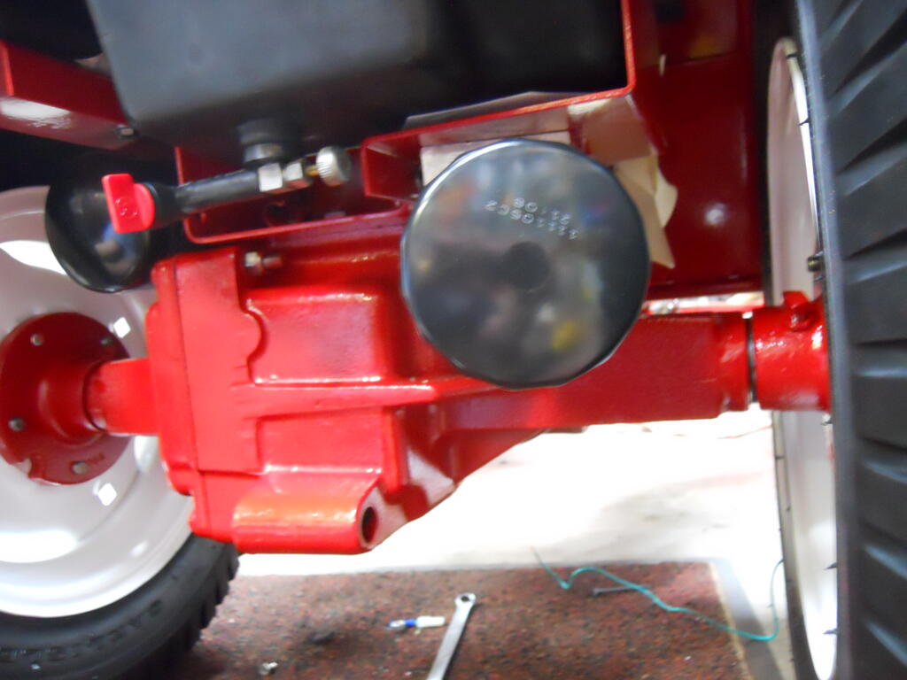

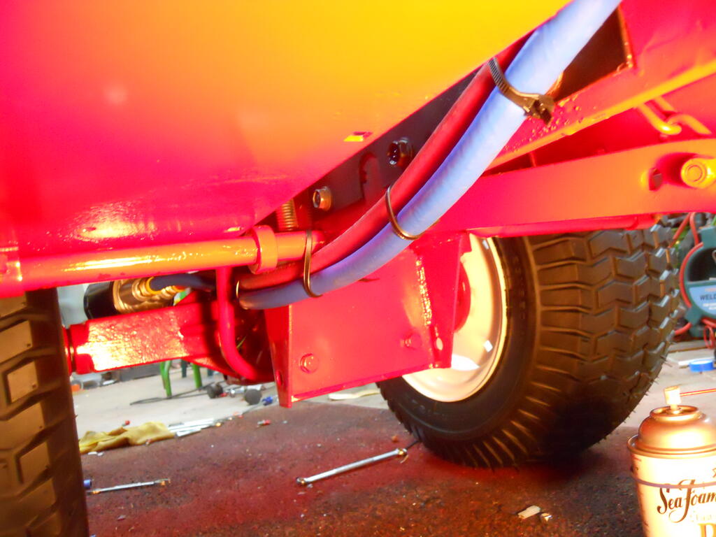

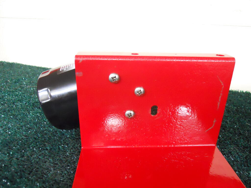

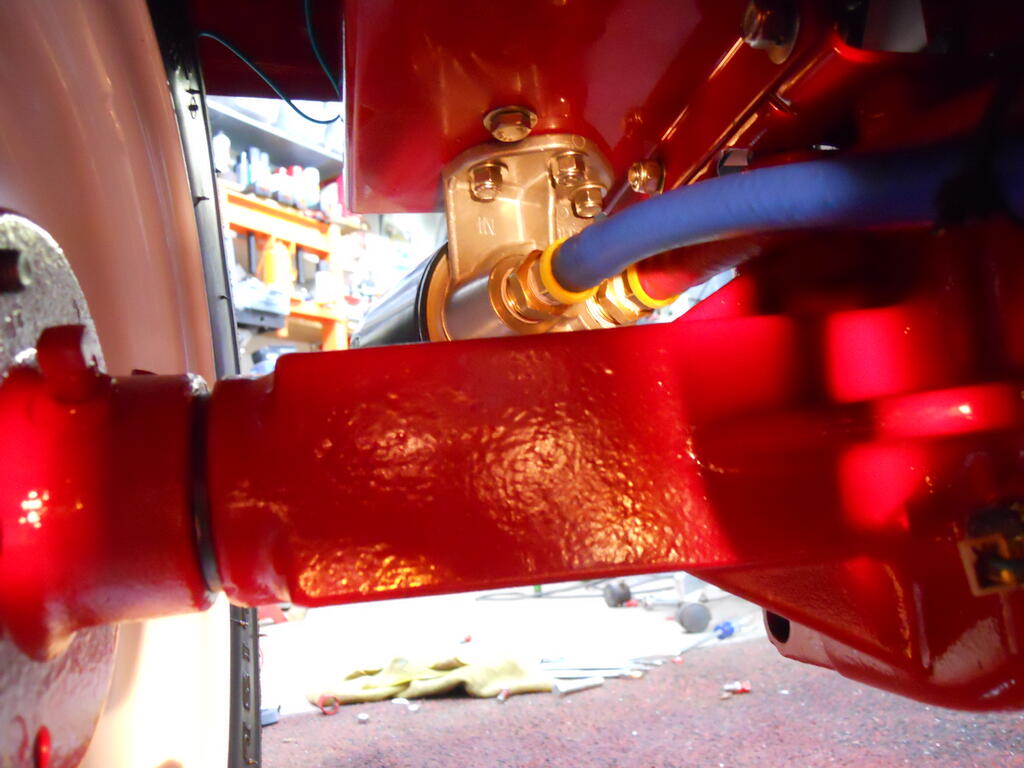

HorseFixer 2,013 #1 Posted December 30, 2020 (edited) There are many reasons to name a Few The person at TORO who decided to block the airflow on the back cylinder Under the Motor Tins should have had his head examined. As you all know the 520H has a long history of the valves going on the rear Cylinder. Remote mounting the Oil Filter takes care of that Plus the remote oil filter bracket lets you install a larger filter to protect your engine. I have in my possession Several of these filter adapters that have worked excellent the past 10 years on My Snow Chucker and I have a Digital Oil Pressure Setup. Works Great. HERES SOM OLE Pics when I Did mine. Also alot of heat can be taken away from getting the exhaust out from under the hood on the right rear side. That is, if you don't like Roasted wiring! The other thing servicing is much easier among other things. Edited December 30, 2020 by HorseFixer 5 7 Share this post Link to post Share on other sites

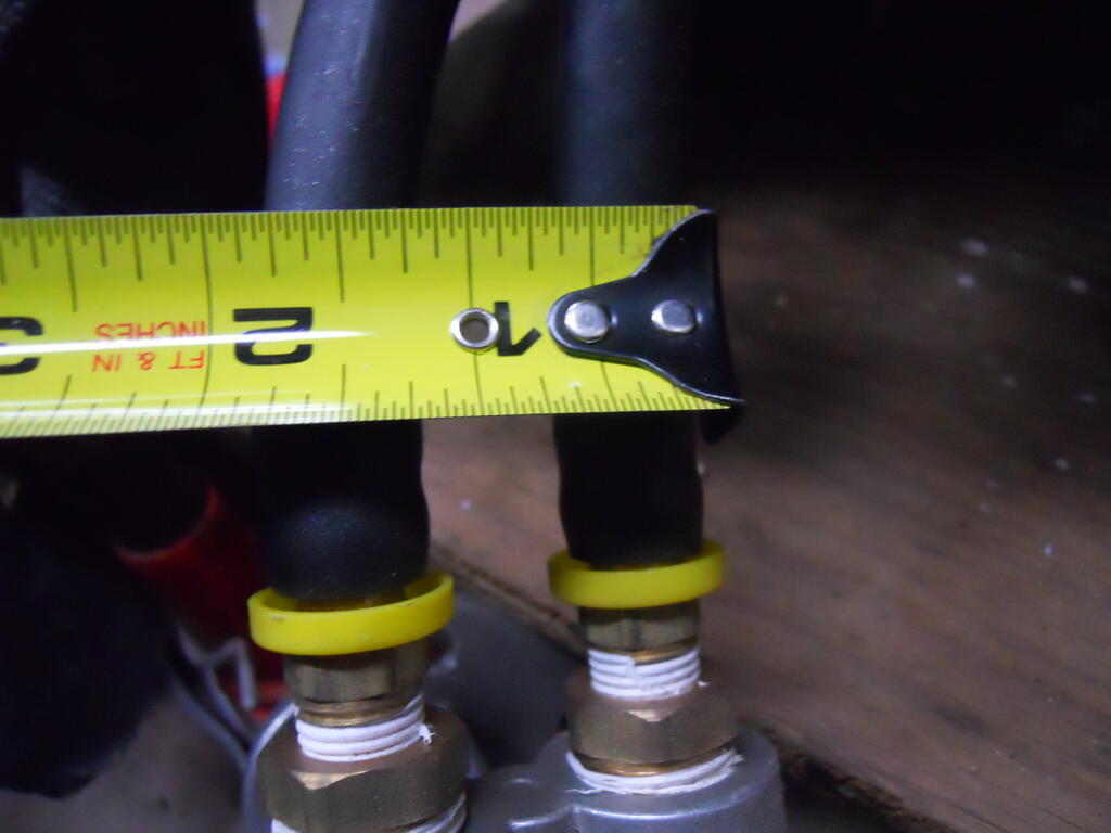

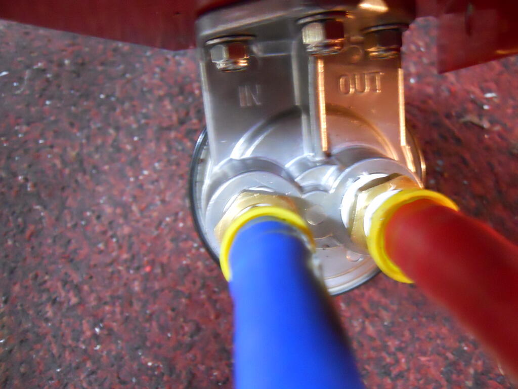

Pullstart 67,159 #2 Posted December 30, 2020 The second to the last pic, the block adapter... those plugs is where the oil comes from and goes back to? I imagine they have 90 degree barbs for the hoses? Share this post Link to post Share on other sites

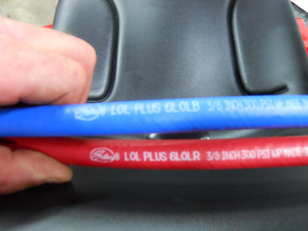

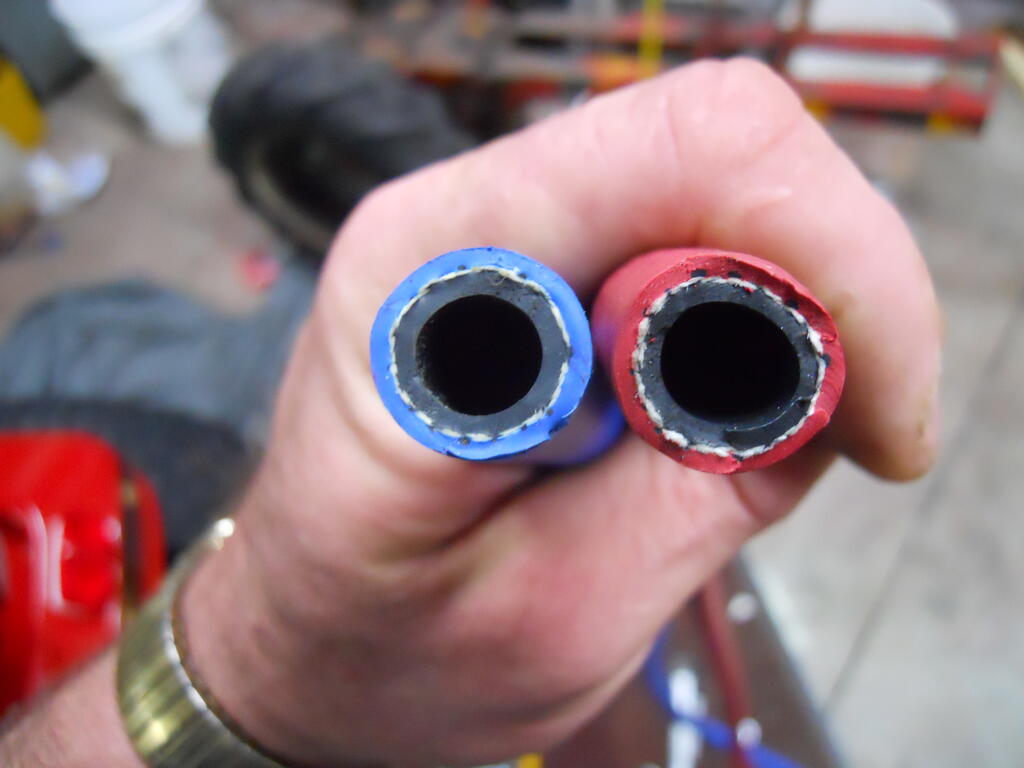

HorseFixer 2,013 #3 Posted December 30, 2020 (edited) 4 minutes ago, pullstart said: The second to the last pic, the block adapter... those plugs is where the oil comes from and goes back to? I imagine they have 90 degree barbs for the hoses? Yes The Red Hose is the return back to the Engine from the Oil Filter, and Blue feeds the Oil Filter. Edited December 30, 2020 by HorseFixer 1 Share this post Link to post Share on other sites
peter lena 9,323 #4 Posted December 30, 2020 HORSEFIXER, solid idea to fix a chronic problem, your pictures and layout say it all. having changed and modified a number of horse issues myself , find it only adds to the enjoyment and function of your horse. great change , thanks for sharing, pete 1 Share this post Link to post Share on other sites

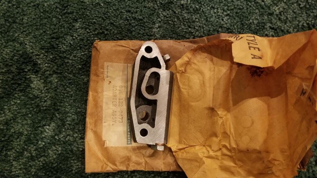

Bill D 2,294 #9 Posted December 31, 2020 I like it. Is the plug for the shroud a factory piece? If so what is the part number? If not how did you make it? How much are you asking for those adapter blocks. Bill Share this post Link to post Share on other sites

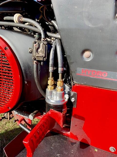

Greentored 3,220 #10 Posted December 31, 2020 (edited) @HorseFixer I did it on my 520H last year after reading your posts about it, but used a thread on adapter right onto the original filter boss. Much easier access, less oil mess inside the shroud for dirt to collect, no more need for the 'seal' between the shroud and filter. Another benefit is anytime you can carry oil away from the engine and back, it helps with oil temp- that's big on air cooled engines! Simply adding external oil drain tubes from the heads back to the crankcase on an old Harley shovelhead will drop the oil temp 10 degrees. On another note- I also 'tightened' the steering based on your youtube video. This was my very first Wheel Horse, and you showed me just how easy they are to work on! I hold you partially responsible for this addiction and barn full of machines that I knew would NEVER happen to me Edited December 31, 2020 by Greentored 1 Share this post Link to post Share on other sites

oilwell1415 563 #12 Posted December 31, 2020 9 hours ago, Greentored said: @HorseFixer I did it on my 520H last year after reading your posts about it, but used a thread on adapter right onto the original filter boss. Much easier access, less oil mess inside the shroud for dirt to collect, no more need for the 'seal' between the shroud and filter. Another benefit is anytime you can carry oil away from the engine and back, it helps with oil temp- that's big on air cooled engines! Simply adding external oil drain tubes from the heads back to the crankcase on an old Harley shovelhead will drop the oil temp 10 degrees. On another note- I also 'tightened' the steering based on your youtube video. This was my very first Wheel Horse, and you showed me just how easy they are to work on! I hold you partially responsible for this addiction and barn full of machines that I knew would NEVER happen to me I like that you mounted the filter vertically and close to the engine. Those are the only things I would have changed about the OP's installation. Mounting the filter vertically allows you to prefill it with oil during an oil change instead of having to rely on the pump to do so. That prevents several seconds of the engine running without oil at the first start up after an oil change. Having shorter hoses minimizes how much oil has to be pumped before it gets to the engine. 3 1 1 Share this post Link to post Share on other sites

seuadr 489 #15 Posted March 25, 2021 @HorseFixer Hey, question for you - i have the OEM kit that i am working on installing on a new motor - did you stick the sending unit for the oil pressure in that plot on the top of the filter adapter? i'm trying to figure out if i can find/fit a sending unit that will do a pressure and the idiot light (cause i'm an idiot ) and wondering if you have any pictures? what i would really love is to find a combined temp/pressure sending unit, but so far that has been no bueno. Share this post Link to post Share on other sites
