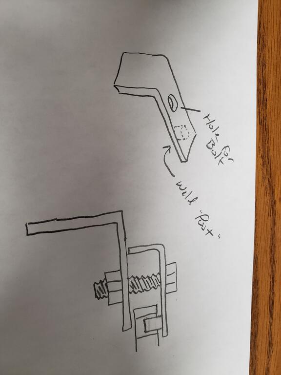

71_Bronco 1,072 #4 Posted December 30, 2020 (edited) Here's another idea I just came up with. Make 2 of these "clip" things and bolt them on as sketched. Edited December 30, 2020 by 71_Bronco 1 Share this post Link to post Share on other sites
ranger 1,838 #5 Posted December 30, 2020 Do you have a welder? If so how about welding a couple of small 1/4” thick tabs, or one longer strip along the inside of the frame rail. Then drill the required holes? The longer strip maybe the best option, you can omit weld from the areas where the holes will be to make drilling easier. 2 Share this post Link to post Share on other sites
JoeM 9,391 #6 Posted December 30, 2020 I have used the J bolt thing on a 12HP Kohler engine that did not have the drilled holes in the sump plate. A little opposite of what you are doing. used the J to wrap around the angle iron leg and through the hole in the engine. Worked great no issues. heated up grade 8 bolts and bent. You have two good holes. 1 Share this post Link to post Share on other sites
