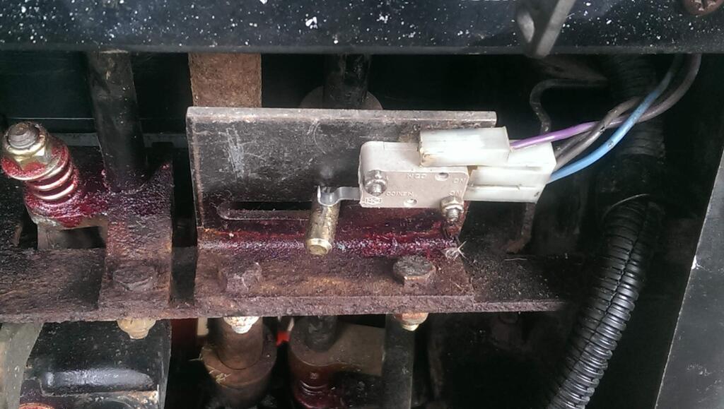

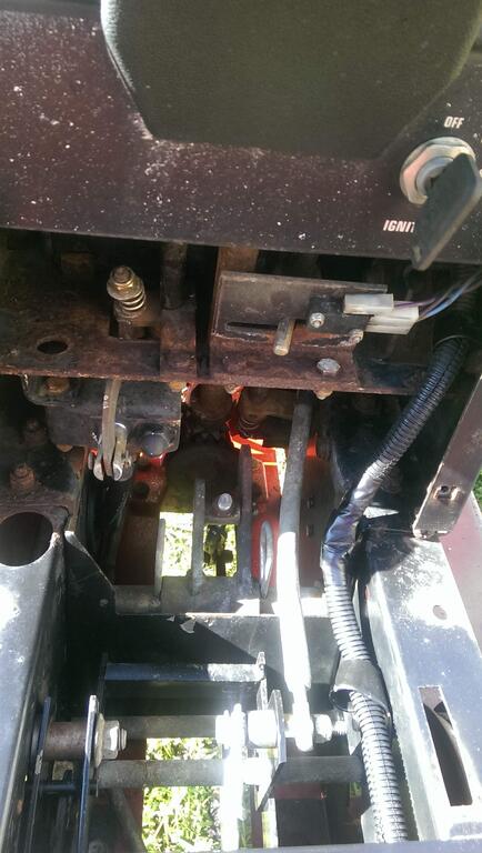

WVHillbilly520H 10,379 #31 Posted December 31, 2020 35 minutes ago, WHX24 said: Distinct possibility ther Dan... So the correct answer to the multiple guess is I don't have a clue. Plugs were showing no sign of spark again so went back to the manual and jumpered bat right to positive on the coil and she fired right off once she cleared all the salts I been dumping down her throat. Previously had bat voltage to the coil in run. Ran like a champ and quickly removed the bat jumper and she continued to stoke with no issue. Warmed up with no issues. Shut her down and she cranked right back up. I says gotta be in a kill relay or the oil pressure cutout??? Maybe ig switch?? So left her set abit and now she won't even fire with a jumper . Ripped my hair out and half the beard and said to heck with it I'm boarding. Jim, the low hour '95 I wrangled a few years back, the neutral safety switch under the steering wheel had the activator lever MIA and PO had jumpered it to get it to run start and run, took me 2 weeks to figure it out (even with the wiring diagrams and the magic test wand,) also it and the '94 I sold, the PTO switch under the fuse box both were severely out of adjustment and would cause an intermittent start/no start...start...sostart...start...something to check out, it could be a sticking/rusty relay under the battery, and yes the blower chute and sway bar make it a PITA to get the hood up to work on the top of the engine. 2 1 Share this post Link to post Share on other sites
WHX?? 57,819 #32 Posted December 31, 2020 (edited) I put Matt's pedal kit on this one so motion lever is gone. Pretty sure when I installed it I just tie wrapped that switch closed. Seat switch is also bypassed but think the PTO one is still active. Will check those out. I had thought if those switches aren't made she won't even crank over ??? More wiring diagram study is in order. Also going to focus on the kill relay that feeds the coil. Possible it is letting voltage but not amps thru? I can hear it click when key to run but that doesn't mean the contacts aren't making? Edited December 31, 2020 by WHX24 1 Share this post Link to post Share on other sites

WVHillbilly520H 10,379 #34 Posted January 1, 2021 6 hours ago, Chestnut said: To answer the comment above, mine don't crank at all if the seat, hydro position, or PTO are in the wrong position. I think I even had an indicator light telling me about a safety switch being off. With the PTO microswitch, the funny thing was one time it would crank just fine the next time NO warning light but wouldn't crank until the engagement lever was wiggled, as far the neutral switch the PO had bypassed with a jumper wire and I wanted it back to original without the extra wires, even while trying to pinpoint the cause with a test light i would accidentally hold the plunger down without realizing the actuator was missing until I pulled the dash panel on my Anniversary 520, its funny how sometimes something so tiny yet in plain site can cause your brain to ache... And I'll be the first to admit it. Share this post Link to post Share on other sites

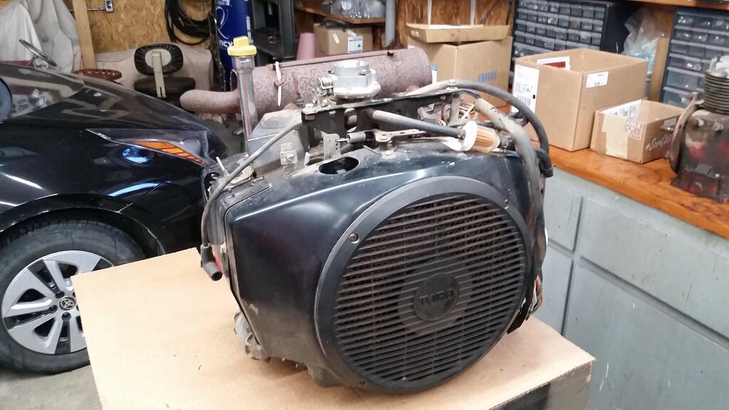

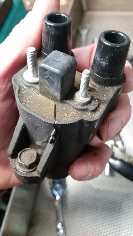

WHX?? 57,819 #40 Posted January 2, 2021 (edited) Think I may have found the culprit.... This is why a guy needs parts motors! Dug this one out of the snow bank hopefully got a good one. Edited January 2, 2021 by WHX24 2 1 1 Share this post Link to post Share on other sites
AMC RULES 37,259 #41 Posted January 2, 2021 Haven't I read there is a cheap Harley part that will fix that problem? 2 Share this post Link to post Share on other sites
WHX?? 57,819 #42 Posted January 2, 2021 Yep all fixed ....bizarre thing is this coil passes resistance tests with flying colors. Probably should have spied that crack from the topside. Looking down in the coil caviity says this girl needs a good cleaning under the tins. Yes Madge a 3 ohm coil off older Harleys will work fine would have to get creative on mounting tho. If I am not mistaking ther was a replacement kit to move the coil out of the hot zone. Maybe @onanparts.com can chime in on this. I know one of my later nineties 520's has the coil mounted differently. The parts motor was always supposed to come in the shop for disassembly anyway and see why she fouled plugs and burned oil. @Achto suggested maybe just a ring job would save it for a complete spare drop in replacement motor. 3 Share this post Link to post Share on other sites
