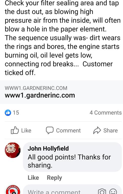

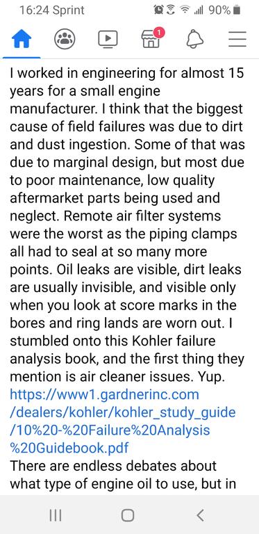

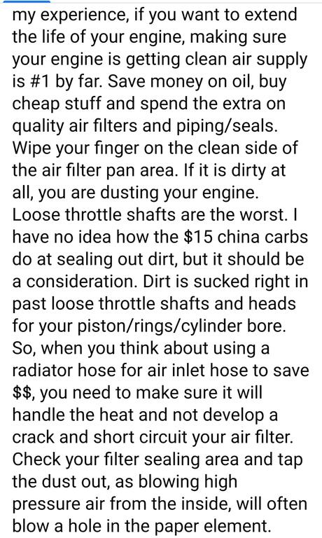

AMC RULES 37,254 #1 Posted December 27, 2020 ...I'm sharing here from one of my FB groups today. 3 4 6 Share this post Link to post Share on other sites
