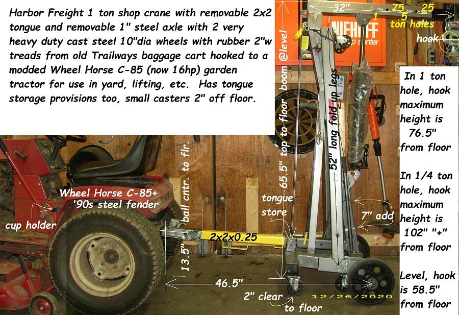

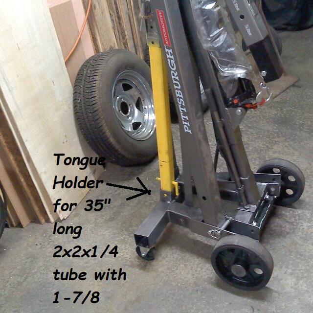

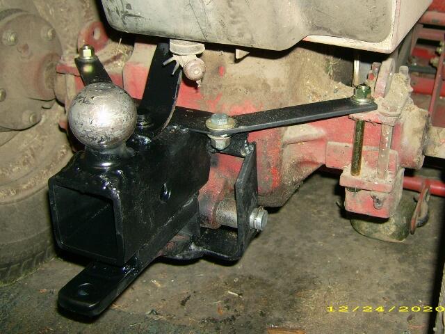

tbear853 58 #1 Posted December 27, 2020 (edited) Back in September I had some trees fall down, some cut, and I had some heavy trunk pieces to move. I got them loaded, but it was a strain. Recently I revised my WH's hitch to include a 6" long 2x2 inside tube receiver and I added a 2" hitch ball on top of it. It's braced well. Looking around on line, I found & ordered a MAXX TOW # 70238 1000 lb hitch secured hydraulic crane to use with my pickups. It is rated 1000, 750, 500 pounds. I made some strengthening additions. I also had a Harbor Freight 1 ton shop crane rated for 1 ton, 3/4 ton, 1/2 ton, & 1/4 ton... I bought on a super saver deal a few years back, but as you know those casters sink in the yard, so I added larger 10" OD x 2" wide rubber tired cast steel wheels on a 1" OD steel axle made from a old used long F-150 drag link, tough steel there. I also added a 2x2x1/4 wall tube tongue to the shop crane that is removable with a pin, receiver is welded into the crane back end. It was cold & wet, here, so since the WH was in the former "trike room" I built to house a trike, I played with my two cranes. The MT hitch crane is intended for F-150 height hitches, the WH's is lower so I'll need to extend or make two longer lower strut braces. The HF crane, I'll make a weight shelf or holder tray to straddle the yellow tongue to help the WH hold it down, plus the two 52" long legs are still there. Either way, I will be able to put 500 pounds in the bed of a truck with no strain on me back I think. In my playing today, I found the WH will handle either at least up to that. Of course, I'd not try to tow a lifted load on the HF crane, but it would be great for pulling straight up, especially if one wrapped a HD chain around the beam close to the hydraulic jack. Monday maybe I start on my next additions, I'm gonna build 2x2 hitch winch mounts. I have a 3500 electric and a 2500 hand wind winch which are unused. Edited December 27, 2020 by tbear853 7 Share this post Link to post Share on other sites
tbear853 58 #2 Posted December 27, 2020 Studying on "needs" above, I have some 1/2" ID, 1" OD steel pipe I can cut to length and drill the 3/8" holes across the ends to make the 19" and 21.5" lower strut braces for the MT hitch crane ... but now I'm thinking of adding a screw feature to them, almost like a turn buckle, where I could adjust them as they are in tension, not compression. As to the HF shop crane, I might look for two pulleys to add on the top boom at either end to the side and build a winch mount that straddles the yellow tongue up close to the silver coupler, with a battery tray that will hold a Grp 65 Ford battery (to use with winch only) ... the weight will help there under load, and run the cable over the pulleys and then I can set the boom angle with the hydraulic ram, but pick the load up with my Badger 2500 lb. electric winch. I likely will not try to use one mount for both, but rather build the winch mount to carry it and the small electric control box, and a separate battery tray / carrier to carry the battery (or batteries like saddle bags?). If I do the mount plate right, I can also use it with a short piece of 2x2x0.25wall tube in my truck's receivers. The extra weight of battery (or batteries) would not be needed with the truck, so that could sit in the bed or not even used? I have two spare Grp 65 batteries in a wooden cart I use for portable 12vdc power, jump start if needed, etc, they were once in cars but I replaced for long trips while still good, I keep them maintained though. One is the OEM MtrCrft battery from our '01 Mercury, but it holds a good charge, green eye stays green, it's never been flat. I replaced it just for piece of mind in 2005 as we were leaving on a few week's summer road trip out west. The other is a newer NAPA Legend 75 given to me by a fellow wanting to replace it just for piece of mind like I did in '05, it too is still good. Together hung over the tongue they would add good amount of counter-balancing weight I think ... to leave the tractor in touch with earth. Still thinking. Just me writing it out, I get ideas ... like separate mounts for winch & battery ... or whether or not to add screw thread adjustment to those lower struts? 1 Share this post Link to post Share on other sites
