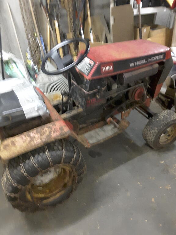

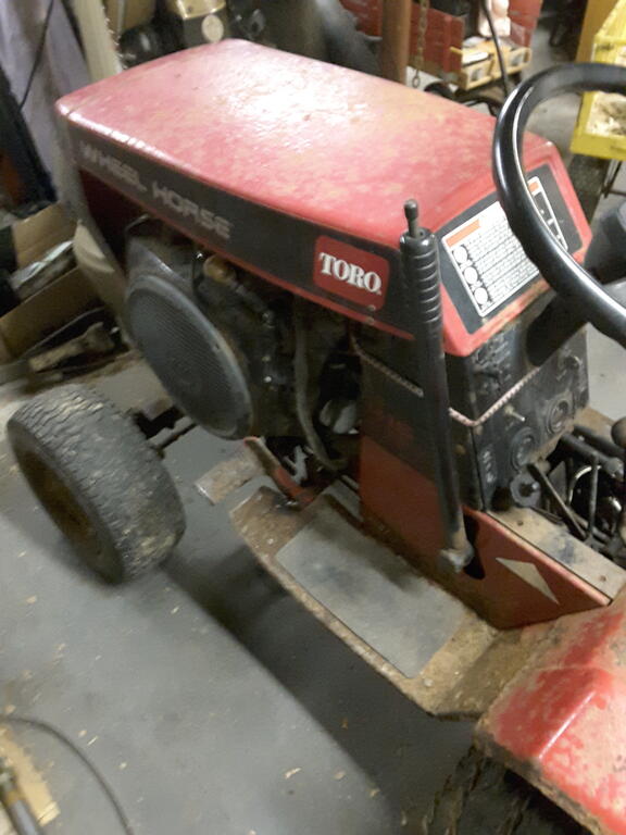

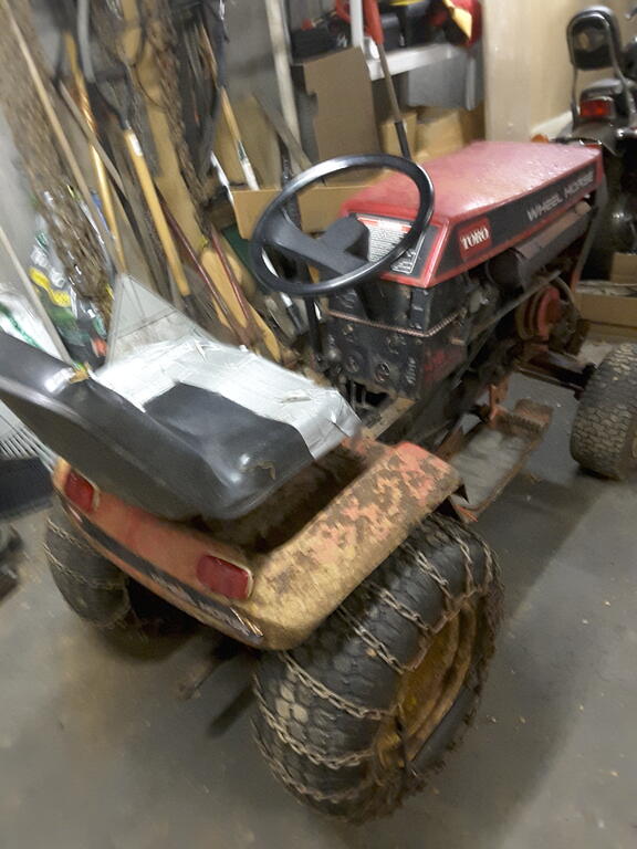

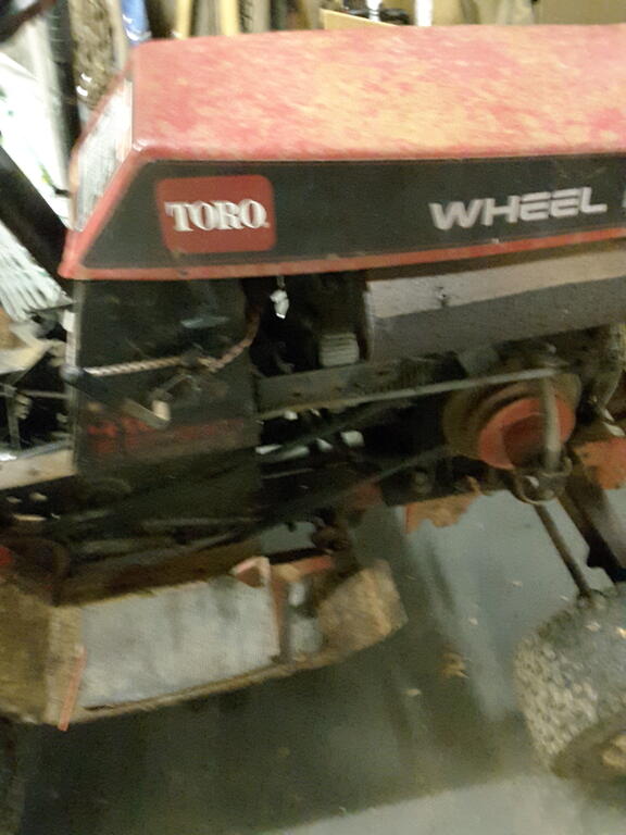

Triton53 13 #14 Posted December 26, 2020 A few photos of my 416-8. 5 2 Share this post Link to post Share on other sites
oliver2-44 11,028 #15 Posted December 26, 2020 I use Rustoleum Regal Red in a spray gun and add Majic brand Enamel hardener from Tractor Supply. Other brand hardeners also work. For new wheelhorse decals checkout Redo You Horse in the Vendors Section. Terrys are top notch. 3 Share this post Link to post Share on other sites
953 nut 62,632 #16 Posted December 27, 2020 5 hours ago, Triton53 said: I am sure that I will have a lot more questions as time goes on. We are here to help, lots of good folks on this site. You will want to strip that Sheetmetal down to bare metal and start with a self-etching primer. We would like to follow your progress. 1 Share this post Link to post Share on other sites
