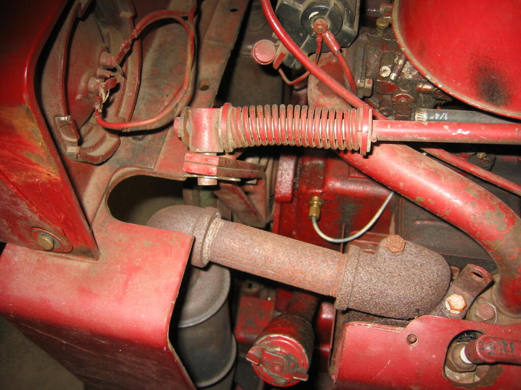

ednixn 1 #1 Posted December 20, 2020 having trouble with wheelhorse 18 auto d-180 pto that wont disengage. Not sure where to start Share this post Link to post Share on other sites

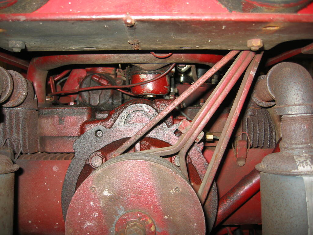

pfrederi 21,312 #2 Posted December 20, 2020 Welcome. When you operate the PTO handle does the rod and spring in pic one make the Triangular piece (second pic ) rock back and forth??? What is hooked up to your PTO.. If there is no load on it some will spin even if disengaged. Share this post Link to post Share on other sites
ednixn 1 #3 Posted December 20, 2020 The rod does go back and forth. I haven't tried it connected to anything yet. I will try this to see what happens. Will let you know if this works. Thank you. 1 Share this post Link to post Share on other sites
pfrederi 21,312 #4 Posted December 20, 2020 There is a brake on the PTO that may need adjusting. You can download this manual. Check out section 9 Share this post Link to post Share on other sites
