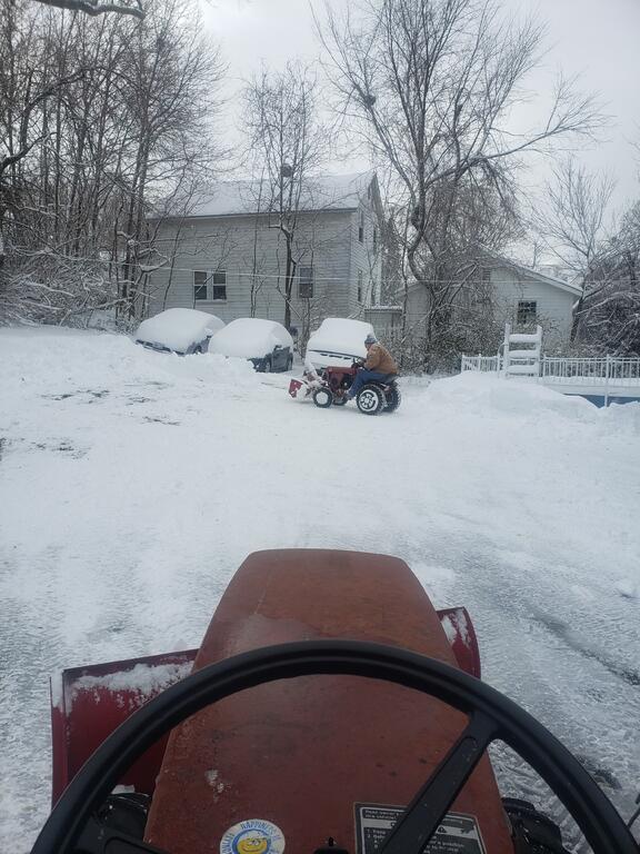

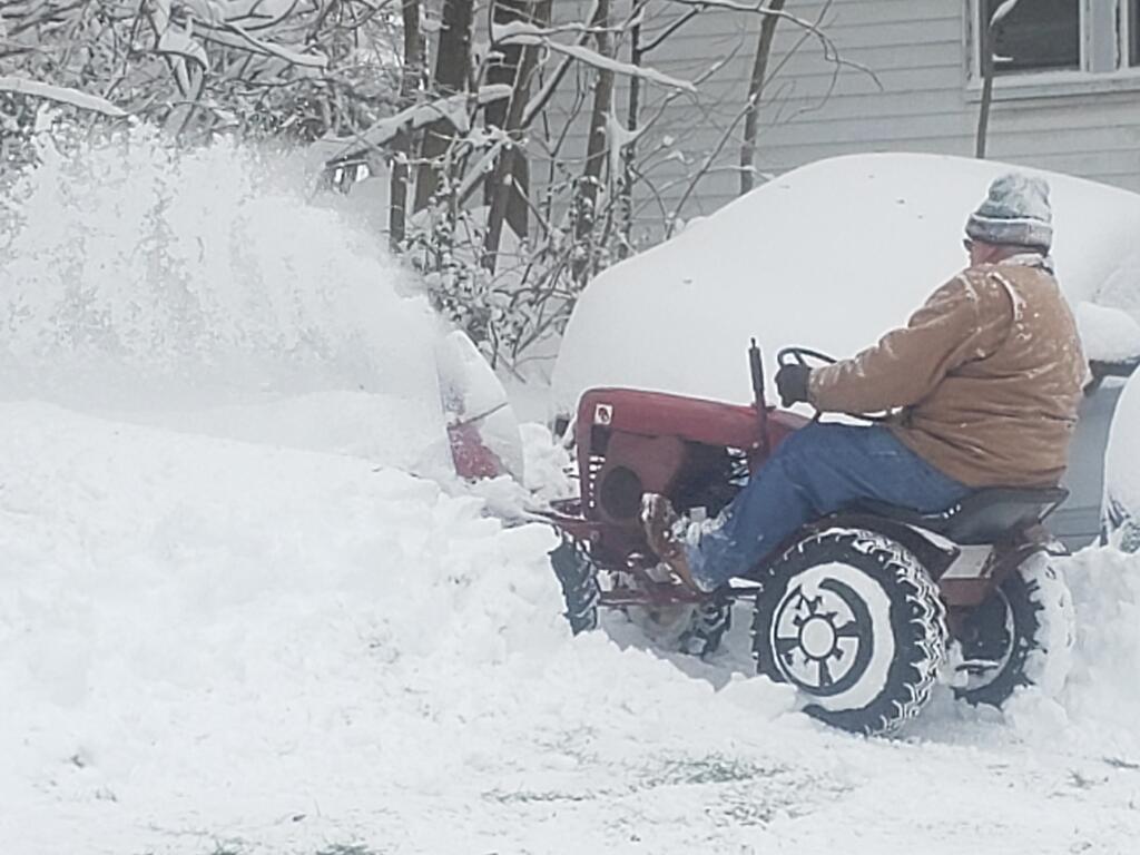

ri702bill 10,814 #1 Posted December 20, 2020 All: I picked up a NOS, never used 1963 32 inch snow blower for the 854 8 speed a couple of years ago. I had the old driveway replace in the spring, as the old one was too crowned to use anything on it for snow removal except my 1972 Ariens Sno thro. Had the time to do some necessary upgrades similar to the 1965 and later Wheel Horse snow blowers - added a second fixed idler sprocket with a new longer chain to improve the wrap on the auger sprocket - lengthened the lower chain guard too. Replaced the non floating drive shaft bearings with floating style and added a plastic "handle" to the chute crank. Replaced the Original WH drive belt with a new TSC Kevlar one. Modified the Lift Flag to work with an assist spring. Overall, it performed well this last storm - traction was a problem as I removed the chains from the 854 and the C81 - will need to chain up before the next storm. Bill 4 6 Share this post Link to post Share on other sites
