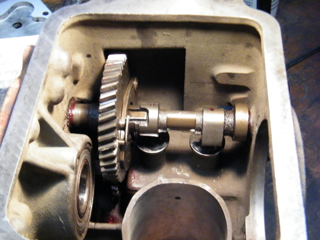

adsm08 3,990 #2 Posted December 19, 2020 (edited) After reading through this article here I think one of my flyweight springs may be off the weight. http://gardentractorpullingtips.com/valvecam.htm I remember briefly seeing the spring as I was spinning the engine by hand to inspect stuff, but not paying much attention to it. After seeing some of these pictures I think it may not have been hooked on correctly. Possibly disturbed while I tried to pull a wad of some sort of fabric or fiber off the spring. I'm still not sure how to tell the difference between a functional ACR and a stuck valve. Edited December 19, 2020 by adsm08 Share this post Link to post Share on other sites
oldredrider 2,553 #3 Posted December 19, 2020 Pull the head off. With the intake valve up, try tapping the exhaust valve down. Roll the engine over and see if the ex valve opens and closes. If it does, a sticking valve is your problem. 3 Share this post Link to post Share on other sites
stevasaurus 23,534 #4 Posted December 19, 2020 I think the 2 piece cam is for the K-161. The spring with the single cam is made to open the exhaust valve a little to relieve compression when either cranking the starter or pulling the starter rope. Once the engine starts, the ACR does nothing and you have full compression. If you have the head off and you turn the engine over, you should see the exhaust valve hang open a "little" on the compression stroke. Once you have RPM's, the spring does not keep the exhaust valve open any more. If your spring is broke, then you do not have ACR...your engine will still start and run...just harder to pull or crank. If you had a 65 hsp outboard, you may feel the difference. Actually, I think that 2 piece cam shaft used a different system...prior to ACR. Are you sure you do not have a 7hsp Kohler?? 1 Share this post Link to post Share on other sites
adsm08 3,990 #5 Posted December 19, 2020 13 minutes ago, stevasaurus said: I think the 2 piece cam is for the K-161. The spring with the single cam is made to open the exhaust valve a little to relieve compression when either cranking the starter or pulling the starter rope. Once the engine starts, the ACR does nothing and you have full compression. If you have the head off and you turn the engine over, you should see the exhaust valve hang open a "little" on the compression stroke. Once you have RPM's, the spring does not keep the exhaust valve open any more. If your spring is broke, then you do not have ACR...your engine will still start and run...just harder to pull or crank. If you had a 65 hsp outboard, you may feel the difference. Actually, I think that 2 piece cam shaft used a different system...prior to ACR. Are you sure you do not have a 7hsp Kohler?? I'm sure it isn't a 7 hp. The early K181s used an ignition retard system that operated similar to the ACR system but it adjusted the ignition timing to fire it off at or just after TDC. Both the engines have the info tags intact enough for me to be able to read the engine designation as K181S. I really didn't want to have to pull this head too. I know it isn't hard, I just didn't want to do it. 1 Share this post Link to post Share on other sites
pfrederi 19,498 #6 Posted December 20, 2020 You can watch the exhaust valve in the valve spring chamber. As Steveauraus said you will see it bump up a bit during the compression stroke if your ACR is working Share this post Link to post Share on other sites
adsm08 3,990 #7 Posted December 20, 2020 1 hour ago, pfrederi said: You can watch the exhaust valve in the valve spring chamber. As Steveauraus said you will see it bump up a bit during the compression stroke if your ACR is working Then there is no doubt the valve is stuck open. I held a light to the exhaust port and hit the starter. The valve never closed. Share this post Link to post Share on other sites
oilwell1415 563 #8 Posted December 20, 2020 The valve is stuck open. Even if the ACR failed completely the valve would still open and close normally, the ACR just retards the cam at low rpm to ease cranking. 2 Share this post Link to post Share on other sites
adsm08 3,990 #9 Posted December 20, 2020 Yup. The valve was stuck. I suspect that the last time the engine was run, or cranked it stopped with the valve open and then stayed that way for many years. I worked it around by hand a few times with the head off, and it stayed up each time. Then I gave it a good shot of PB into the exhaust port and worked it by hand twice more. Valve is now moving freely. Fortunately I already had a head gasket for this thing on my shelf, so I'll get the head and block cleaned tonight, bring my torque wrench home from work tomorrow, and hopefully in 24 hours I'll have a running tractor again. I was also able to get the spark issue sorted out. Turns out the points were not in good shape, again probably from sitting. I installed the points from the engine that blew up since they were replaced this summer. I'll kind of got a little redneck engineering into setting them since I can't find my feeler gauges. I figure the average thickness of a piece of paper is .0039". The setting on the points is .018-.022". .020/.0039=5.12. That means 5 pieces of paper stuck in there should get you close enough to run. I'll bring my good feelers home from work tomorrow and set them properly before trying to start it, but I think that would have worked well enough in a pinch. Share this post Link to post Share on other sites
