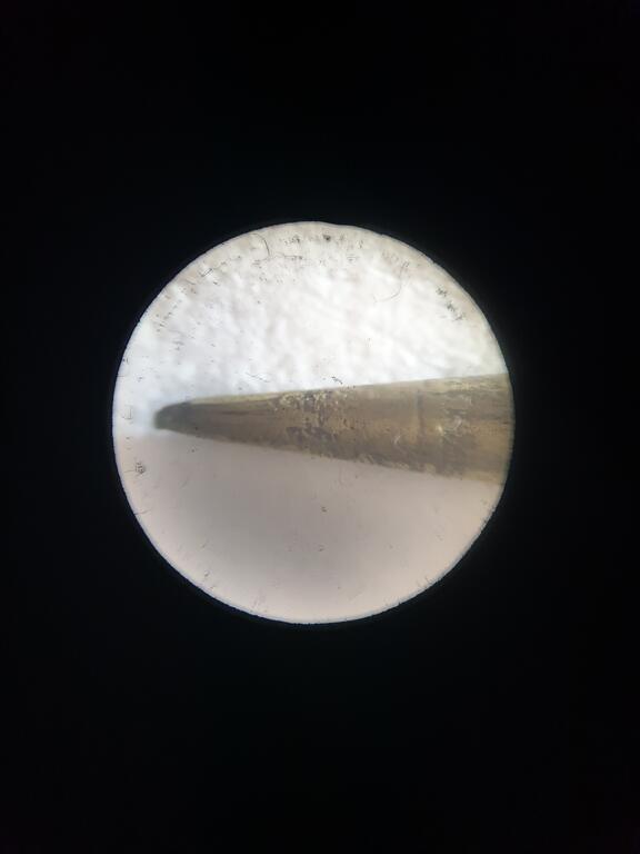

Mickwhitt 5,257 #1 Posted December 18, 2020 Hi guys. In the quest to get my little red Fred running smooth I'd like to check the carb is set properly. I know the method of setting the fast and idle jets in theory. Can someone walk me through the process? Mainly how much rotation of the jets is required to take them from rich to.lean. the manual looks like its nothing more than a quarter turn. My fast jet seems to take quite a bit of turning to go from rich to lean. The tip of the needle is quite worn, bent and corroded, would that have a bearing on the running? Exhaust seems sooty to me but that could be because of the rings too I guess. Any help welcome. Mick 1 Share this post Link to post Share on other sites
stevasaurus 23,617 #2 Posted December 18, 2020 That tip does look pretty worn and could be an issue. As you know, you bottom out those screws and back them out what the book says for your engine and carb. Adjustment after that...do the side screw first and it should only be like 1/4 turn either way. Listen for the engine to run smooth. Next do the top screw and do the same thing. Make sure your points are set correctly...that can make more of a difference in how that horse runs. 4 Share this post Link to post Share on other sites

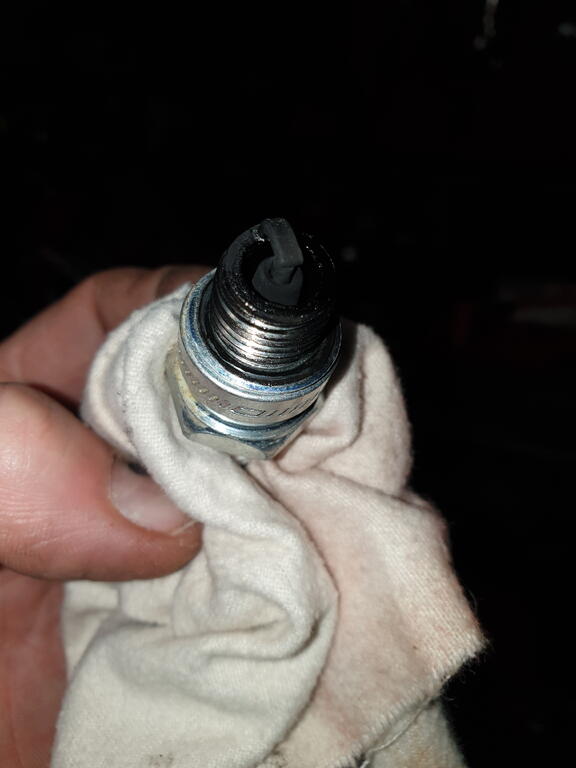

Mickwhitt 5,257 #11 Posted December 20, 2020 I fitted a new plug and tooled up and down the drive for a while. The plug looks like this now... Any thoughts on it? Looks oIled a little. adjusting the fast running jet is really difficult, probably because its worn. I'm trying to source a new jet, but I have seen the bottom adjusting conversion by Brian Miller, anyone know of it and if it is a worthwhile kit to consider. Mick Share this post Link to post Share on other sites
Maxwell-8 4,370 #12 Posted December 20, 2020 (edited) For sure rich and oily. You notice any engine oil consumption? Edited December 20, 2020 by Maxwell-8 Share this post Link to post Share on other sites
Mickwhitt 5,257 #13 Posted December 20, 2020 Its not smoking and I will monitor the oil closely now its running more reliably. When I rebuilt the engine I didnt replace rings etc. The bore looked fine and measured pretty even which is why I just rebuilt. Not sure I could find a small engine shop who could take on boring and rebuilding the engine if its needed. But I will tackle that problem if it comes up. Mick Share this post Link to post Share on other sites

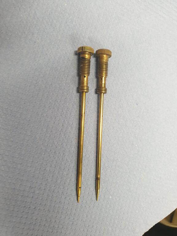

Mickwhitt 5,257 #18 Posted January 1, 2021 Well I managed to find a number 30 carb off as K321 i believe. It was pretty much scrap as it had been in a river, but the inside of the carb was fine. The high speed needle is similar to the one on my carb but the cross holes are different. The tip of this needle is in way way better shape than mine so i want to use it. Im going to measure and drill the holes to exactly match my needle. That way I should get the same thing only better. With luck this newer needle will allow me to adjust the high speed mixture a little better, we will see. Mick 2 Share this post Link to post Share on other sites
wallfish 19,323 #19 Posted January 1, 2021 I would just try it first before modifying the holes. maybe just a small adjustment will be enough to equal the different hole sizes. A little too late for the suggestion and never tried it, but what about using lapping compound to mate the surfaces of the needle and seat? Would that brass be too soft to work? Or maybe the compound would leave too deep of scratches? Share this post Link to post Share on other sites
Mickwhitt 5,257 #20 Posted January 1, 2021 The needle part number on mine is correct for the model of carb so the hole number and positions should be correct. That is confirmed by reading up on the pulling tractor site. So drilling a few 1/32 holes will be easy. I was going to try it before I modify it but that seems unnecessary as too small a hole means it woukd not idle. Mick Share this post Link to post Share on other sites
lynnmor 8,628 #21 Posted January 1, 2021 1 hour ago, Mickwhitt said: The needle part number on mine is correct for the model of carb so the hole number and positions should be correct. That is confirmed by reading up on the pulling tractor site. So drilling a few 1/32 holes will be easy. I was going to try it before I modify it but that seems unnecessary as too small a hole means it woukd not idle. Mick Don't you have a idle mixture screw to adjust? The idle circuit is not affected greatly by the high speed screw. My concern would be the condition of the hole where the point of the high speed screw meters the flow. With the finish being knackered on the point might not be a big problem since you adjust the flow anyway. Often folks jam the screws in and damage the mating surface. I really think you have more going on than the condition of the high speed screw end. Share this post Link to post Share on other sites
Mickwhitt 5,257 #22 Posted January 1, 2021 Well I fitted the needle without drilling it. The engine runs fine and it is so obvious that I can now adjust the fast running mixture accurately compared to the previous worn and damage needle. Obviously I have not run it under load so that may well expose any problems with this new needle. If im reading it right, fuel is allowed out of the float chamber via the emulsion tube through the gap made by the tapered needle. The fuel then enters the small hole at the bottom of the needle and up to the top where it goes to the slow running jet, entering the air inlet after the throttle butterfly. At higher throttle speeds the fuel is pulled out of the central holes in the needle and straight into the venturi. Mick 1 1 Share this post Link to post Share on other sites

Mickwhitt 5,257 #25 Posted January 2, 2021 I tried Fred this morning and he ran a bit lumpy at high speed, so obviously not enough fuel due to there being only two holes in the needle. So I drilled two new holes 25 thou diameter and opened up the lower hole to 1/32nd as advised on pulling tractor site. Immediately the difference was clear. Ticking over smoothly and instant response to opening the throttle. I can adjust the fast jet too as I said so it seems I've made a big step forward. Next job is to make a new tapered tip from brass for the damaged needle and graft it on to see if I can rescue it. 2 Share this post Link to post Share on other sites
