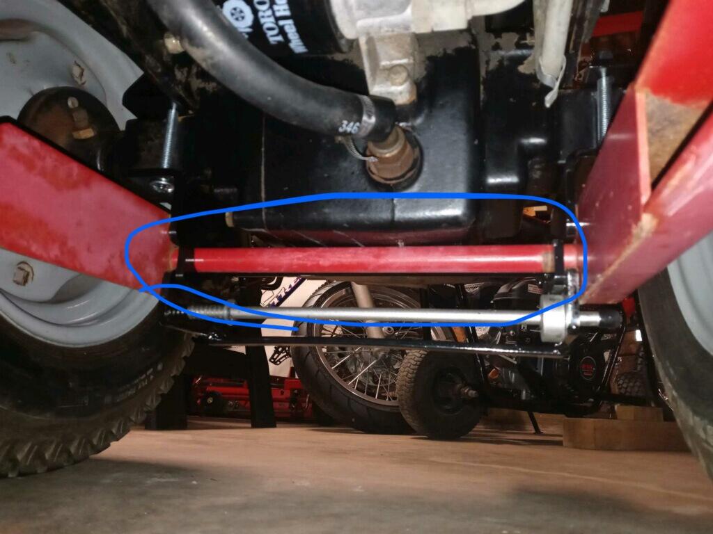

bizzo15 52 #1 Posted December 16, 2020 Hey Guys, Trying to help a buddy out who is a fellow Wheel Horse 5xi owner. He bought a reproduction rear attach matic so he could run run a snow plow and he’s concerned with the clearance between the attach matic and the transmission housing. Can someone who has the factory rear attach matic tell me if the cross bar is supposed to be touching the bottom of the housing like in the pic? Share this post Link to post Share on other sites
JoeM 9,323 #2 Posted December 17, 2020 I have not installed my plow on the xi as of yet but I have the measurement from an OE one for the bracket I built. That looks like it will not hurt anything that housing if pretty tough. It appears to just touch. I am guessing the bar slid right in place. 1 Share this post Link to post Share on other sites

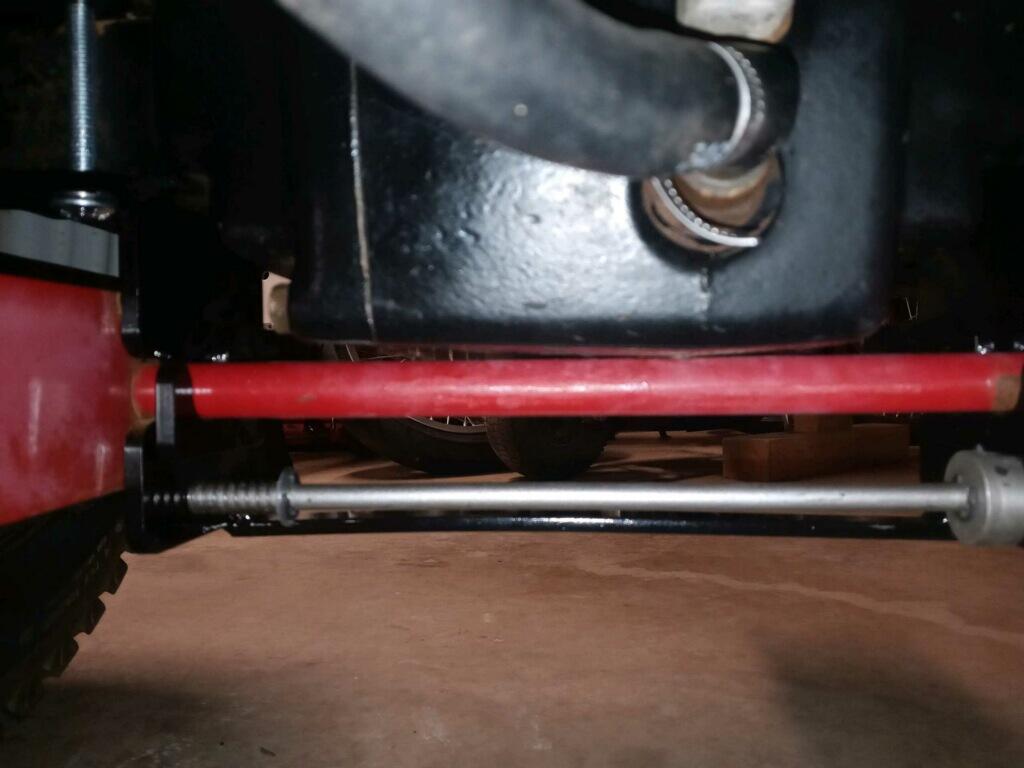

bizzo15 52 #3 Posted December 17, 2020 He said he had to tap it on with a block of wood. Here’s a better pic that he just sent. Share this post Link to post Share on other sites
moe1965 766 #4 Posted December 17, 2020 Just a thought could you put a spacer under the two mounts that the tachomatic bolts to under the axle and give you another 1/4 in clearance 5 1 1 Share this post Link to post Share on other sites
Pullstart 68,534 #5 Posted December 17, 2020 Yep, I’d get some 1/4” or 1/8” even plate and build some shims. A couple holes in each one will keep it from coming apart. 4 Share this post Link to post Share on other sites
JoeM 9,323 #6 Posted December 17, 2020 yep a shim between axle and bracket will clear that up, shame those are pretty pricey. I would let the person who made it know there is a problem so others don't have the same issue. x 1/4 x 1-1/2 or 2 wide would work. Hole spacing is 2 5/8 on center. Providing the 3/8 mounting bolts have enough thread. 2 Share this post Link to post Share on other sites
peter lena 9,563 #7 Posted December 17, 2020 MOE 1965, good call on that ! simple / easy space off on mount area ,will retain mount strength , yet add the important spacing needed in that area . that looks like a " how can I make this better ? " situation . pete 1 Share this post Link to post Share on other sites
cschannuth 3,819 #8 Posted December 17, 2020 Plus, if I’m looking at that right it will lower the rear of the blade frame a quarter of an inch and that will give you that much additional height/lift on the blade itself or more. 2 Share this post Link to post Share on other sites
bizzo15 52 #9 Posted December 17, 2020 Thanks for all the replies. That was his thought as well to shim it. Just stinks that you buy something and immediately have to make a modification. I guess that’s what happens when you can’t find OEM anymore. Share this post Link to post Share on other sites
JoeM 9,323 #10 Posted December 19, 2020 @bizzo15 Put my plow on the xi today and it touched the housing. It did slide right in place easily. I am going to grind a hair on the top of the bar when it is off the next time. There is only a small area of concern. 1 Share this post Link to post Share on other sites
bizzo15 52 #11 Posted December 22, 2020 On 12/19/2020 at 4:06 PM, JoeM said: @bizzo15 Put my plow on the xi today and it touched the housing. It did slide right in place easily. I am going to grind a hair on the top of the bar when it is off the next time. There is only a small area of concern. Glad to hear it Joe, my friend decided to shim his so there's clearance. Share this post Link to post Share on other sites
