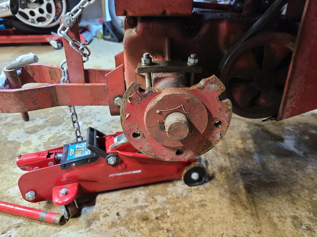

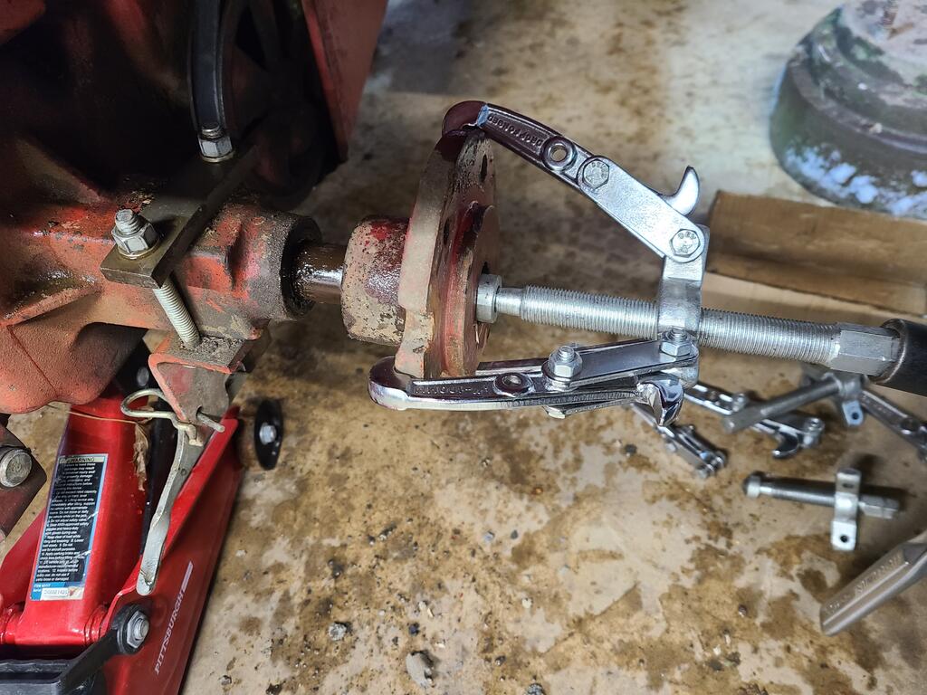

ArturHawk 195 #1 Posted December 16, 2020 Hi guys! I was out snow blowing today (snow still coming down) and I realized my AG tires don't have the traction I need. I decided to swap rims with my lawn turf tires so I can run chains. When the tire came off, I was faced with this. It was a little difficult to get off, so I grabbed my jaw puller and everything came off pretty OK. It's time to put the new hub on, but I'm curious how far it's supposed to go on. The axle has a little movement in and out. The left side has the hub against the transmission case and doesn't have any in/out motion. I figured the hub is supposed to go against the case to help prevent in/out motion, but a quick search seems to suggest the hubs need to be flush with the end of the axle. Is this true? Any help is appreciated so I can get back to snowthrowing. Thanks! Share this post Link to post Share on other sites

ebinmaine 77,006 #3 Posted December 16, 2020 22 minutes ago, Ed Kennell said: Mine are all flush with the axle. Agreed. I never run them "against" the transmission. That's a point of contact for grinding away material. On 3/4 speeds I back them out just enough to clear the hub from the transmission housing. As a side note ..... The 3 jaw puller can cause breakage of the hubs when removing them. It's best to use an old hub as the pulling mechanism. 4 Share this post Link to post Share on other sites

ArturHawk 195 #7 Posted December 17, 2020 Thanks for the follow up guys. I also checked my Raider 10 and the hubs were flush with the axles as well. 3 hours ago, ebinmaine said: Agreed. I never run them "against" the transmission. That's a point of contact for grinding away material. On 3/4 speeds I back them out just enough to clear the hub from the transmission housing. As a side note ..... The 3 jaw puller can cause breakage of the hubs when removing them. It's best to use an old hub as the pulling mechanism. The first hub was already busted, so I figured no harm. I did use it to pull my other (good) hub out to be flush with the axle per your advice. I only had one spare hub, so I didn't want to break my other one.. Also, this is an 8spd, I don't know if that makes any difference. 2 hours ago, WHX24 said: I stuff a nylon washer in back of the hubs for a wearable thrust washer ala 520's but don't know if it really needs it but can't hurt. check the play in that axle as well.... leaky seal might mean bad bearing. When you say check for play, do you mean up/down? It seemed pretty solid, but I don't know what would be considered "good." It seems my in/out play is less than 1/8" which seems to be good. How hard is it to replace the seals? My garage isn't heated, so I'll do it now if it's not bad, otherwise I'll wait till spring. Back up and throwing snow thanks to you guys! 1 4 Share this post Link to post Share on other sites

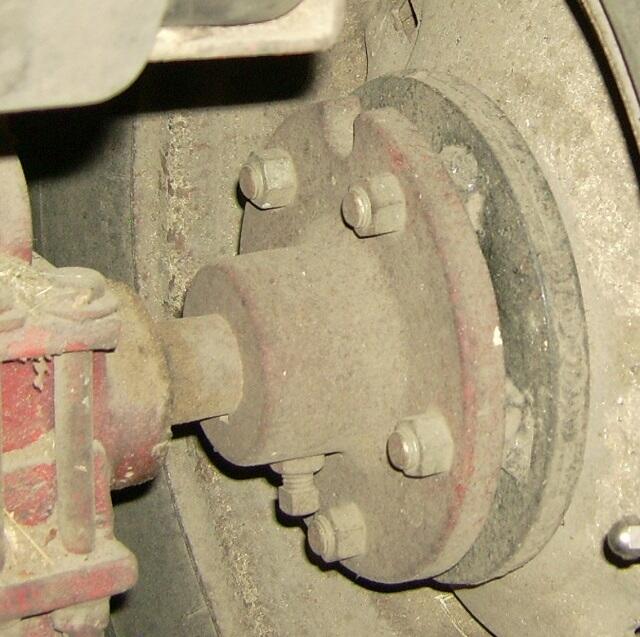

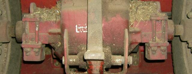

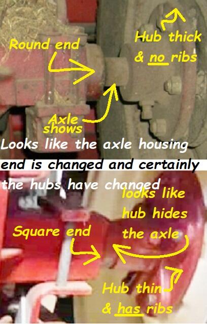

tbear853 58 #15 Posted December 19, 2020 (edited) Sitting & browsing before we go look at lights, noticed in some pics the HUB differences. My old WH had the thinner hub with the thick ribs where the bolts threaded in, it had 5 lug hubs. This pic of the one I have now clearly shows the axles is thicker with no ribs, and it looks like the transaxle housing differs too. As I recall, the axles are 1-1/8" dia, mine are exposed for about 1". I knew the hubs differed, but I never took note of housing ends or whether the axles showed on the old one like they do this current C tractor. I was wondering why some said the hub was next to the housing but others went with axle ends flush. Maybe it's the extra metal in the earlier hubs maybe due to smaller axles? Just guessing, thought I'd learn a difference? I wonder which had 8 pinion differentials now. Edited December 20, 2020 by tbear853 Share this post Link to post Share on other sites
ebinmaine 77,006 #16 Posted December 19, 2020 17 minutes ago, tbear853 said: Just guessing, thought I'd learn a difference Here's the way I understand it: All (?) 3 and 4 speeds have the shorter axle shafts which puts the hub next to the transmission housing. All 6 and 8 speeds have a longer axle shaft which leaves the inch or so of space you see between the husband transmission case. The axle diameter should be 1-1/8" on most 6 or 8 speeds. 1" on most (all??) 3 or 4 speeds. 8 pinion 8 speeds were used from around 1971 up in Raider, C series and most 400, 500 series. Some 300 series had an 8 that used thinner axles and I don't know the diff type. The thinner "5 star" hubs were used from the early 60s to around 77 or 78, give or take. 1 Share this post Link to post Share on other sites
tbear853 58 #17 Posted December 20, 2020 3 hours ago, ebinmaine said: Here's the way I understand it: All (?) 3 and 4 speeds have the shorter axle shafts which puts the hub next to the transmission housing. All 6 and 8 speeds have a longer axle shaft which leaves the inch or so of space you see between the husband transmission case. The axle diameter should be 1-1/8" on most 6 or 8 speeds. 1" on most (all??) 3 or 4 speeds. It is, I measured them, and one is a hair over 1" exposed, the other right at an inch exposed. 3 hours ago, ebinmaine said: 8 pinion 8 speeds were used from around 1971 up in Raider, C series and most 400, 500 series. Some 300 series had an 8 that used thinner axles and I don't know the diff type. The thinner "5 star" hubs were used from the early 60s to around 77 or 78, give or take. OK, Thank you, I wondered about that. Mine is a C-85, 1981 I think, maybe '82? 1 Share this post Link to post Share on other sites
