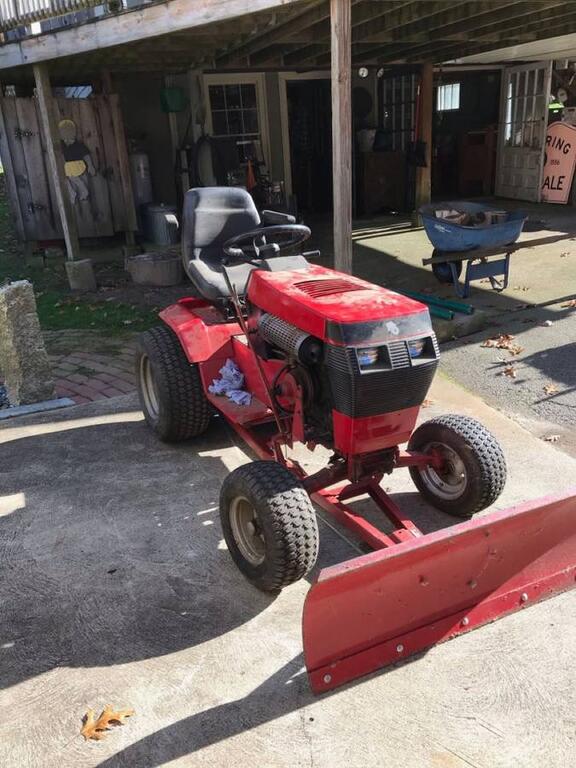

Raposo 532 #9 Posted December 15, 2020 The machine was painted over and it looks like the plates were removed. No sure on serial number unfortunately. It’s got toro black decals. Here’s a pic Share this post Link to post Share on other sites
gwest_ca-(File Mod) 11,840 #10 Posted December 15, 2020 Black decals are 1990 and newer. 1990 1991-1997 Garry Share this post Link to post Share on other sites

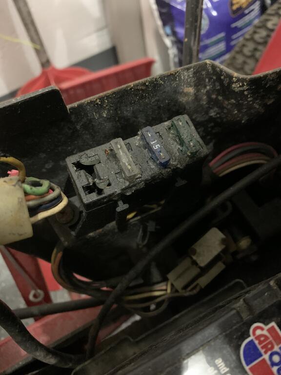

Jeff-C175 7,207 #12 Posted December 15, 2020 Looks like an awful lot of crud on that fuse block. I'd start by cleaning that up. I bet there's corrosion on the terminals. Based on the look of that fuse block my guess is that you're gonna find more corroded connections. 2 Share this post Link to post Share on other sites
953 nut 62,988 #13 Posted December 15, 2020 Any wiring connection near the battery is subject to more corrosion due to battery acid fumes over the years. If you don't clean and tighten ALL electrical connectors you will be plagued with electrical problems until you do it right. 4 Share this post Link to post Share on other sites
lynnmor 8,238 #14 Posted December 15, 2020 Your fuse block should be populated front to back as follows: Empty, 15 AMP, 25 AMP, 30 AMP. Not saying this is the problem, but it will be after a heavy electrical load. Let us know what you are testing and the results. 1 Share this post Link to post Share on other sites
