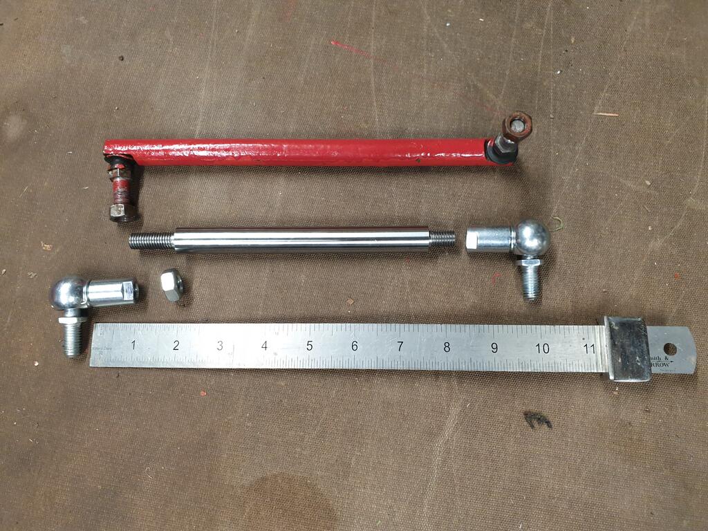

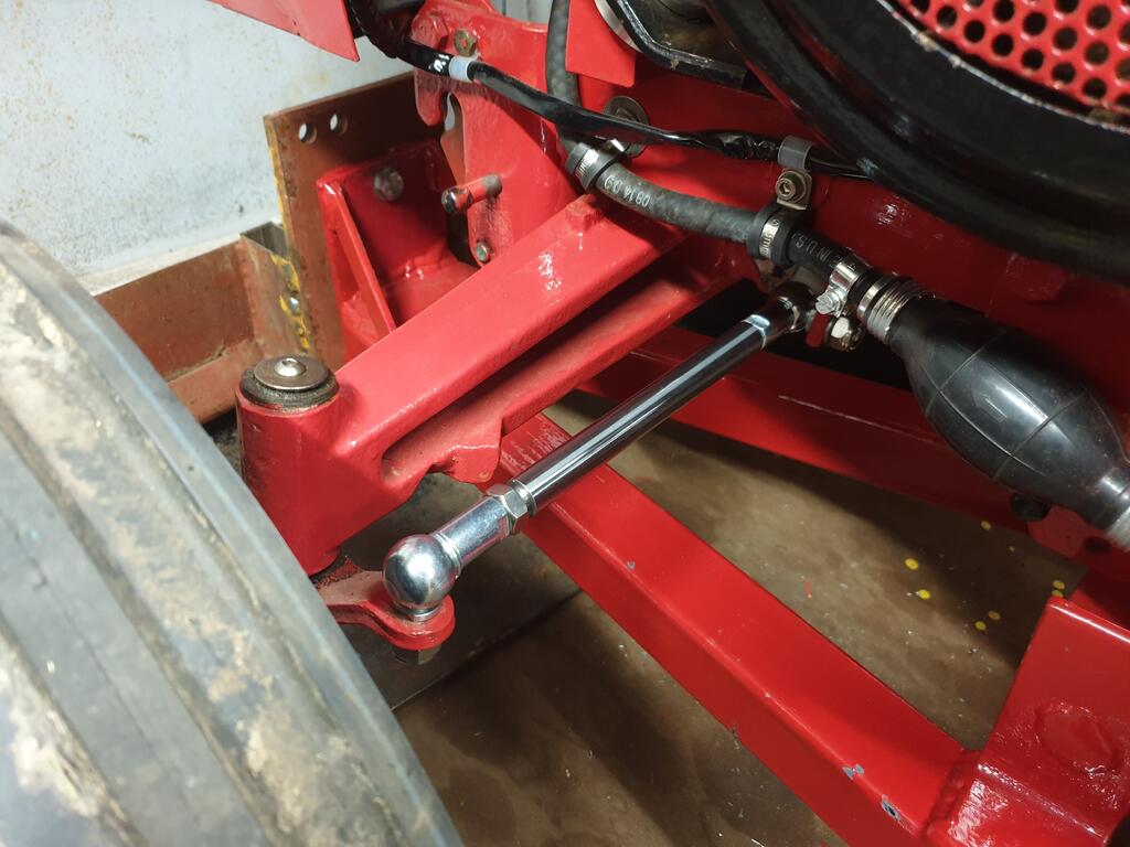

Mickwhitt 5,187 #13 Posted December 15, 2020 Just bought a set of rod ends to replace the worn steering track rods on Fred. The original rods are fixed length so no way to adjust steering angle. I have a length of hard chromed steel bar used in hydraulic pistons which I will turn down and thread to tak the rod ends. It won't rust and should look good. 2 Share this post Link to post Share on other sites

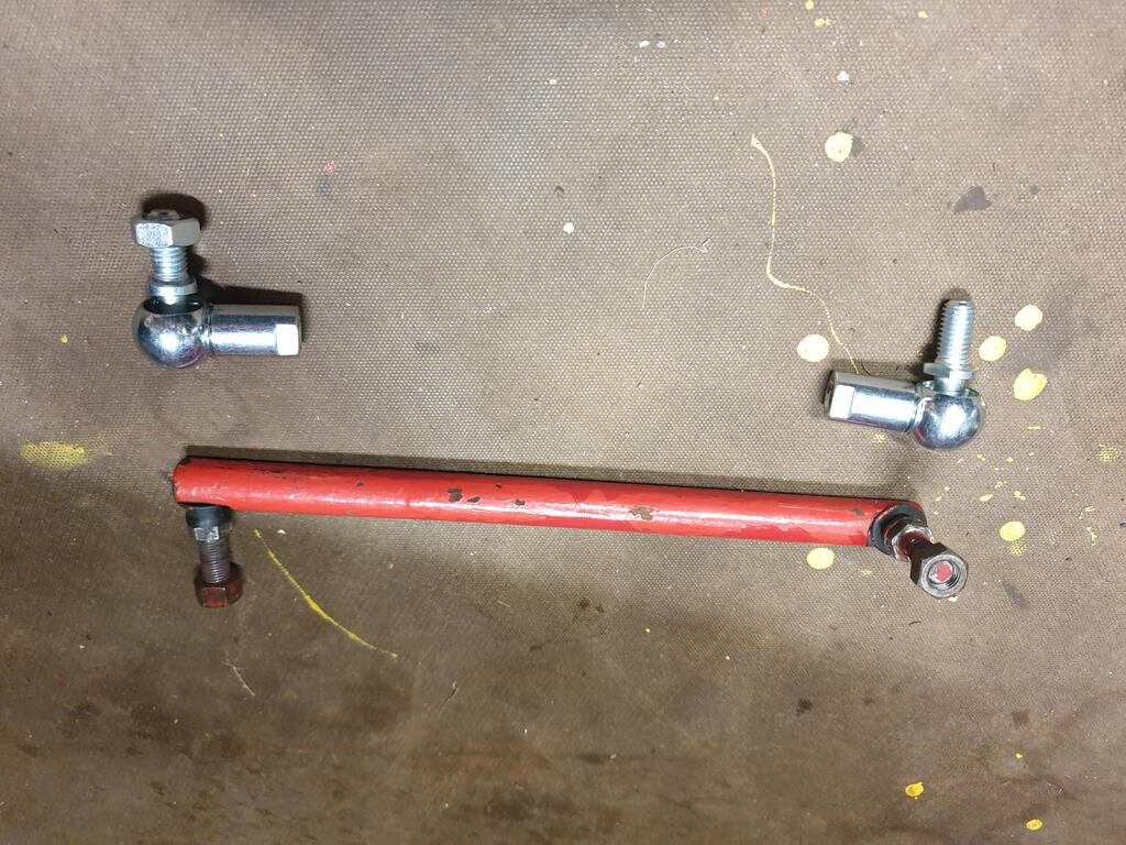

Achto 29,674 #17 Posted December 16, 2020 6 hours ago, Mickwhitt said: The original rods are fixed length so no way to adjust steering angle. I have a length of hard chromed steel bar used in hydraulic pistons which I will turn down and thread to tak the rod ends. It won't rust and should look good. I like the hard chrome steel idea !! I cut the ball joints off from the stock tie rods, then turn the ends down so that they can be threaded to accept the new ball ends. This way the original patina can even be kept if you wish. 5 Share this post Link to post Share on other sites

Handy Don 14,493 #19 Posted December 16, 2020 47 minutes ago, Achto said: I like the hard chrome steel idea !! I cut the ball joints off from the stock tie rods, then turn the ends down so that they can be threaded to accept the new ball ends. This way the original patina can even be kept if you wish. Extremely clever, @Achto. Way to preserve and still get new function. 2 1 Share this post Link to post Share on other sites

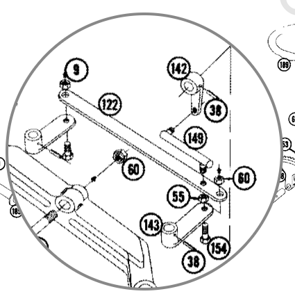

71_Bronco 1,072 #21 Posted December 16, 2020 On my Commando 8, my stock set-up has the front of the tires slightly wider than the rear of the tires. Not sure if that was done for a reason, or if they are just worn (have a set of the adjustable tie rods from @76c12091520h I need to put on). On my '62 Lawn Ranger, is has the fixed bar connecting the spindles, with the drag link between the steering and the fixed bar. Those wheels also have a wider space in the front than the rear of the tires. 1 Share this post Link to post Share on other sites

Mickwhitt 5,187 #23 Posted December 16, 2020 My guess is that because fixed length track rods were fitted there is no need to adjust them from the dimension set by the factory. True that toe in or out affects cornering but not in this low speed application not noticeable. The castor angle is the determining factor in the wheels self centring but this is set by the axle geometry and is not adjustable as is the king pin inclination. Blimey this is dredging up memories from college when I did my vehicle engineering qualifications nearly 40 years ago. I will be checking the Ackerman angles next lol Looks like it has power steering now with the chrome push rods. 3 1 Share this post Link to post Share on other sites
Mickwhitt 5,187 #24 Posted December 16, 2020 One other thing to consider is that if you want to make your track rods adjustable you need to have a left hand thread on one end of each track rod. Otherwise the length will not increase by turning the rod. With a setup having both right hand threads you can only change the length of the track rod by thread pitch per rotation of the ball joint. If that makes sense? Mick 4 Share this post Link to post Share on other sites
ebinmaine 74,162 #25 Posted December 16, 2020 15 minutes ago, Mickwhitt said: One other thing to consider is that if you want to make your track rods adjustable you need to have a left hand thread on one end of each track rod. Otherwise the length will not increase by turning the rod. With a setup having both right hand threads you can only change the length of the track rod by thread pitch per rotation of the ball joint. If that makes sense? Mick I made the mistake of buying four right hand ends when I built mine so I had to remove them and turn them in/out a turn to adjust the length. Perfectly fine in my case because our ground is so rough it doesn't exactly matter. 1 1 Share this post Link to post Share on other sites
