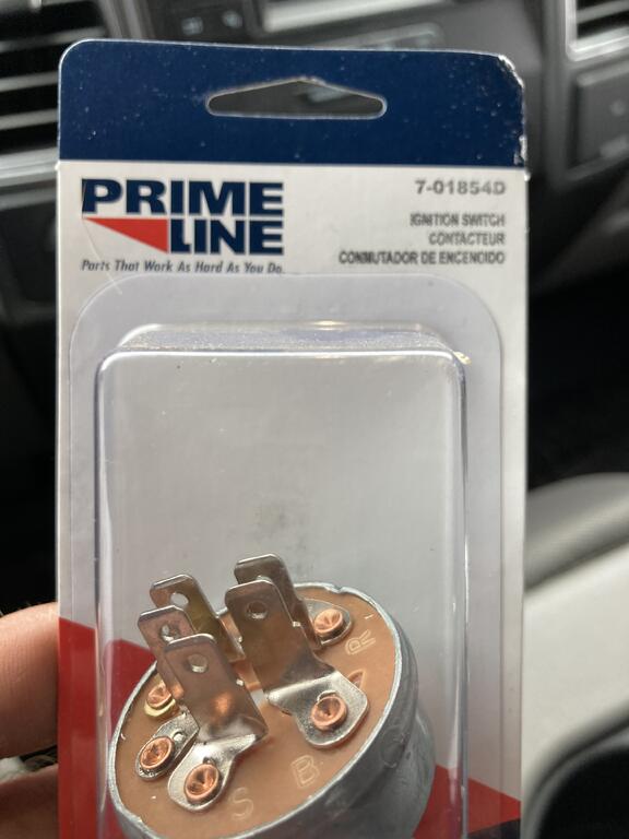

Tuneup 1,459 #76 Posted March 6, 2021 (edited) Found it in a Red Square post: NAPA 701892 Edited March 6, 2021 by Tuneup Share this post Link to post Share on other sites
WH08205 15 #77 Posted March 6, 2021 NAPA part number Share this post Link to post Share on other sites

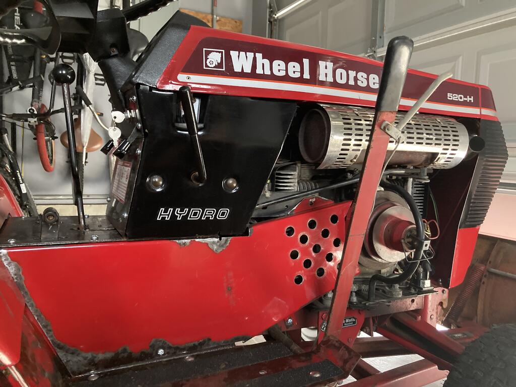

peter lena 10,011 #82 Posted March 6, 2021 WH08205, good pick up on that , and your future maintenance plans, agree with adding an additional vent area to your belt guard , at rear engine cylinder , been using PREFORATED STEEL SHEETING FOR A LOT OF TRACTOR ATTATCHMENTS , https://www.google.com/search?sxsrf=ALeKk016e90yLfBwsAzBu68jetm7gbshBA%3A1615058554250&ei=etZDYOrFDsKa_Qbx6q_QAg&q=perforated+steel+home+depot&oq=perforated+steel%2C+home&gs_lcp=Cgdnd3Mtd2l6EAEYADICCAAyBggAEBYQHjIGCAAQFhAeMgYIABAWEB46BwgjELADECc6BwgAELADEEM6DQguEMcBEK8BELADEEM6BAgAEEM6BwgAEMkDEENQreUBWO_1AWDLpQJoAXACeACAAZABiAG6BZIBAzYuMZgBAKABAaoBB2d3cy13aXrIAQrAAQE&sclient=gws-wiz EASY TO CUT WITH TIN SNIPS , HOME DEPOT HAS IT , or related store , buy a 1 ft piece , cut out your bolt in piece , for belt guard , instant engine cooling ,improvement , pete Share this post Link to post Share on other sites
WH08205 15 #83 Posted March 6, 2021 3 minutes ago, peter lena said: WH08205, good pick up on that , and your future maintenance plans, agree with adding an additional vent area to your belt guard , at rear engine cylinder , been using PREFORATED STEEL SHEETING FOR A LOT OF TRACTOR ATTATCHMENTS , https://www.google.com/search?sxsrf=ALeKk016e90yLfBwsAzBu68jetm7gbshBA%3A1615058554250&ei=etZDYOrFDsKa_Qbx6q_QAg&q=perforated+steel+home+depot&oq=perforated+steel%2C+home&gs_lcp=Cgdnd3Mtd2l6EAEYADICCAAyBggAEBYQHjIGCAAQFhAeMgYIABAWEB46BwgjELADECc6BwgAELADEEM6DQguEMcBEK8BELADEEM6BAgAEEM6BwgAEMkDEENQreUBWO_1AWDLpQJoAXACeACAAZABiAG6BZIBAzYuMZgBAKABAaoBB2d3cy13aXrIAQrAAQE&sclient=gws-wiz EASY TO CUT WITH TIN SNIPS , HOME DEPOT HAS IT , or related store , buy a 1 ft piece , cut out your bolt in piece , for belt guard , instant engine cooling ,improvement , pete Thanks, Pete. Ended up doing a series of 3/4” holes in a set pattern. 1 Share this post Link to post Share on other sites
peter lena 10,011 #84 Posted March 6, 2021 WH08205, that will work too , keep it cool , pete Share this post Link to post Share on other sites
