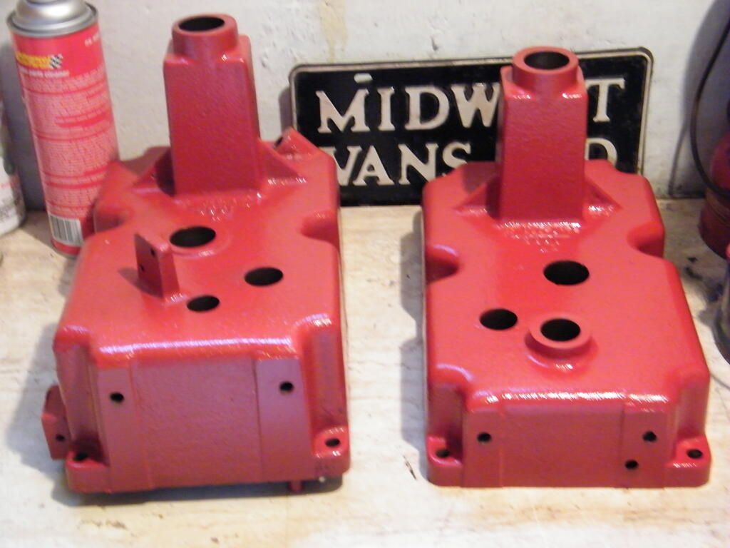

Terry M-(Moderator) 2,267 #3 Posted December 14, 2020 I notice a casting difference in the 5025's compared to the others... Share this post Link to post Share on other sites
Crmaverick 91 #4 Posted December 14, 2020 1 hour ago, Terry M said: I notice a casting difference in the 5025's compared to the others... What difference is that? Is there a casting of the transmission model number on the case somewhere? Share this post Link to post Share on other sites

Terry M-(Moderator) 2,267 #6 Posted December 14, 2020 11 hours ago, Crmaverick said: What difference is that? Is there a casting of the transmission model number on the case somewhere? It’s just a cosmetic difference near the rear axle bearing area is. If all my stuff wasn’t stored for the winter I’d take a pic for you. 1 Share this post Link to post Share on other sites

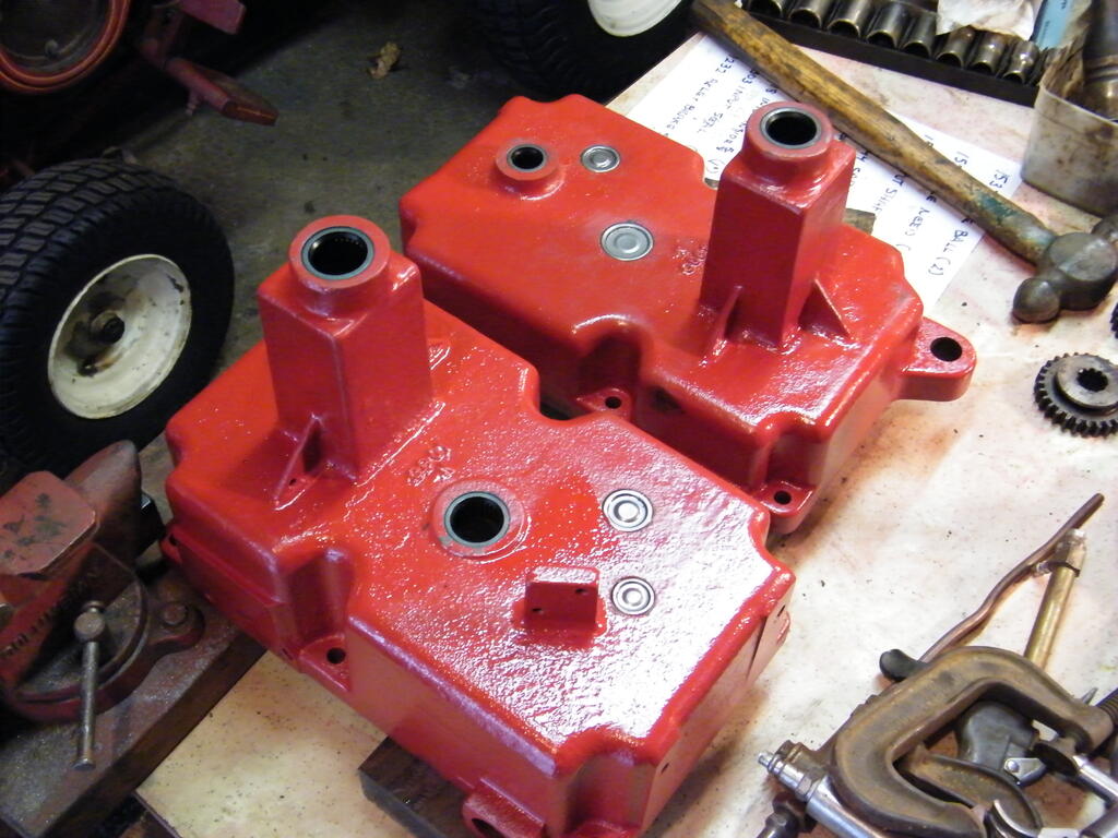

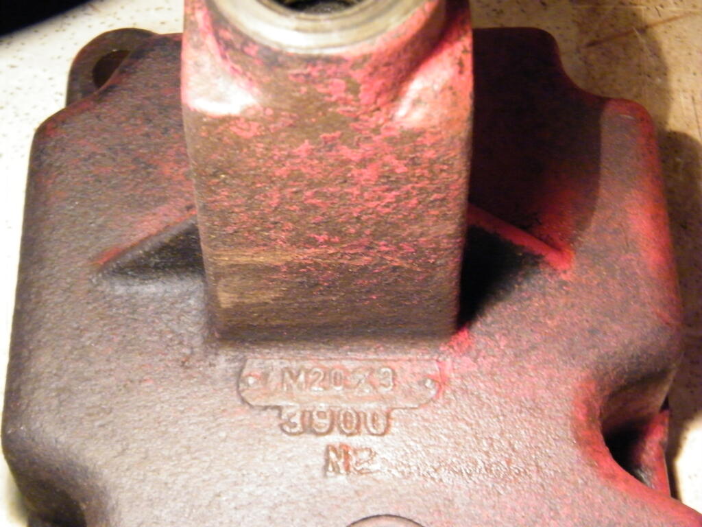

stevasaurus 23,506 #8 Posted December 14, 2020 All of the 3 speed uni-drive transmissions have the same gears and parts...5007,5025, 5046, 5048, 5049, and 5053. The only real difference is the shift rails got a flat side to them to solve the suction problem (which put the trans into 2 gears at the same time). Non of the gears are beefier and the pinions are all 2 piece. I've taken apart a 5007, and a 5025 and I did not see anything different...maybe a different size drain plug or fill plug then the later transmissions in this group?? The 5046, I believe, is the one that first had the flat side shift rails. The 5048 is for Lawn Rangers...the difference...maybe axle length?? Any difference between the 5049 and the 5053...if anything, it is not worth finding out. The 5053 became the replacement transmission for all of the above transmissions. Maybe the difference is the 5053 did not come with the shifter, boot, dog point set screw, lock nut and knob...the 5049 did. There is a part number cast into both sides of the case halves. The right side is #3900...the left side is #3901. You can see the 3900 in the above RH casting. The case halves are the same part numbers for all of the above transmissions. #5007 case halves #5046 #5025 My question is...How do you know it is a #5049?? Did the guy tell you what horse it came out of?? That is really the only way to know. Share this post Link to post Share on other sites
