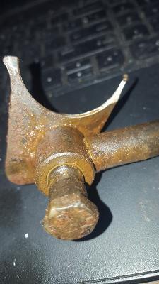

Brewer229 4 #35 Posted December 29, 2020 Hello, well I guess this was the culprit it wasnt even in the groove on the gear.. so where is the best or cheapest to get this shift for assembly? Thanks! 1 Share this post Link to post Share on other sites
stevasaurus 23,620 #36 Posted December 29, 2020 If you looked in my video, I show and tell all about it. Use that video to put it back together. You can get that part from TORO...and you want a new one...don't get a used one. They were about $56. That bolt gets torqued when replaced. With all the mud in there, you will want to open and clean out your differential also. Did you take everything apart.?? 2 Share this post Link to post Share on other sites
Brewer229 4 #37 Posted December 29, 2020 2 hours ago, stevasaurus said: If you looked in my video, I show and tell all about it. Use that video to put it back together. You can get that part from TORO...and you want a new one...don't get a used one. They were about $56. That bolt gets torqued when replaced. With all the mud in there, you will want to open and clean out your differential also. Did you take everything apart.?? Not yet I just made it to that high low shift fork and have stopped for now..I will get back to it after i know this fork is on its way to me. Thanks! Share this post Link to post Share on other sites
stevasaurus 23,620 #38 Posted December 29, 2020 TORO has it...scrape the black paint off to get an accurate torque. Diesel works great to cut the sludge and then a wire wheel on a drill or 4" grinder and you are good to go. Share this post Link to post Share on other sites

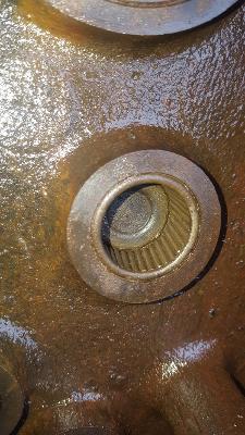

Brewer229 4 #39 Posted December 30, 2020 Ok I noticed some needle bearings has fallen out of that one gear thats rides on the high low fork should i replace those and is it difficult or to they just pop out? They shouldnt be falling out of that casing should they? Thanks! Share this post Link to post Share on other sites
Brewer229 4 #40 Posted December 30, 2020 Also these other needle bearing in the case dont even move plus there not straight up and down so when i buy these do I knock them out from the outside or the inside? Share this post Link to post Share on other sites

stevasaurus 23,620 #43 Posted February 20, 2021 Did you clean out the transmission before and replace those bad bearings?? Yes, you have to drain it out, but if you cleaned it out before, I think I would flush with 2 qts of diesel, drain it and put the 90wt 1 1/2 to 2 qts back in. The boot is only a few $...put a touch of grease on the shifter about where the boot goes to seal that water. Sorry, I missed some of your questions from before. I'll be watching this thread now. Share this post Link to post Share on other sites
