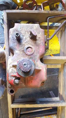

Brewer229 4 #23 Posted December 28, 2020 (edited) Hello, Yes it just crawls along, So I decided to pull it apart ,any info or anything I should be aware of that might give me trouble taking this casing apart? Ive already had a wrench fall off where my hub pullie was at and break the dam plastic dip tube..great!..smh. Thanks Guys! Edited December 28, 2020 by Brewer229 Share this post Link to post Share on other sites
Brewer229 4 #24 Posted December 28, 2020 On 12/23/2020 at 1:29 PM, stevasaurus said: It should feel like you are sliding a gear on a shaft...from one gear to another. Let us know what happens and if the horse moves, do you think you are in hi or low. You will know if you are in low. It is like just crawling along. I watched the vid were there one of you taking it apart..I just seen a couple of you working on the inside of it. 1 Share this post Link to post Share on other sites
Maxwell-8 4,370 #25 Posted December 28, 2020 14 minutes ago, Brewer229 said: Hello, Yes it just crawls along, So I decided to pull it apart ,any info or anything I should be aware of that might give me trouble taking this casing apart? Ive already had a wrench fall off where my hub pullie was at and break the dam plastic dip tube..great!..smh. Thanks Guys! When you are in there, clean everything really well, makes sure the bearing oil passages are clean. I grease up the selectors Good luck 1 Share this post Link to post Share on other sites
