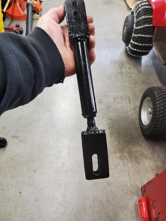

69mach 10 #3 Posted December 12, 2020 5 minutes ago, cafoose said: I do here is one of the links from a thread I posted: Awesome. Thanks. I've owned my for 10 years & always ran it on my 312-8. Just put on my 520 this evening & can't seem to get the lift bar or arm correct. It actually will lift the front tires off the ground. Can't get it to float is I guess what I'm trying to say. Share this post Link to post Share on other sites

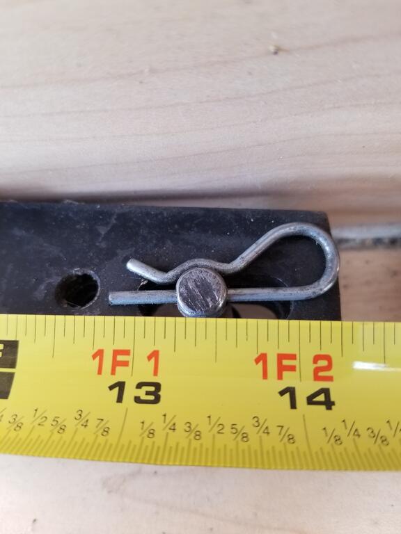

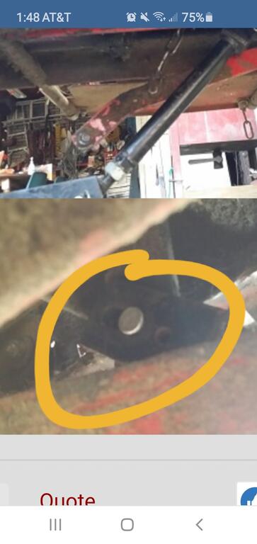

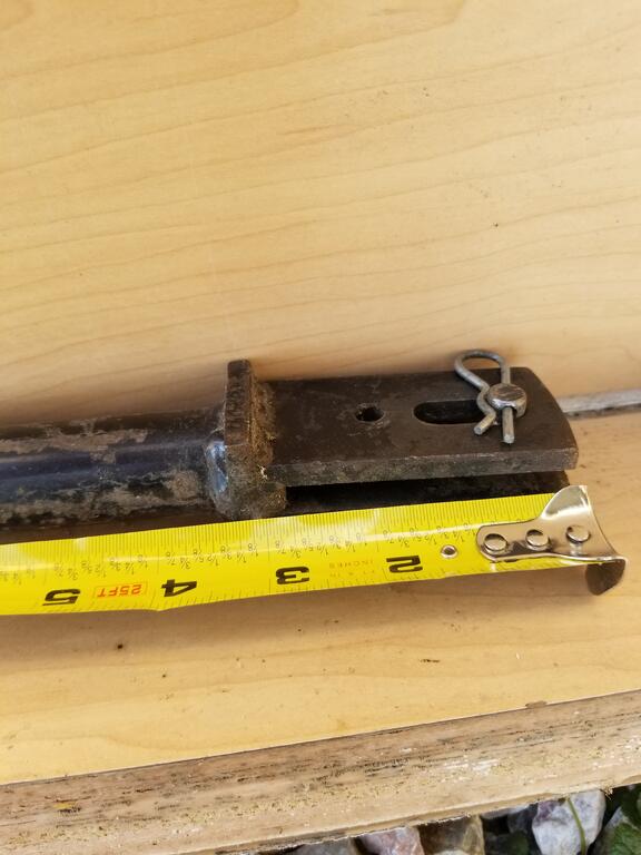

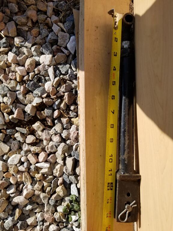

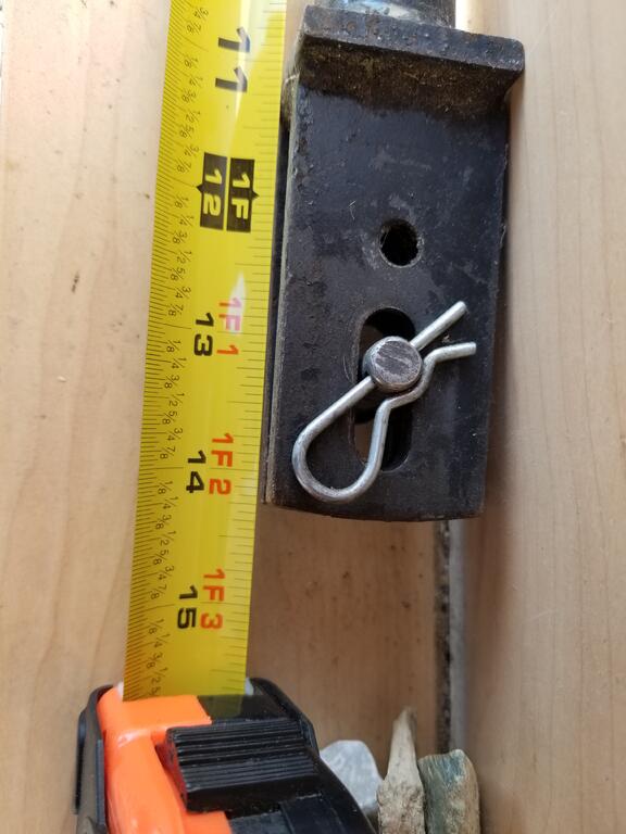

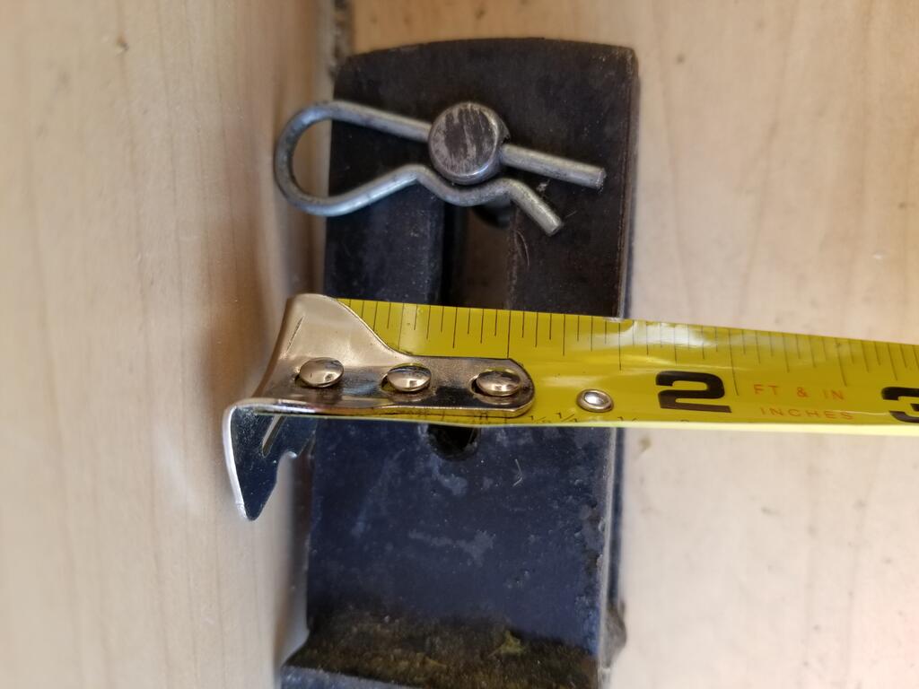

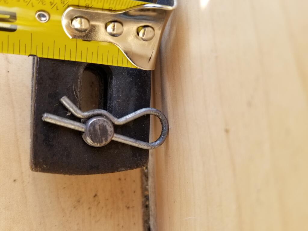

69mach 10 #7 Posted December 12, 2020 15 hours ago, cafoose said: Read through my threads on it and let me know if you have any specific questions: Cafoose I think my problem is no slot in the lift arm that I made 10 years ago. Can you possibly measure that slot for me that is in your picture here? Also what whole are you in on Jack shaft, upper or lower? Share this post Link to post Share on other sites

cafoose 3,635 #9 Posted December 13, 2020 23 hours ago, 69mach said: Cafoose I think my problem is no slot in the lift arm that I made 10 years ago. Can you possibly measure that slot for me that is in your picture here? Also what whole are you in on Jack shaft, upper or lower? Don't remember which hole it's been awhile since I hooked it up. I think I just used the closest hole that lined up. 1 Share this post Link to post Share on other sites
69mach 10 #10 Posted December 13, 2020 Cafoose- Perfect. Plenty of travel now. 1 Share this post Link to post Share on other sites
