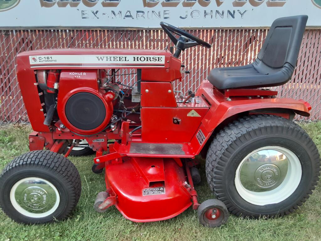

WHX?? 53,081 #2 Posted December 10, 2020 First off your wife got any sisters who like little red tractors? I wouldn't worry about the hydro thing too much on the sole fact there are fellas here that can walk you through any problems you might have. It is a bit risky when the tractor doesn't run and you can't check the tranny but if the price is right. Parts are out here yet as well as complete working hydros. Good luck and keep us posted. 7 1 Share this post Link to post Share on other sites

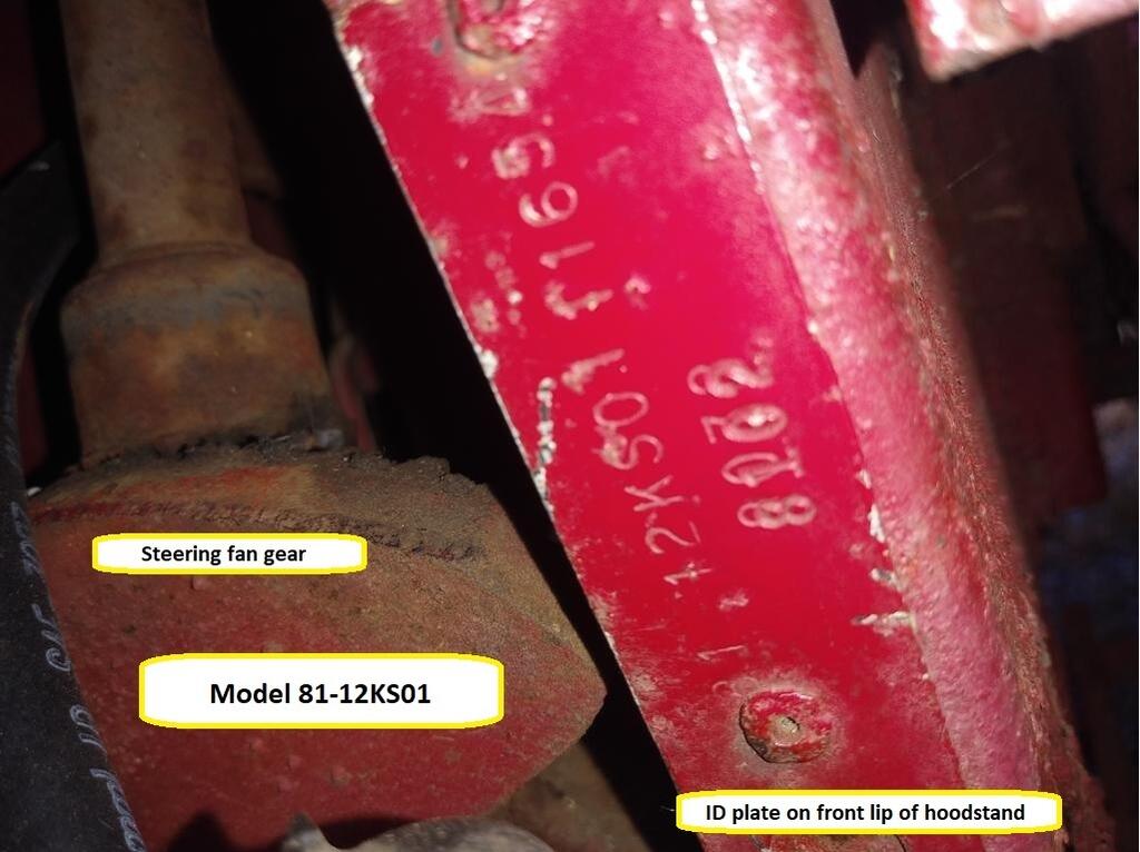

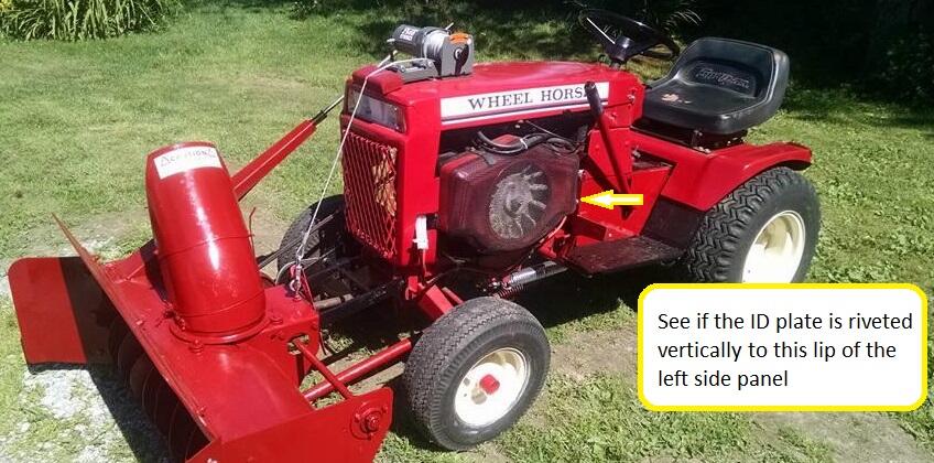

gwest_ca-(File Mod) 11,786 #3 Posted December 11, 2020 The ID plate should be up tight to the bottom of the dash housing or Your second picture may show the plate vertical with 2 screws holding it on. 1 1 Share this post Link to post Share on other sites
briankd 833 #4 Posted December 11, 2020 (edited) 21 minutes ago, WHX24 said: First off your wife got any sisters who like little red tractors? I wouldn't worry about the hydro thing too much on the sole fact there are fellas here that can walk you through any problems you might have. It is a bit risky when the tractor doesn't run and you can't check the tranny but if the price is right. Parts are out here yet as well as complete working hydros. Good luck and keep us posted. my wife says the charger 10 ugly she says it has that dumb lever hanging off the side i said that is what operates the pto clutch . the charger 10 has a techy in it that made me shy away from it . this c121 i can get for 200 bucks maybe another 50 would get the hydro Edited December 11, 2020 by briankd 1 Share this post Link to post Share on other sites

WHX?? 53,081 #6 Posted December 11, 2020 (edited) You musta missed that thread with the nice C-161 with a eight speed Brian.... and only a state away for you! I'm prolly gonna have one of those male dreams about that one tonite! What can I say ...bucket list tractor! Edited December 11, 2020 by WHX24 1 3 Share this post Link to post Share on other sites
