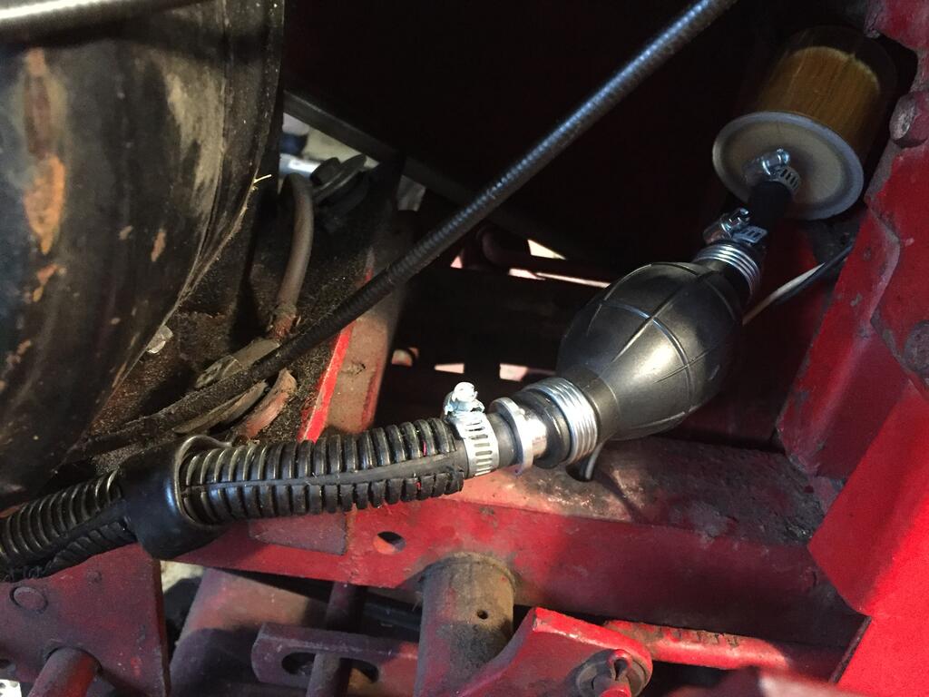

Tony in Australia 2 15 #1 Posted December 10, 2020 My two wheelhourse's have the same issue, after sitting for 2 or more weeks without being started both take forever to get the fuel back up to the carby to get them started. My guess is that the fuel is darining back to the tank. Is there a anti drain back valve in the system? One engine is the Magnum 12hp Kohler and the other is Power Plus 16 Onan. Both run great when used very regulaly. Any Ideas? 2 Share this post Link to post Share on other sites
wallfish 18,623 #2 Posted December 10, 2020 That's a common issue A 12v electric fuel pump or one of these should solve the problem https://www.ebay.com/itm/New-Fuel-Line-Pump-Primer-Bulb-Hand-Primer-Gas-Petrol-Pump-Rubber-Aluminum-Sales/373229524942?_trkparms=aid%3D777001%26algo%3DDISCO.FEED%26ao%3D1%26asc%3D20160801204525%26meid%3Dcb9f1da1c6ef4ed49a923ef27838631e%26pid%3D100651%26rk%3D1%26rkt%3D1%26mehot%3Dnone%26itm%3D373229524942%26pmt%3D0%26noa%3D1%26pg%3D2380057%26algv%3DPersonalizedTopicsRefactor%26brand%3D&_trksid=p2380057.c100651.m4497&_trkparms=pageci%3Acafa3447-3b41-11eb-b2d0-2ef43906d994|parentrq%3A4f0ba8c01760a9c98cd5a284fffdf0c4|iid%3A3 3 2 Share this post Link to post Share on other sites
Tony in Australia 2 15 #3 Posted December 11, 2020 What a great idea, would never of thought of a in line boat fuel pump. How simple. Thanks heaps Wallfish 2 Share this post Link to post Share on other sites
oliver2-44 10,972 #4 Posted December 11, 2020 Both of your horses have the gas tank under the seat. With that design there’s not much or any gravity flow on the suction side of the diagram style fuel pump. There have been some threads about putting check valves and I let those folks speak about that. The other common option is too install an electric fuel pump In place of the mechanical diaphragm pump. I have a “Facet brand 1-2psi pump on my C-81 and A 313-8 The Facetvpump cost more than the Chinese brands but it will last. 3 1 Share this post Link to post Share on other sites
Tony in Australia 2 15 #5 Posted December 11, 2020 Thanks mate, I will see what I can find down this way. There are no issues once they are running. I think I will try a small in-line hand fuel pump like what's on an outboard motor first, if that fails I can step up to an ele pump. I am trying to keep these two are original as possible. Cheers Tony 2 Share this post Link to post Share on other sites
SylvanLakeWH 29,275 #6 Posted December 11, 2020 Put an in line bulb on mine couple years back - no issues since! Works like a charm!!! 2 Share this post Link to post Share on other sites
Tony in Australia 2 15 #7 Posted December 11, 2020 What a great idea, would never of thought of a in line boat fuel pump. How simple. Thanks heaps Wallfish 2 Share this post Link to post Share on other sites
953 nut 62,065 #8 Posted December 11, 2020 1 hour ago, Tony in Australia 2 said: Is there a anti drain back valve in the system? The fuel pump on each model has a couple of check valves but over time they fail. When you install the fuel primer bulb or an electric fuel pump be sure it is located below the fuel tank. 2 Share this post Link to post Share on other sites
Tony in Australia 2 15 #9 Posted December 11, 2020 That's what I will do bug I might try to put mine under the seat close to the tank and tuck it up out of the way, if that doesn't work I try under the battery area as you have done. I will try and get some pictures uploaded soon, cheers very one for the help and you all have a safe and Covid free xmass. 3 Share this post Link to post Share on other sites

wallfish 18,623 #12 Posted December 11, 2020 A primer bulb has a check valve in it and will also pull fuel up very well like for a boat tank, so no need to install one of those below the tank. 2 minutes ago, sparkie333 said: It sounds like it is sucking air somewhere letting the fuel out and this making it take time to get the gas back to the carb.IMHO. Correct, a fuel leak in the line could also cause the same symptom. But the carb has a vent to atmosphere for the bowl so when the check valves in the fuel pump get weak, it allows fuel to flow back down through the fuel line to the under the seat tank. This is a common problem with the under the seat tank models when no fuel leaks are present. Then when the pump tries to suck fuel for starting there is air in there. Fuel pumps are great for pushing fuel but not so much for sucking fuel and especially so when the check valves inside aren't sealing properly. 1 1 Share this post Link to post Share on other sites
