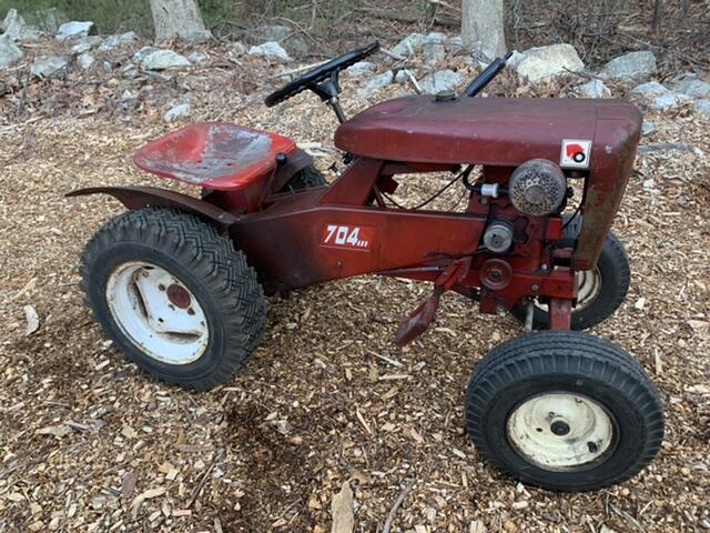

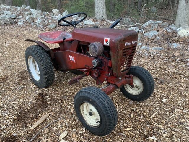

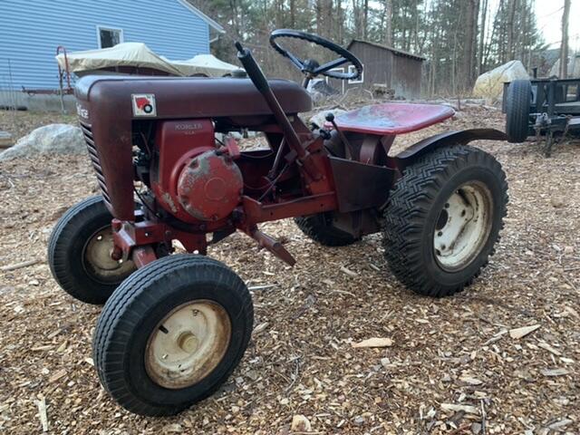

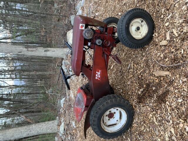

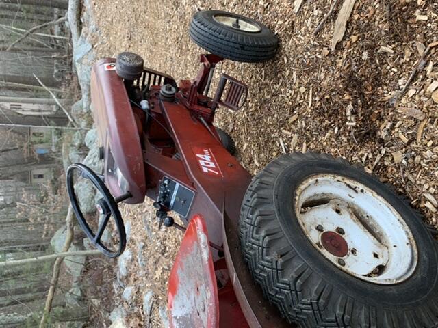

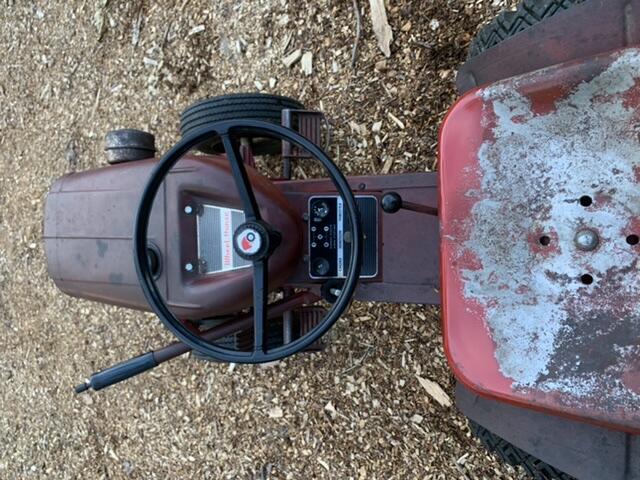

Nice score, looks like a survivor for sure!  I have never been too fond of the dashes on that style hood, but like all others, they are starting to grow on me.  Maybe I’ll add one to my “some day” list :handgestures-thumbupright: :occasion-clown:

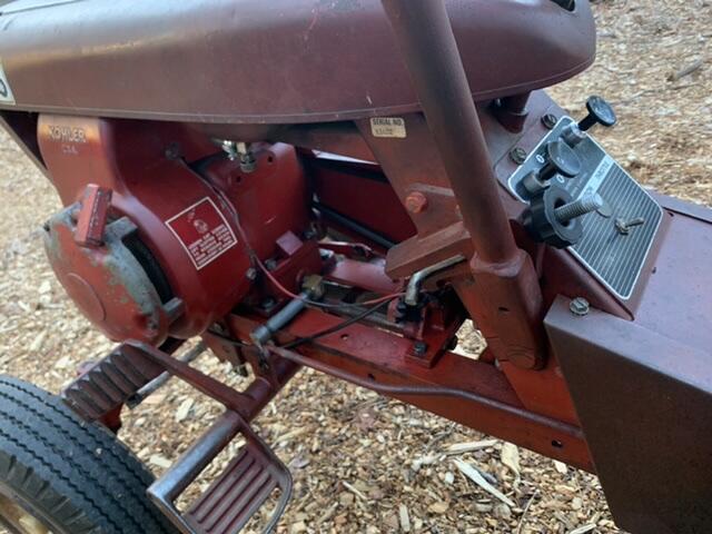

I agree with Kevin - nice score. Looks 98% complete, missing right side beige grease cap and parking brake lever?? Nice patina, and nice to see the hood has not been cut under the steering shaft.
I do not have any "yank start" round hoods, only electric. So.... make sure its in neutral when you pull the rope!!!

That’s all I could find that was missing to. I flipped the starter rope so it can be done easily while seated. Cold started second pull in the 20s this week. I went through it alittle, cleaned and turned the carter carb, new plug, points look brand new just had to correct the gap. New fuel line and filter.

I was the same way and wasn’t a fan of the pull start either. Now the more I look at it parked next to my 753 I like the look even better, looks sleek without the tank cutting into the hood and with the angled dash and more steering shaft reveal through the hood

How about the Unidrive fluid and the condition of the shifter boot?? The shifter acts like a wick when it rains or snows and if the boot is deteriorated it lets the moisture into the case - makes for a milky white mess.
It has the PTO and mount for a cutting deck - could not tell from the pictures if it had the Unidrive mount for a plow?

One of my favorite features on the 704. Round hood with out the square tank.
Nice looking tractor!! :handgestures-thumbupright:

The shifter boot looks new, the fluid was definitely old though, I’m running some atf in it to flush out the old stuff.

It does have the plow mount on the uni drive

That's a dandy! That's kinda a bucket list tractor for me. My Dad's first Wheel Horse was a 1960 400 that he bought new. Then he 'upgraded' to a 704 in 1964. I latched on to the 400 and would like to also have a 704. I've always liked the looks of fresh paint but your tractor is one I'd just clean up and leave it as-is. Beautiful example of a survivor. :)

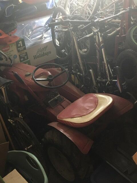

years and years ago (actually decades) I was unable to remove the steering wheel on our 704
I was a dumb kid then - now I'm older (and a dumb adult)
I cut the end of the hood near the steering wheel - transformed the hole into a slot so I could remove the hood with the steering wheel in place
you can barely see the slot in the picture below
the 704 has been sitting in that spot for around 20 years

The reason I asked if it has a plow bracket - since it does, you need to check two areas for damage. Plowing puts a lot of vibration and torsional twisting forces on the Unidrive and frame. Check the frame plate for cracks and tears around the four bolt holes that attach the Unidrive - it is repairable if damaged. Also check the mounting ears or tabs on the cast iron lower steering shaft mount as one or both may be broken. If it is damaged, replace it with a suitable used one  (later models have the same casting but have a thin walled bronze bushing in the lower hole for the horizontal shaft).
I say all this because my 854 8 speed had both problems when I got it.
