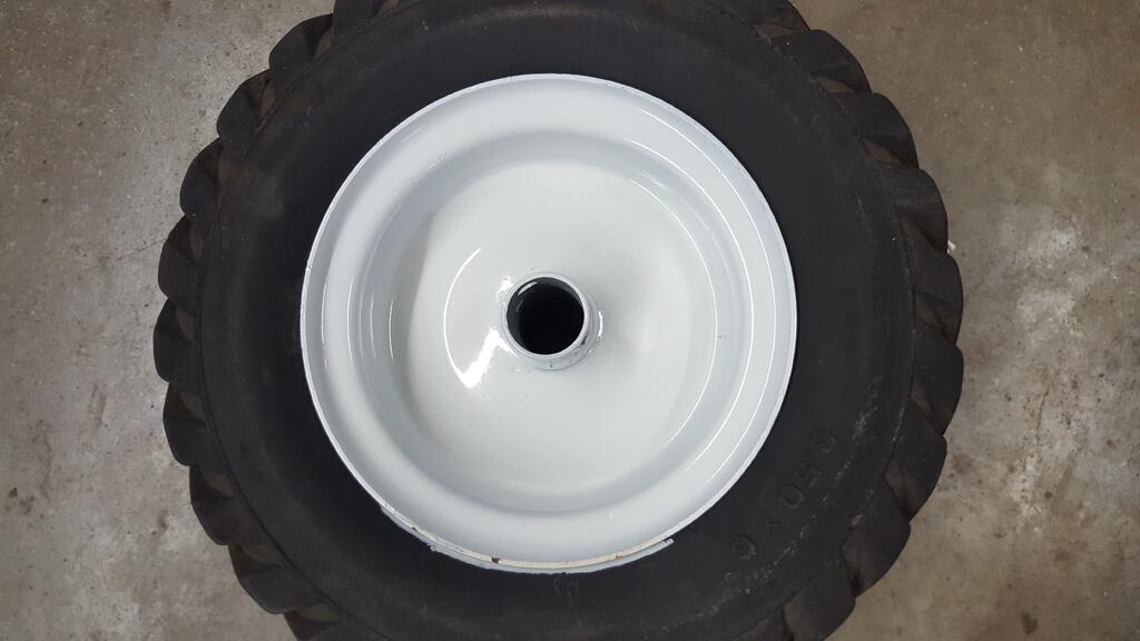

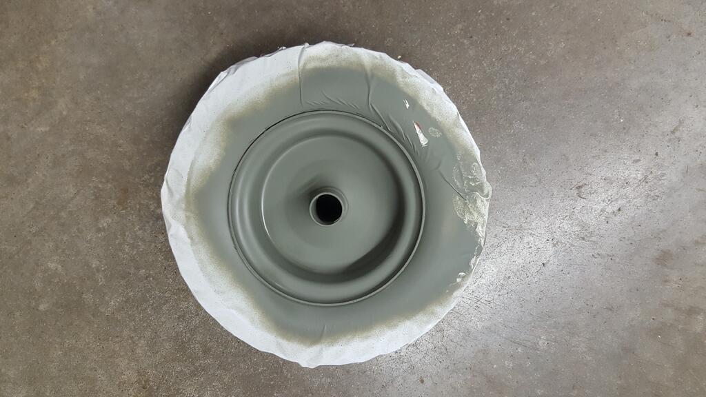

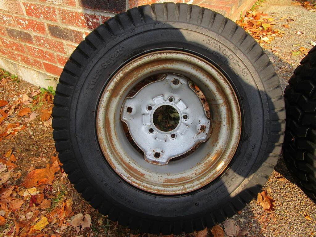

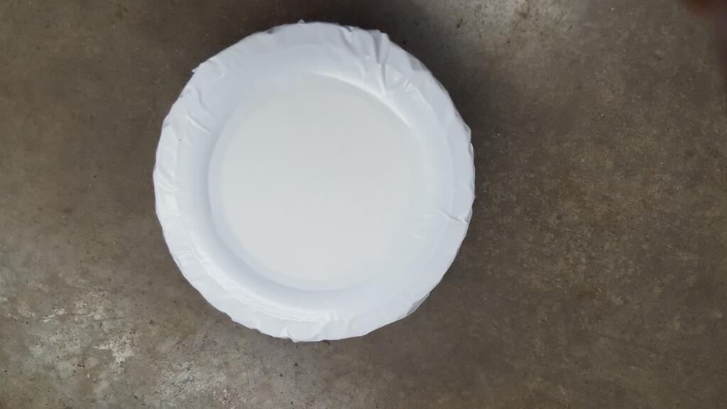

Gregor 4,848 #1 Posted December 8, 2020 Wasn't sure where to post this, so I landed here. I am out of parts for my engine rebuilds, so I moved on to my other project. Whenever I am rebuilding a tractor, one of the jobs I hate most, is prepping the wheels for painting. After they are cleaned up, sanded, and ready for paint, you have to tape off the tire, with several pieces of masking tape, going around and around til it's covered. At least that's the way I always did it. A tedious and time consuming task. So I got an idea. Maybe others have been doing this forever, and I am just a little slow. That's possible. I got a roll of contact/shelf liner paper and covered the entire wheel and tire. Then with a razor knife I trimmed out the center, cutting along the INSIDE edge of the wheel. Using a pick or something pointy, tuck the extra material in around the OUTSIDE edge of the wheel. In no time at all, your wheel is ready for primer and paint. The contact paper comes off in one pull, not stripping off little bits of masking tape. This may not be as good as removing the tire, but some tires, like these, are semi-pneumatic, and don't come off. Just an idea. 3 3 Share this post Link to post Share on other sites

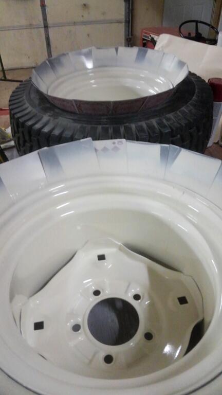

ebinmaine 79,740 #7 Posted December 9, 2020 My Paint Department (Trina) has used the card method with good success until we wanted to paint the wheels on Cinnamon Horse. The back tires are Carlisle commercial grade and have extra rubber around the circumference of the rim called Rim guard. Keeps from damaging the wheel as easily. Well there's NO space to put a card down between the rubber and metal and the tires are fluid-filled so I couldn't just deflate and refill. I posed the situation here and the solution was to use very thin metal to make a tube the same size as the rim. Sprayed inside the tube an' whammo! Done wheels. 2 Share this post Link to post Share on other sites
pacer 3,180 #8 Posted December 9, 2020 13 hours ago, ebinmaine said: I posed the situation here and the solution was to use very thin metal to make a tube the same size as the rim. Sprayed inside the tube an' Similar to my method --- except I use a sanding belt....I have a 48" belt sander and for whatever reason I always keep 3-4 of the 'getting slick' belts hanging on a nail. Since I had tried - I think - all of the above solutions and still wasnt quite satisfied, soooo - I grabbed one of the worn belts to see if it wouldnt fit in that groove around the tire. Yep, did pretty well. I cut it to overlap only 2-3" as a long 'tail' wanted to pop out. I've now got 2 for the 12's and 2 for the 8's. Takes a couple mins per tire. 1 Share this post Link to post Share on other sites

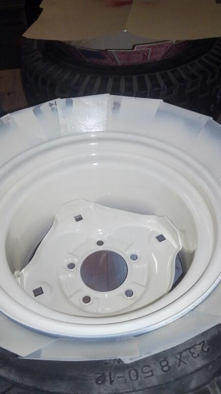

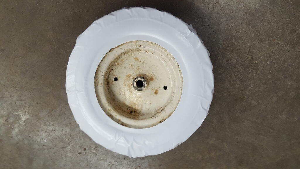

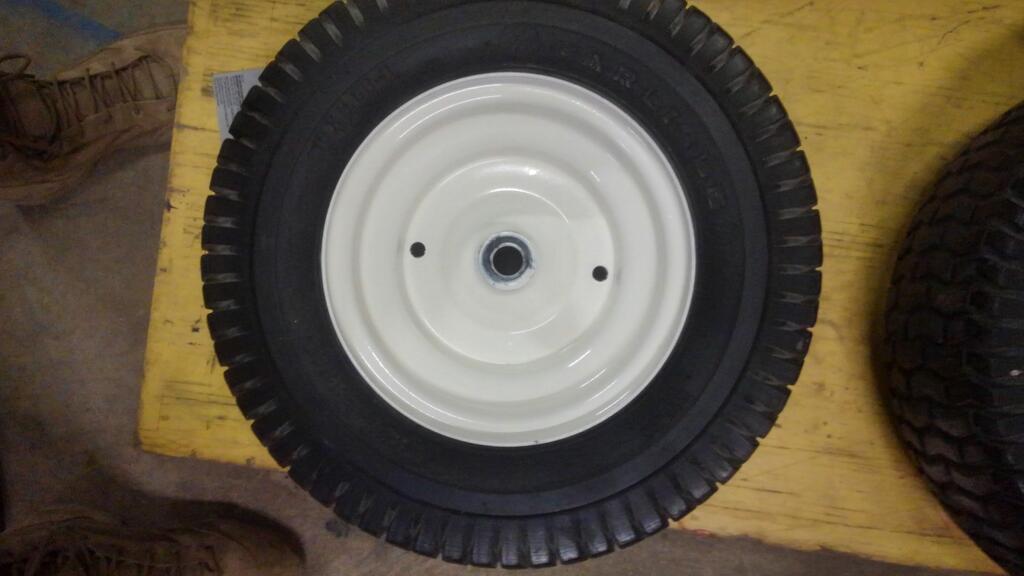

Rusty Tinsnips 477 #10 Posted December 9, 2020 (edited) Just finished these yesterday using the card trick that I learned here. Edited December 9, 2020 by Rusty Tinsnips 3 Share this post Link to post Share on other sites
