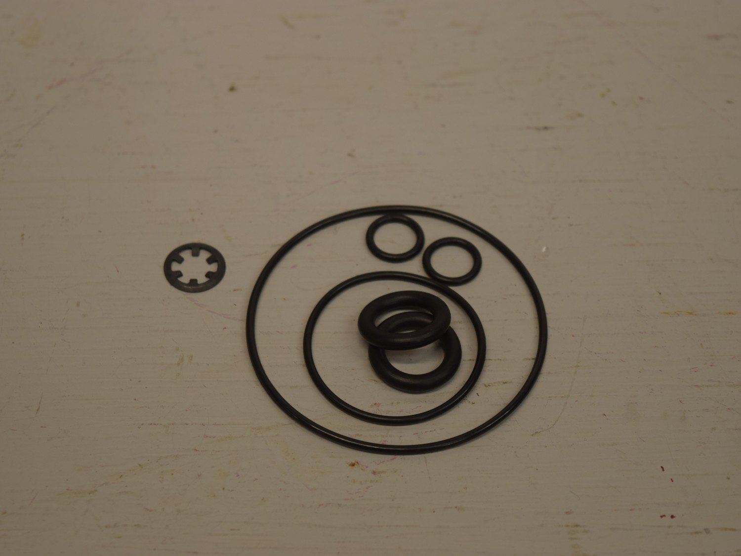

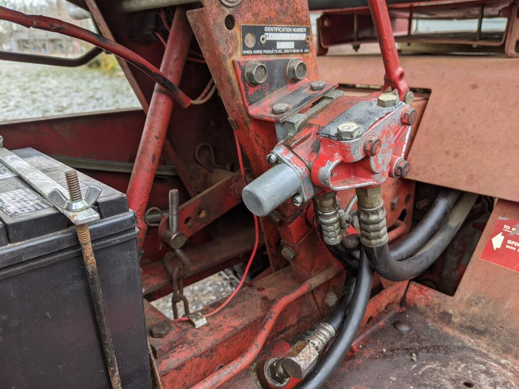

rjg854 12,840 #1 Posted December 7, 2020 (edited) Not sure where to put this, but I have a drip coming from the lift valve on the C-160. I've ordered the parts I need from Lowell. I've tried searching for the steps needed to rebuild the lift valve, but haven't had much luck with that. With no experience with hydraulics, if someone can list the steps I'd have to take in order to make this repair. Do I have to take the valve off the tractor, or can I do this with it in place? The drip comes from the front of the lift valve, from a silver cap that attaches with 2 screws. I'm sure I'd have to pull the whole valve out to do it, but any help would be greatly appreciated. Edited December 7, 2020 by rjg854 Picture added Share this post Link to post Share on other sites
JoeM 9,608 #2 Posted December 7, 2020 There is not much in those to go bad, just o-rings. I guess you could leave it on the machine, but I would take it off and work on the bench cleaning everything up good. Put a little oil on the o-rings when you reassemble. 1 1 1 Share this post Link to post Share on other sites
Tractorhead 9,216 #3 Posted December 7, 2020 Even it‘s easier to have a closer look inside the surfaces, they should be clean and without any scratches inside. Depending on status it can be reworked also mounted in place, but i would remove it for the closer inspection. As @JoeM allready mentioned normally just simply change the O Rings and flush it, to drain loosen o- ring parts out, to not have them in the Hydraulic system. 1 1 Share this post Link to post Share on other sites

pfrederi 19,874 #5 Posted December 7, 2020 (edited) You have to remove a teeny tiny snap ring on the front end of the valve core. (That is a real treat as there is hardly any clearance and you need really tiny pins on your snap ring pliers). Then you can pull it out to the rear. Put the new cups (they are not O rings) in hot water while you get the old ones off. Make a note which groove they go in and which way the cups face. Lube the new rings up and work the on trying not to damage them. Put the valve care back in keeping the spring compressed try to get the snap ring back on. i think Lowell includes them. Note clean up your work space if that snap ring slips off it will go to join the detent balls from your tranny and other small objects. Edit I just realized the valve in question is a newer type. I was describing the valve in Charger/Electros Edited December 7, 2020 by pfrederi 2 Share this post Link to post Share on other sites

520HC 208 #13 Posted December 8, 2020 I just rebuilt one last week. Take the cap off the front the handle off the rear and pull the shaft thru. There are only 2 orings one in back and 1 in front. 1 1 Share this post Link to post Share on other sites
rjg854 12,840 #14 Posted December 8, 2020 Got some information from Lowell also seems to be a fairly straightforward repair, but keep the pointers coming. I have no experience with hydraulics. Thanks for everything so far. Share this post Link to post Share on other sites

rjg854 12,840 #18 Posted December 19, 2020 Got my parts from Lowell yesterday, so it looks like today I'm going to try and tackle the valve. I had to use the C-160 to plow after this last storm, it didn't leak to bad, so the sooner I get it fixed the better. Share this post Link to post Share on other sites
rjg854 12,840 #19 Posted December 19, 2020 Got the lift valve rebuilt and reinstalled on the C160. For somebody that claimed they didn't know anything about hydraulics, the rebuild was pretty simple. So anyone thinking that this is a difficult job, don't sweat it. 1 Share this post Link to post Share on other sites
