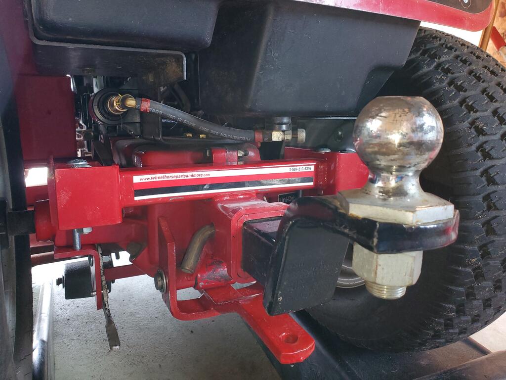

Racinbob 12,509 #2 Posted December 6, 2020 That's pretty common on the models with the fuel tank under the seat. It's more pronounced in the winter because you likely let the tractor sit idle longer. It was definitely an issue with my 2005 Classic. Now it can sit a long period and when I turn the key on I listen to the whirr of the pump and she fires right up. 1 1 1 Share this post Link to post Share on other sites

Racinbob 12,509 #4 Posted December 6, 2020 It's a Mr. Gasket #42s. Share this post Link to post Share on other sites
tractormandash 5 #5 Posted December 6, 2020 Has it held up good for you? Share this post Link to post Share on other sites
Racinbob 12,509 #6 Posted December 6, 2020 So far it's been great. I did previously purchase two of the little cheapies but I decided not to use them. We mow a very large amount and I felt more comfortable with a better unit. Share this post Link to post Share on other sites
tractormandash 5 #7 Posted December 6, 2020 Awesome. Did it come with install instructions? Share this post Link to post Share on other sites
Racinbob 12,509 #8 Posted December 6, 2020 (edited) Yes. It really a simple install. The hardest part was deciding were to mount it. The spot I chose was like it was made for it. If I remember right the pump uses 5/16" line, the tractor is 1/4". Hardware store stuff. That 90° fitting is 1/4" x 5/16". The pump comes with a filter that you can see in the picture. Edited December 6, 2020 by Racinbob 1 Share this post Link to post Share on other sites
tractormandash 5 #9 Posted December 6, 2020 Ok sounds good. Did you wire it right to the battery or go through the ignition switch? Share this post Link to post Share on other sites
Racinbob 12,509 #10 Posted December 6, 2020 I went to the 'run' position on the switch. When I start it I turn the key only to the run position for a few seconds. You'll hear it running. Then I start it. It sat for extended periods last winter and every time it was instant start. I loved it. 1 Share this post Link to post Share on other sites
Racinbob 12,509 #11 Posted December 6, 2020 Don't forget to use an inline fuse. I don't remember if it came with one or I added it. 1 Share this post Link to post Share on other sites
tractormandash 5 #12 Posted December 6, 2020 Ok. It looks like that pump makes three psi and that doesnt sound like that would mess with the needle and seat? 1 Share this post Link to post Share on other sites
Racinbob 12,509 #13 Posted December 6, 2020 Correct. It's actually rated at 2-3.5psi. No issues at all. 1 Share this post Link to post Share on other sites
tractormandash 5 #14 Posted December 6, 2020 Thank you again. You've been a great help. Share this post Link to post Share on other sites

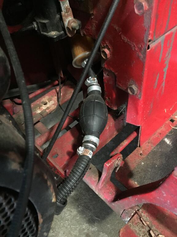

SylvanLakeWH 30,168 #17 Posted December 6, 2020 I put an in line primer bulb on mine and it works perfectly every time... cheap and quick... Share this post Link to post Share on other sites
tractormandash 5 #18 Posted December 6, 2020 Awesome. That's what I was leaning toward initially as I have a second new vacuum pump. Mt thought was to try the inline primer bulb then eventually switch to electric fuel pump. Thank you everyone. Jay 1 Share this post Link to post Share on other sites
