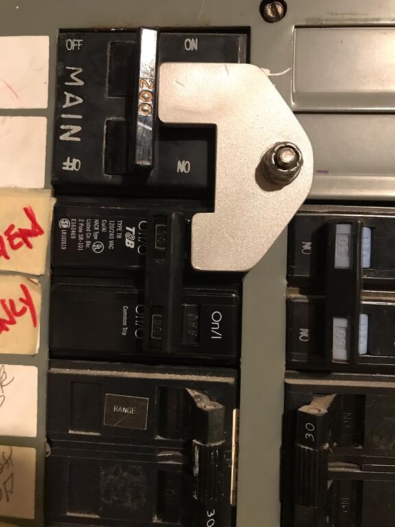

McGrew 461 #58 Posted December 11, 2020 We lose power more often than I wish, usually due to winds or ice taking down power lines. We have gone for days without power, so I got a nice (relatively) portable generator. My house was built in 1976, and the breaker panel is not a common brand, but I found several manufacturers who make a generator interlock for it. I hated the price ($65?) for what I was getting, but ordered it anyway. When the supplier told me it was out of stock, I took that as an omen. I looked at the picture of what they were selling (a piece of sheet metal, a template and a screw) and decided to make my own. I had to move a couple breakers in the panel to get the generator breaker under the main, but after a little tweaking got it to work perfect. Now you cannot energize the generator breaker without turning off the main. Works for me and protects the linemen trying to restore my power. Danny 1 Share this post Link to post Share on other sites

ZXT 2,402 #61 Posted December 11, 2020 12 hours ago, McGrew said: We lose power more often than I wish, usually due to winds or ice taking down power lines. We have gone for days without power, so I got a nice (relatively) portable generator. My house was built in 1976, and the breaker panel is not a common brand, but I found several manufacturers who make a generator interlock for it. I hated the price ($65?) for what I was getting, but ordered it anyway. When the supplier told me it was out of stock, I took that as an omen. I looked at the picture of what they were selling (a piece of sheet metal, a template and a screw) and decided to make my own. I had to move a couple breakers in the panel to get the generator breaker under the main, but after a little tweaking got it to work perfect. Now you cannot energize the generator breaker without turning off the main. Works for me and protects the linemen trying to restore my power. Danny Looks like it works! Though I wouldn't be able to install it (since it isn't UL listed) for liability reasons. That looks like a Murray panel (Or Crouse Hinds, same thing) with some Westinghouse and Thomas & Betts breakers mixed in. That brand panel actually isn't all that uncommon, around here at least. Being built in the mid-70s, it could've had a Federal Pacific or a Zinsco instead (both fire starters) and aluminum wiring, so you're ahead of the game with what you have. If you ever have to change any breakers and want to put the "right" replacement in, Eaton CL breakers are listed for that panel. Share this post Link to post Share on other sites

McGrew 461 #65 Posted December 11, 2020 4 hours ago, ZXT said: Looks like it works! Though I wouldn't be able to install it (since it isn't UL listed) for liability reasons. That looks like a Murray panel (Or Crouse Hinds, same thing) with some Westinghouse and Thomas & Betts breakers mixed in. That brand panel actually isn't all that uncommon, around here at least. Being built in the mid-70s, it could've had a Federal Pacific or a Zinsco instead (both fire starters) and aluminum wiring, so you're ahead of the game with what you have. If you ever have to change any breakers and want to put the "right" replacement in, Eaton CL breakers are listed for that panel. ZXT, I understand any contractor’s reluctance to avoid the liability. Even though my solution is a carbon copy of the approved design, it did not pass the tests the tests the manufacturer of the design paid for. That said, it works! FYI, the panel is a Bryant. i had to buy a 50 amp breaker to hard wire the generator in, and believe the breakers that interchange are GE brand? Danny 1 Share this post Link to post Share on other sites
ZXT 2,402 #66 Posted December 11, 2020 2 hours ago, McGrew said: ZXT, I understand any contractor’s reluctance to avoid the liability. Even though my solution is a carbon copy of the approved design, it did not pass the tests the tests the manufacturer of the design paid for. That said, it works! FYI, the panel is a Bryant. i had to buy a 50 amp breaker to hard wire the generator in, and believe the breakers that interchange are GE brand? Danny Bryant was my next guess. Westinghouse = Bryant. As for replacement breakers, Eaton "BR" breakers are listed as replacements for it and are readily available and cheap. Eaton "CL" breakers are listed as well, but they're listed as replacements for many other old panel brands and are more expensive as a result. The "BR" designation actually stands for Bryant. Share this post Link to post Share on other sites
McGrew 461 #67 Posted December 11, 2020 2 hours ago, ZXT said: Bryant was my next guess. Westinghouse = Bryant. As for replacement breakers, Eaton "BR" breakers are listed as replacements for it and are readily available and cheap. Eaton "CL" breakers are listed as well, but they're listed as replacements for many other old panel brands and are more expensive as a result. The "BR" designation actually stands for Bryant. Thanks ZXT! Good info if I need to make any more changes. Danny 1 Share this post Link to post Share on other sites
Roger R 473 #68 Posted December 12, 2020 4 hours ago, ZXT said: Bryant was my next guess. Westinghouse = Bryant. As for replacement breakers, Eaton "BR" breakers are listed as replacements for it and are readily available and cheap. Eaton "CL" breakers are listed as well, but they're listed as replacements for many other old panel brands and are more expensive as a result. The "BR" designation actually stands for Bryant. Square D Homeline Breakers fit also, although are not listed for these panels. I have actually found Homeline breakers fit better than some of the Siemens in a Siemens panel. Siemens is now the parent company to many of the above mentioned manufactures. 1 Share this post Link to post Share on other sites
