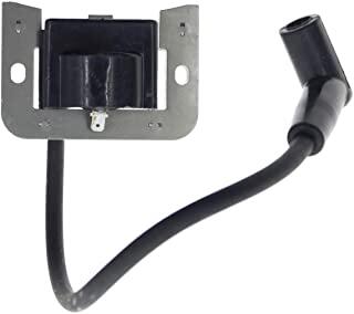

Gregor 4,848 #127 Posted January 4, 2021 When reading the comments under the video, I understood it to mean, the module will work with a 2 leg coil, but not a 3 leg coil. 2 leg coil3 leg coil 1 Share this post Link to post Share on other sites
Tractorhead 9,217 #128 Posted January 4, 2021 (edited) you be right Eric, tried it today with no success, it fires several times and not only when needed. so i dismount it for now. if there is just a Single magnet in the Flywheel it will work, but it didn‘t on a E- start Tecky with Charger coils and multiple magnets. ok, so i have it still aside for whatever reason in the future.. However i did today a longer testrun of my Engine after the rework. It runns nicely and much smoother than before. also it‘s nearly a non smoker. The rattling noise is from the Steering Wheel, my next challenge Edited January 4, 2021 by Tractorhead Share this post Link to post Share on other sites
305 381 #129 Posted January 4, 2021 hmmmm...so it only works on single magnet flywheels? i think someone suggested that Share this post Link to post Share on other sites
Tractorhead 9,217 #130 Posted January 4, 2021 1 minute ago, 305 said: hmmmm...so it only works on single magnet flywheels? i think someone suggested that Yap, i thinkering also that it will become troubles but i just like to give it a Try. When you change over to a One magnet Flywheel it should work, but than the Charging coil maybe was to weak to recharge the battery. Another solution will be a external CDI ignition with a separate aftermarket Pickup, like the honda monkey engines have or similar, but for now, the points will be kept. 1 Share this post Link to post Share on other sites
