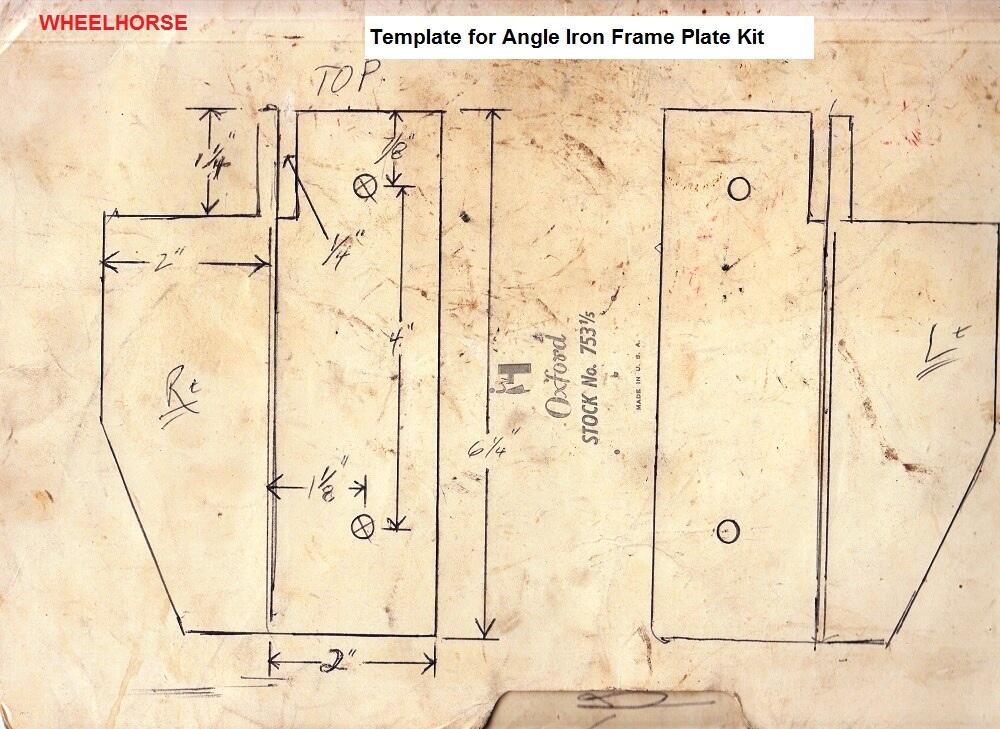

BOB ELLISON 2,982 #4 Posted November 28, 2020 This is the plate someone else posted. Wheelhorse did add this plate to the 520h and it was a part that could be purchased from them but not anymore. But even with this added its best to add supports to the frame. 2 2 Share this post Link to post Share on other sites

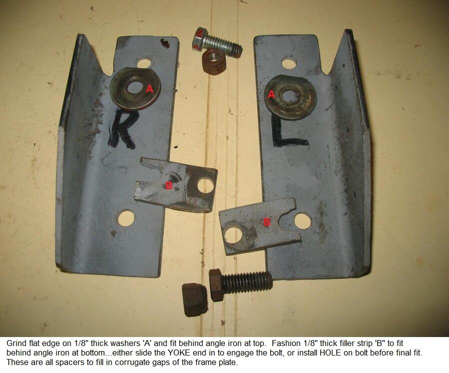

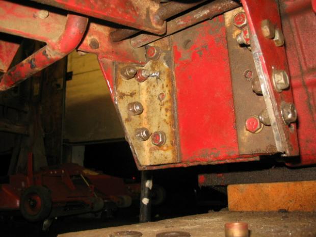

daveoman1966 3,881 #5 Posted November 28, 2020 The 'frame plate' bolted to the transmission...std or auto....will also crack at the CORNERS. To reinforce /strengthen / repair the corners, use a 6" 2x2 angle iron...1/4 - 3/8 thick.... Trim each to this configuration. No welding required...just drill a few holes in the triangle plate on each side. 6 7 Share this post Link to post Share on other sites
