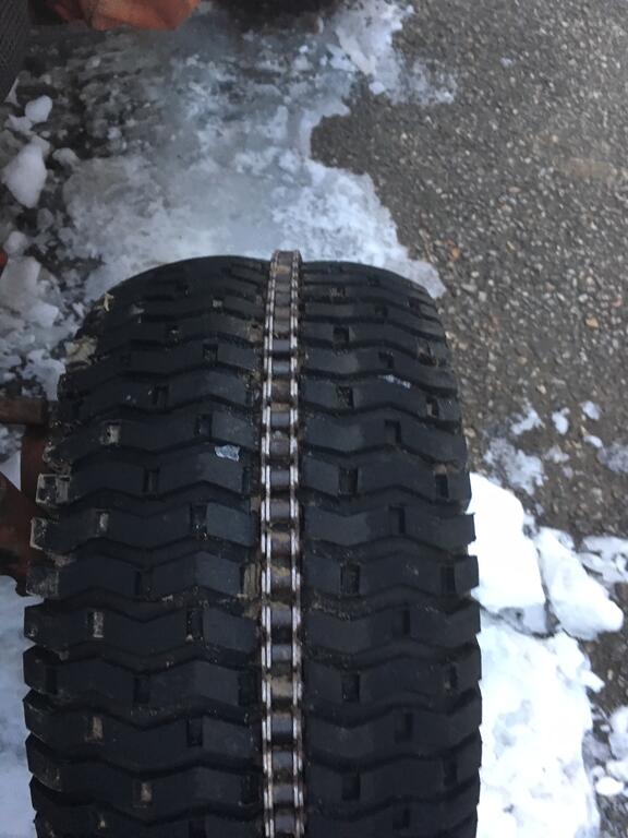

wallfish 18,108 #4 Posted November 28, 2020 #40 roller chain around the front tires works great. All of my snow machines will always have this done 4 2 Share this post Link to post Share on other sites

wallfish 18,108 #6 Posted November 28, 2020 (edited) I never measured, just pulled the chain around the tire and marked it, but get them on tight with the tire deflated. Then pressure them up. They need to be very tight or they will walk off the tire from the side load. You can see the bulge on each side of the chain. Makes a huge difference in steering and especially plowing with the blade angled Yeah, forgot the chairs so I have a good excuse to return. Looking forward to it already Edited November 28, 2020 by wallfish 2 Share this post Link to post Share on other sites

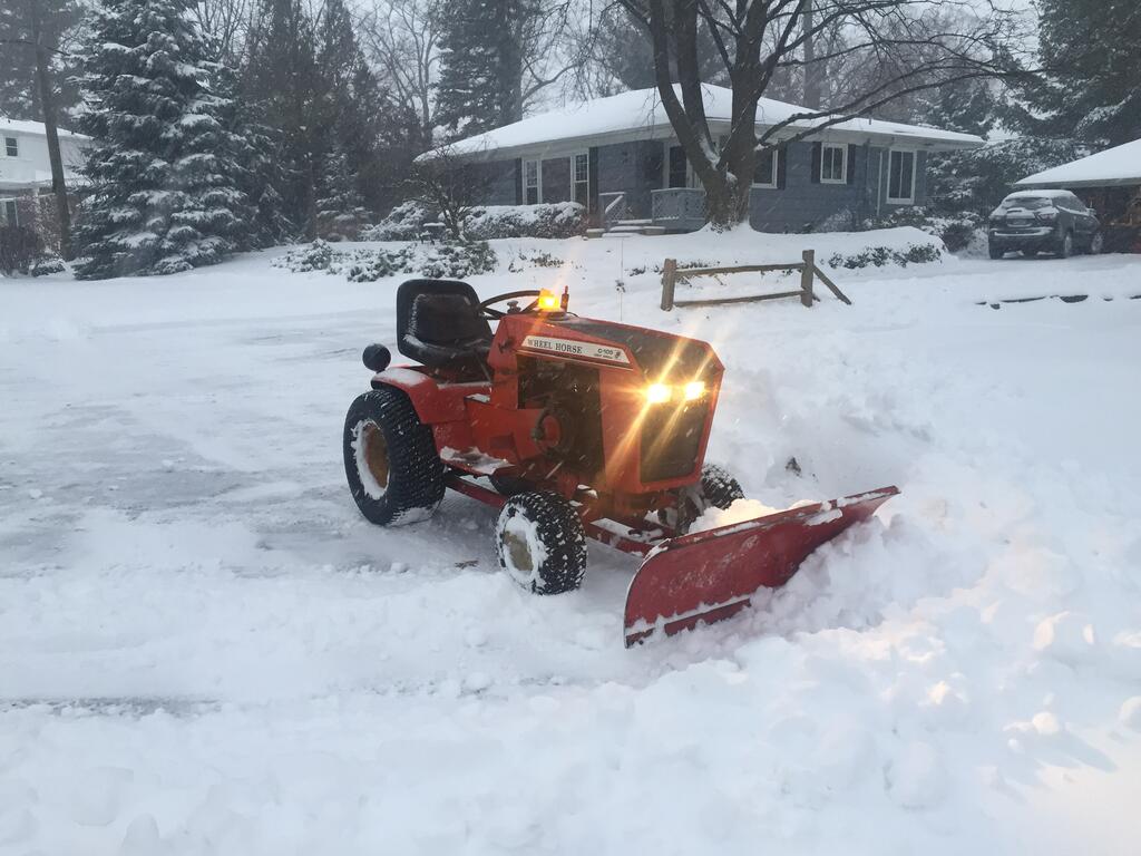

SylvanLakeWH 28,424 #11 Posted February 3, 2021 9 minutes ago, DennisThornton said: I don't see how. Rears filled with 2-links and I'm adding roller chain to the fronts and weights to the rears shortly. Might fill the fronts as well. Just lucky I guess...Have done it for 5 seasons now... I plow in 2 high (1 high for cleanup / near cars etc...). Here’s my set up... 1 Share this post Link to post Share on other sites
DennisThornton 4,771 #12 Posted February 3, 2021 11 minutes ago, SylvanLakeWH said: Just lucky I guess...Have done it for 5 seasons now... I plow in 2 high (1 high for cleanup / near cars etc...). Here’s my set up... Well, I understand that it does snow in Michigan and indeed it looks like snow but I have no idea how you manage with those tires and no chains! 2 1 Share this post Link to post Share on other sites

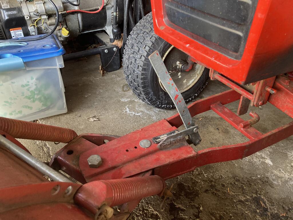

tallen4392 71 #13 Posted February 3, 2021 How do you turn the blade I don’t see a lever ?? 1 Share this post Link to post Share on other sites

SylvanLakeWH 28,424 #18 Posted February 4, 2021 22 hours ago, tallen4392 said: How do you turn the blade I don’t see a lever ?? Previous owner built this lever... (the blade is not correct model and is modified to fit my C 105. Works perfectly...) I have a plow pattern for each of the 3 driveways I plow, so I just keep it where it is and don’t need to get off to change blade direction... Share this post Link to post Share on other sites
