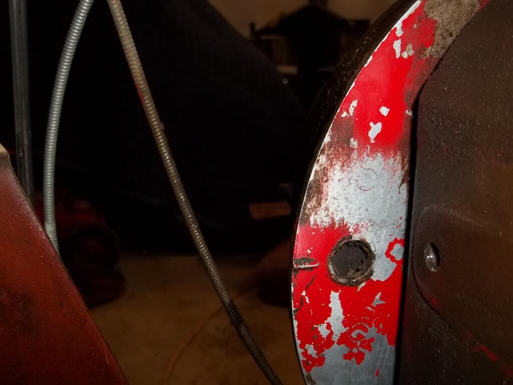

953 nut 65,237 #27 Posted November 30, 2020 (edited) 4 hours ago, pfrederi said: Some older K series the timing hole was on the back of the shroud, As far as I know the flywheels that had timing marks that were viewed from the back of the bearing plate were Starter/Generator engines (see photo) and wouldn't have the ring gear. Is there an arrow or mark cast into the bearing cover that would line up with the TDC and SP marks with the piston up? Do you know what the Spec. Number of the engine is? Might have been intended for an application where the standard sight hole would be covered. Edited November 30, 2020 by 953 nut 1 Share this post Link to post Share on other sites

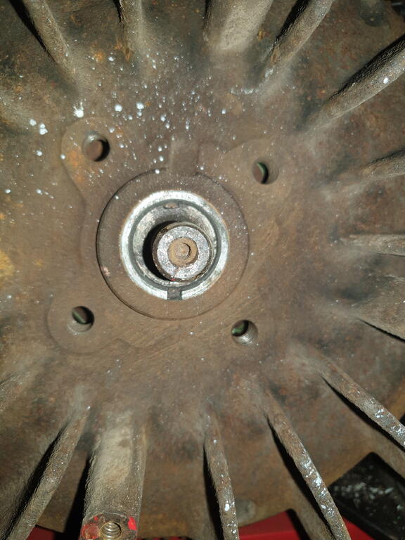

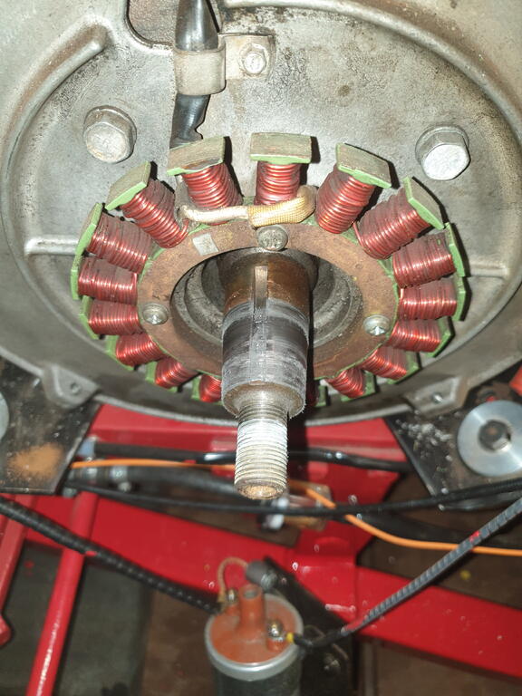

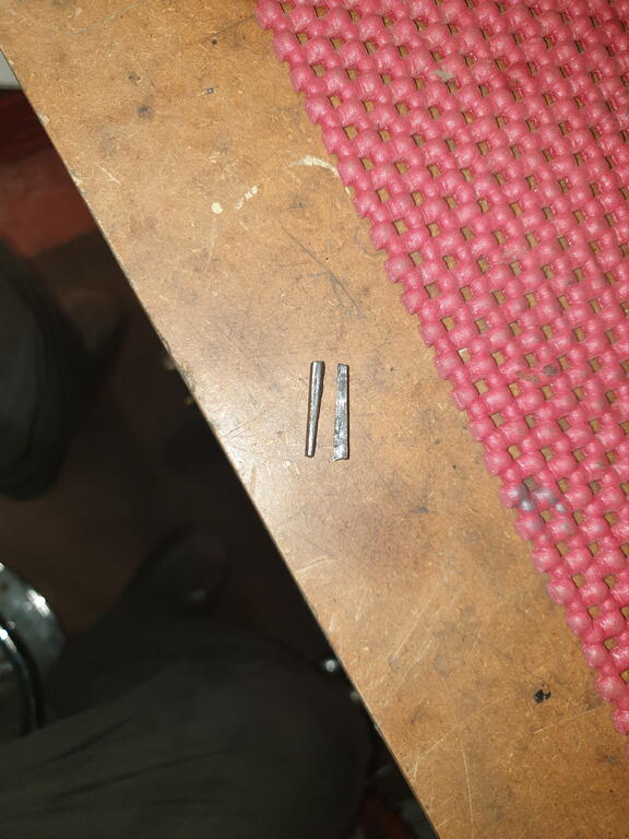

Mickwhitt 5,259 #28 Posted November 30, 2020 Well the mystery of the timing marks was solved at 6 am GMT today.... I made a puller for the flywheel and found the key had indeed sheared in two. Never seen anything quite like it. This photo shows the end of the crank shaft with the flywheel still on. The key ways can be seen almost 180 degrees opposite each other. And this image shows the end of the crank shaft with the sheared key. As I said, never seen a key bitten in half like that! Must have been some major kick back to cause that. I will try to restore everything but if it fails again it will be a new engine I think. Mick 1 1 Share this post Link to post Share on other sites
953 nut 65,237 #29 Posted November 30, 2020 That would explain the vibration, the flywheel is balanced to the crankshaft. 2 Share this post Link to post Share on other sites
gwest_ca-(File Mod) 12,149 #30 Posted November 30, 2020 The key just locates the flywheel on the crankshaft for timing and balance. It is the clean and dry taper with the specified nut torque that holds it there. Briggs uses aluminum keys to stress the point. Garry 1 Share this post Link to post Share on other sites
lynnmor 8,743 #31 Posted November 30, 2020 Nailed it just 16 minutes after your original post, at my age I gotta' boast when I can! The shaft taper and the bore needs to be as clean and true as you can get them. After removing the unwanted metal, you might get a better fit if you lap them together using very fine lapping compound. A taper needs to be a good fit to get the locking action you need. 4 Share this post Link to post Share on other sites

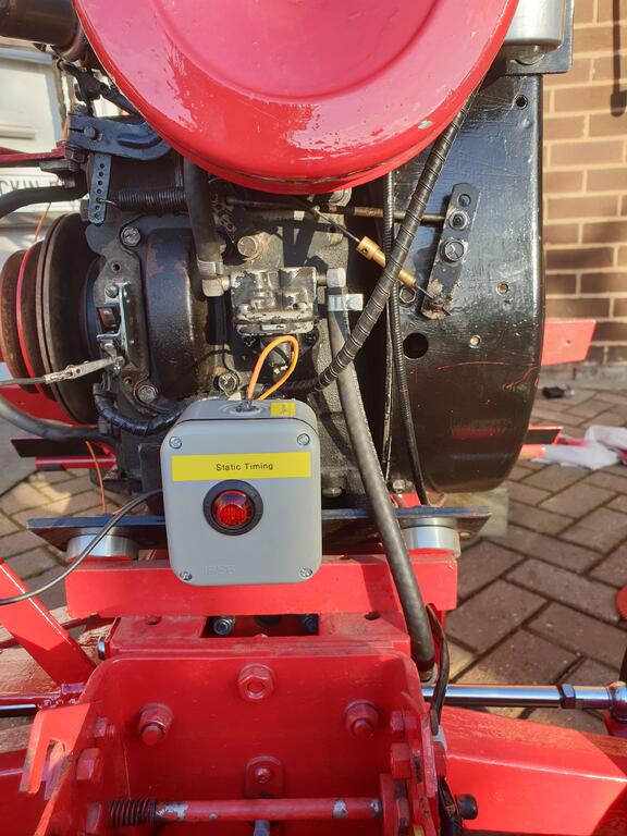

Mickwhitt 5,259 #47 Posted December 18, 2020 I built a little static timing light to make timing a bit easier. Just a test lamp coupled to battery positive and a croc clip to the points. You can then trun the engine to find when the points break and check the timing mark pretty easily. A lot better than a multi meter or test screwdriver. Share this post Link to post Share on other sites
