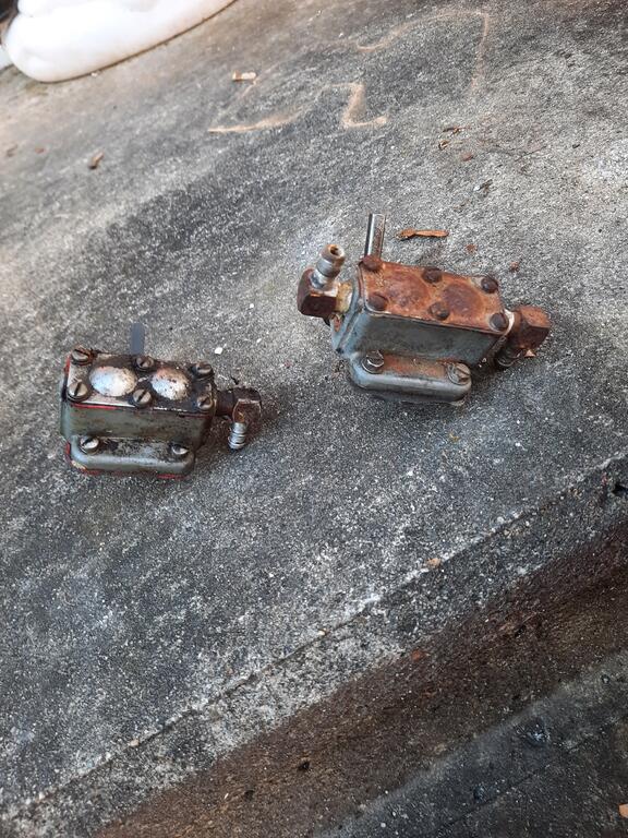

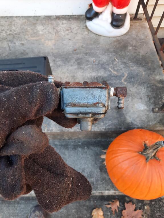

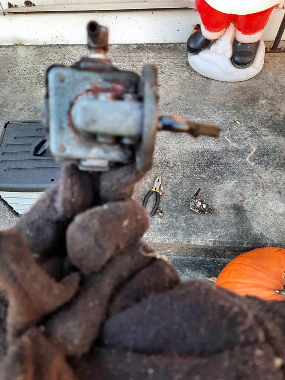

Docwheelhorse 2,803 #1 Posted November 24, 2020 Hello all, I know the Kohler aluminum body fuel pumps generally have unobtainable rebuild kits. What about this style off the K341 16 hp single? Happy Thanksgiving and stay safe! Tony Share this post Link to post Share on other sites

wallfish 18,859 #6 Posted November 25, 2020 (edited) Take it apart but go slowly in case the springs can come out loose. Those little springs can be like the lost socks from your clothes dryer, who knows where they go but they're never seen again. If the check valves are accessible little disks, (which I'm guessing they are) clean them up and flip them over. clean the surface they mate too and they should work again. Since those are mechanical driven pumps, the diaphragm should work as long as there aren't any holes in it. I have some diaphragm material if need be but not sure what that type looks like. Open them up! Edited November 25, 2020 by wallfish 2 Share this post Link to post Share on other sites
