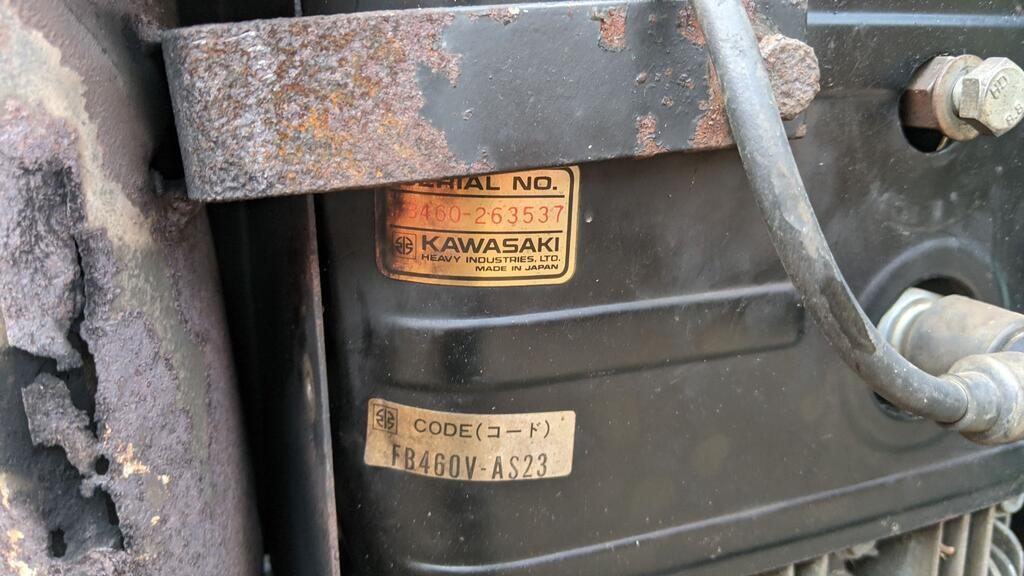

JC_wolf64 1 #1 Posted November 24, 2020 wheelhouse 212-5 Kawasaki engine not charging battery. I'm having problems finding the problem but I don't understand how the battery charges without an alternator, the previous owner messed with all the wiring and the starter motor is on the lights switch. it works but it doesn't seem to charge the battery Share this post Link to post Share on other sites

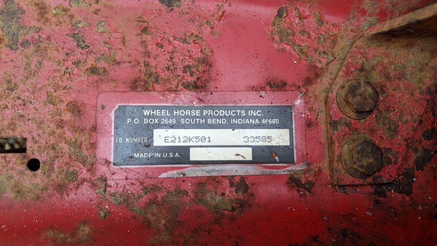

JC_wolf64 1 #4 Posted November 24, 2020 having spent a good 45 mins looking at all the drawings none of them look like mine, mine is not a Toro A2-12K501 and not a hydrostatic E2-12K502, F2-12K501,R2-12K501, and my air filer do not match E2-12K501 Share this post Link to post Share on other sites

gwest_ca-(File Mod) 12,000 #6 Posted November 24, 2020 Some parts lists are shared so not uncommon to see a different transmission or engine in the manuals. All those models listed are the Kawasaki powered models as the model number is a K. The 5 is the manual transmission speeds. Near as I can tell the tractor ID decal is on the rear fender pan under the left side of the seat. Left and right always from the operator's position in the seat. Should have the model number and serial number on it. The 212-5 is the model name. Want to get you the correct tractor wiring diagrams is why the tractor model number is important. Here is an engine service manual that will walk you through testing the charging system. Garry Share this post Link to post Share on other sites
JC_wolf64 1 #7 Posted November 24, 2020 OH, the mowers ID, not the engines ID 1 Share this post Link to post Share on other sites
