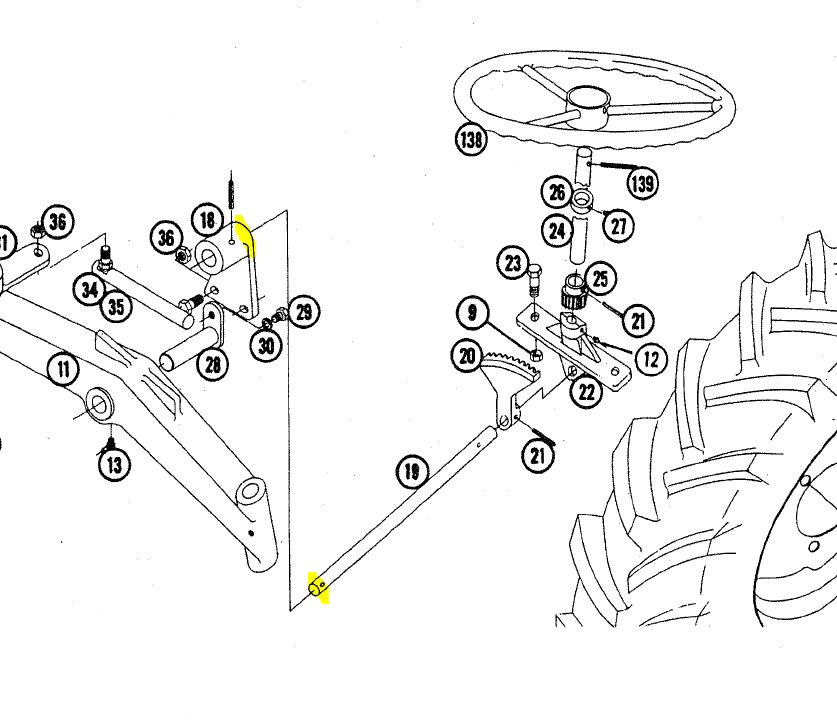

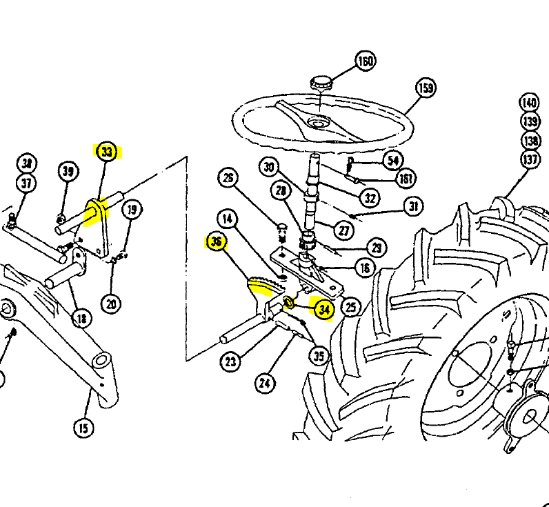

Crmaverick 91 #1 Posted November 20, 2020 (edited) On my 753 someone has booger welded the steering shaft where it meets the arm for some reason. While I have my front axle off I should probably swap this out before the welds snap. I highlighted on the 753 where its welded and the 854 diagram of what it looks like I need. Can this be done or are the lengths different? Would the 854 steering be considered an upgrade or should I just look for a 753 shaft and link? Edited November 20, 2020 by Crmaverick 1 Share this post Link to post Share on other sites

gwest_ca-(File Mod) 11,998 #5 Posted November 21, 2020 45 minutes ago, rjg854 said: @CrmaverickLook up the manuals for each tractor and compare numbers, they just might be the same, as well some other models might also work, the Ponds were quite frugal when it came to parts being interchangeable. The cast iron front pivot link that the tie rods bolt to on the 753 is pinned to the shaft. On the 854 it is steel and welded so different part number. That is still not saying they will interchange. Garry Share this post Link to post Share on other sites
Crmaverick 91 #6 Posted November 22, 2020 12 hours ago, gwest_ca said: The cast iron front pivot link that the tie rods bolt to on the 753 is pinned to the shaft. On the 854 it is steel and welded so different part number. That is still not saying they will interchange. Garry From what I looked at it should swap right in. I think that welding them was an improvement for 64 models and why someone booger welded mine, probably sheared the pin off on the steering arm. Share this post Link to post Share on other sites
