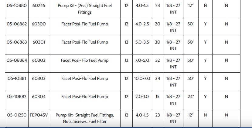

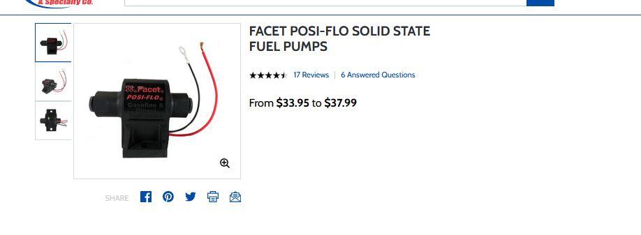

pfrederi 18,970 #2 Posted November 18, 2020 I have had good service from Facet Posiflow pumps... Made in USA 6 Share this post Link to post Share on other sites
