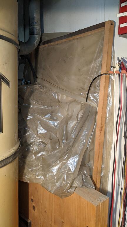

echris 1,425 #5 Posted November 19, 2020 I have an old kitchen range hood in my basement shop venting right out the window. It's over a small 4' x 2' workbench. A few years ago I made a simple wooden frame to match the bench outline using 3/4" square pine scrap and pinchy clamped it to the range hood lower lip. I stapled 2mil clear plastic to the frame and draped it around the entire bench, with a stage curtain opening at the front. I did a test staining a scrap of wood with Minwax and I couldn't even smell it from working distance. Works great for painting small parts indoors in the colder climates. Add heat lamps. In that little tent, one 100w bulb would make it a furnace. Feel free to scale up. Here's a shot of the frame, all dusty, jammed behind the pantograph and the 1970's Sears central vac. ;/ 1 Share this post Link to post Share on other sites
