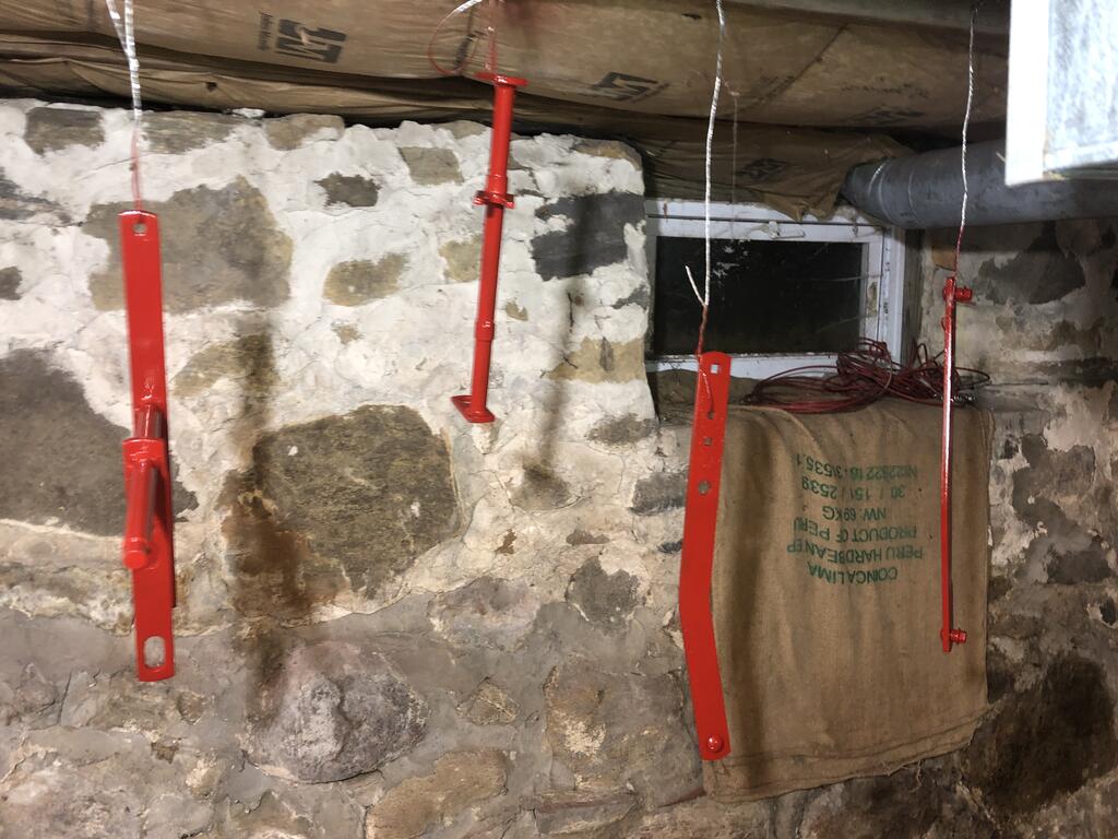

Charbs152 257 #35 Posted November 23, 2020 Update: All deck parts except for the actual deck is primed. There are two small spots i want to try to weld. https://imgur.com/gallery/QjrGzch Share this post Link to post Share on other sites

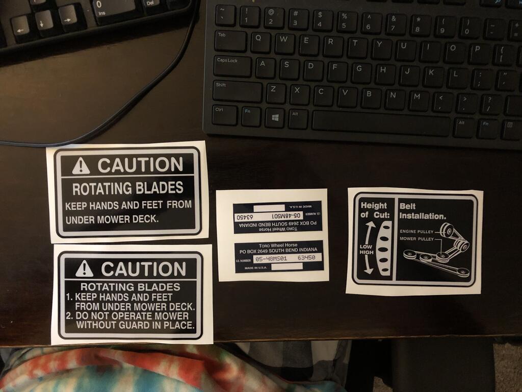

Charbs152 257 #37 Posted December 1, 2020 (edited) well I took the spindle apart and I have 2 different types. One looks to be original and the other 2 look to be replacements. one has a larger diameter than the other two. I had ordered 6 bearings but the Bearings I ordered only fit the larger shaft. (6203 3/4 2RS/C3) Soo- i ordered up some metric bearings. The paint is coming along nicely also got the decal kit in as well. Still searching for spindle shafts and housings...Anyone got anything? Edited December 1, 2020 by Charbs152 Share this post Link to post Share on other sites
