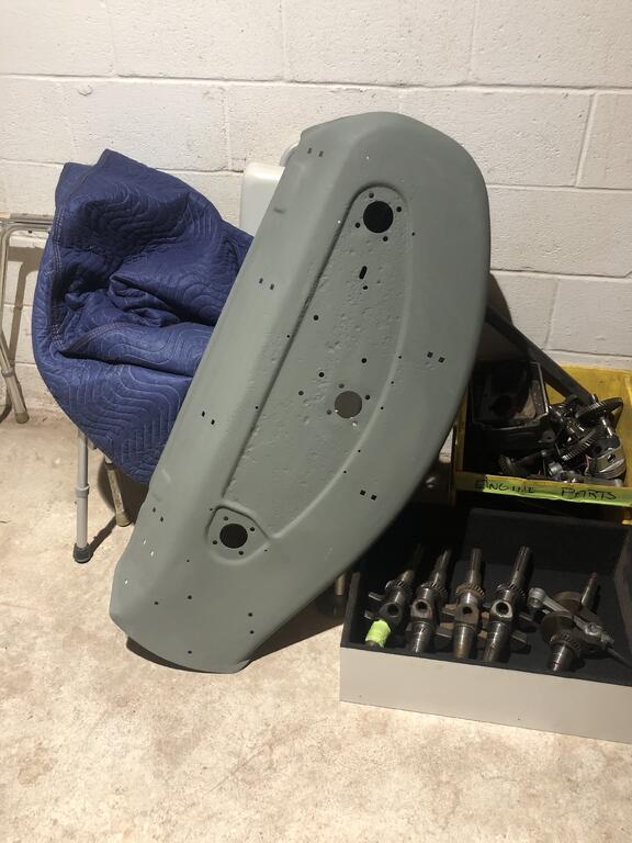

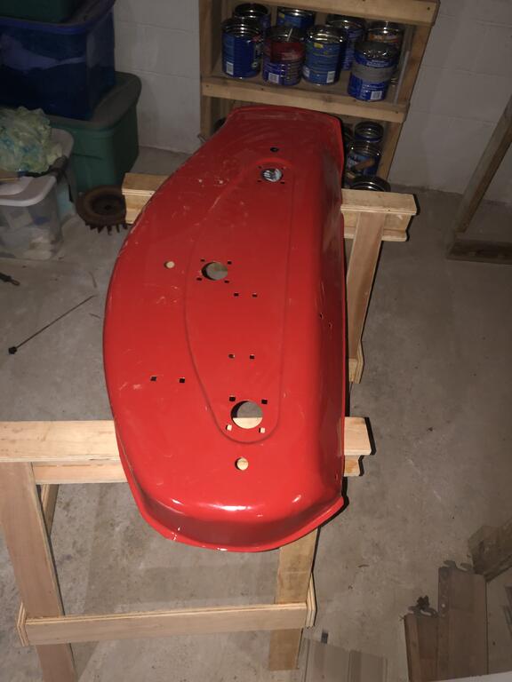

The Tuul Crib 7,340 #1 Posted November 15, 2020 I'm going through the mower decks that I have and I have these two pics. First one I am not sure of model or serial number. The other is off my charger that I'm about to go through. I really need a side discharge right now and don't have one! all I have is the rear discharge on my 414-8. Share this post Link to post Share on other sites
gwest_ca-(File Mod) 11,755 #2 Posted November 15, 2020 I do not know what you have but here is a list of the 42" SD decks in the order they were produced Mower DNA 1966-1967 model RL-426 replaced by 1968 model 5-1421 1969 model 5-1422 1970 model 5-1423 1971 model 5-1000 1971-1972 model 5-1001 1973-1974 model 5-1010 1975 model 5-1011 1975 model 5-1012 1976 model 65-42MS01 1976 model 65-42MS02 1977 model 75-42MS01 - These 42" side discharge decks all use blades with 5/8" x 3/4" double-D center hole unless the spindles have been upgraded (Do not have operator manual) -------------------------------------------------------------------------------------------------------------------------------------------------------------------------------------------------------- These decks all use blades with a 3/4" center hole. 1977 model 75-42MS02 replaced by (Do not have operator manual) 1978 model 85-42MS01 (Do not have operator manual) 1979 model 95-42MS00 (Do not have operator manual) 1979 model 95-42MS01 (Do not have operator manual) 1980 model 05-42MS01 (Have operator manual) 1981-1983 model 05-42MS02 1984 model 05-42MS03 - Last year for bearings with 3/4" ID 1985 model 05-42MS04 - First year for bearings with 17mm ID unless older spindles were updated. 1986-1988 model 05-42MS05 1989 model 15-42SC01 1990 model 15-42SC02 1990-1992 model 15-42SC03 1993-2007 and 2009-2012 model 78345 - These decks all use blades with a 3/4" center hole. Note - 17mm is .669" The spindle ID charts may help as long as they are original to the deck Share this post Link to post Share on other sites

Goldnboy 1,063 #4 Posted November 15, 2020 I can't give you a definite answer but I am sure they are both pre-1973 since neither have front gauge wheels. Normally the pre 73 decks have 1 front gauge wheel in the center. However there is the possibility someone decided to remove them..... Share this post Link to post Share on other sites
