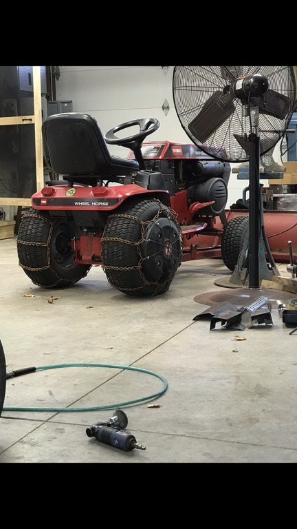

Randy Lindblad 71 #1 Posted November 12, 2020 Hello and thanks for any feed back can someone tell what this tractor has for a rear ended I want to say it’s an Eaton 700 can someone confirm thanks Share this post Link to post Share on other sites
gwest_ca-(File Mod) 12,014 #2 Posted November 12, 2020 Welcome to the forum. A 315-8 will have Wheel Horse's own cast iron Uni-drive 8-speed transmission. Click on the fuzzy picture that is mostly missing in the link for more info. Garry Share this post Link to post Share on other sites
Randy Lindblad 71 #3 Posted November 12, 2020 (edited) Thank you for toy input I also have another one haha . I have a 1988 516-h hydro and I really enjoy using it to tow small trailer I have seen quite a few folks suggesting it’s 700 Eaton hydro is obviously not as strong as an 1100 Eaton I don’t want to damage it I. Any way but I’d like to know if it would be safe to mount a snowblower on the front of this one thanks for responding Edited November 12, 2020 by Randy Lindblad Share this post Link to post Share on other sites
gwest_ca-(File Mod) 12,014 #4 Posted November 12, 2020 The 315-8 will blow snow like no tomorrow and if it can't blow it it will push it until you loose traction. Far stronger transmission than the 516-H. If you download the D&A file in the link above it lists the attachments recommended. Here is one for the 516-H so you can compare the attachment lists. Garry 1 Share this post Link to post Share on other sites
