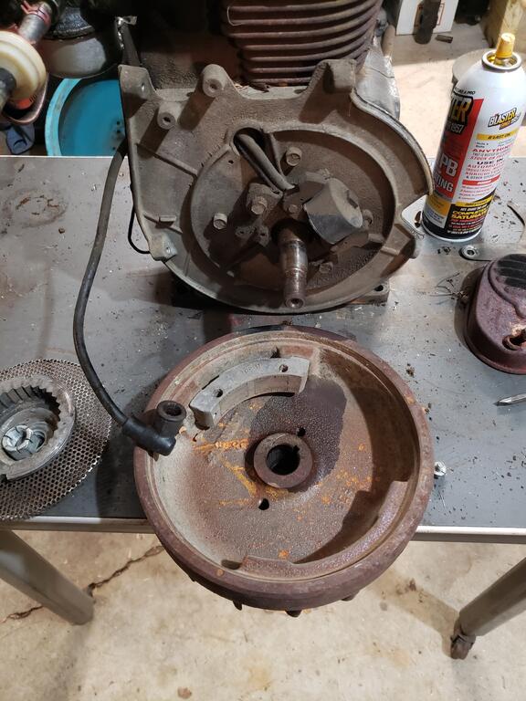

71_Bronco 1,072 #1 Posted November 6, 2020 Doing a transplant in my Commando 8 finally. The stock motor has the starter/generator, and the 3-groove pulley on the output shaft. Replacement motor has a recoil starter and the same size / length output shaft. Replacement motor came off a leaf-blower. 2 questions: - Should I pull the flywheel on both and ensure the electronics under are the same? Or should they be the same and no reason to pull the flywheel? - I forgot to take a measurement of where the triple pulley sits on the output shaft. I took a picture, but no measurement. How critical is this, or should I just eye-ball it and that should be okay? Thanks! Share this post Link to post Share on other sites

71_Bronco 1,072 #9 Posted November 14, 2020 Got a chance to work on this project. Got the engine out of the leaf blower, recoil starter and tins off, and pulled the flywheel. Here's whats underneath. Will be working on the WH K181 next to see what I need to convert over. Share this post Link to post Share on other sites
