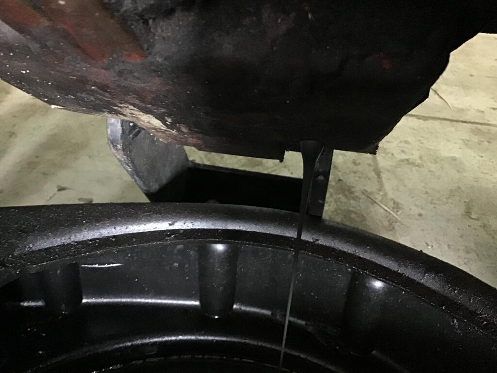

Pullstart 68,941 #4 Posted November 1, 2020 Great tractor you’ve got! Yes, there’s a hump in the middle of the transmission. It’s common for us folks to drain with the front end lifted high as safely possible, then flush the transmission with diesel fuel or kerosene, as many times as needed until it runs clear, then refill. I like to jack up the left side of the tractor for filling through the fill hole near the left rear corner of the case, or you could pull the fender pan and shifter and fill through the shifter hole. 1.5-2 qts is good. At level, 1.5 qts will fill the case. 2 CT’s is what some limited slip gear cases run, so I figure it’s safe to add a little extra. 2 Share this post Link to post Share on other sites

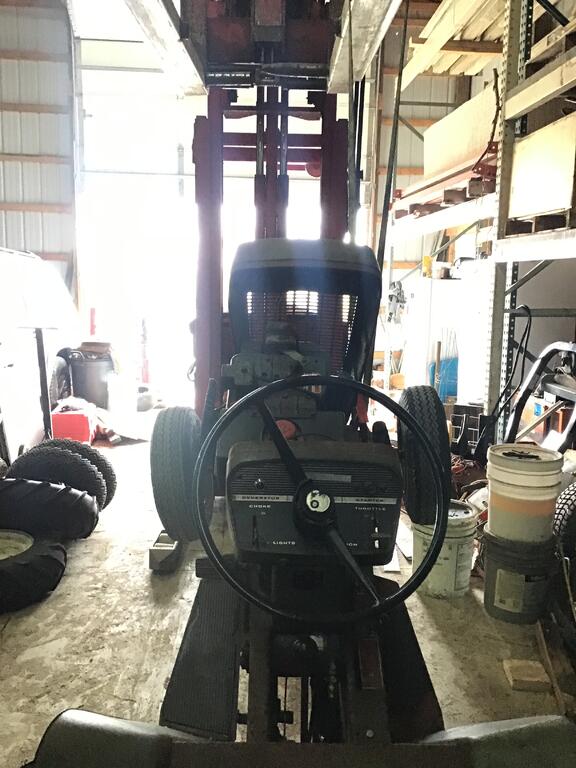

Hedley8888 11 #5 Posted November 1, 2020 Thanks 953Nut & SylvanLakeWH it was in the garage when I bought my house. It has been with the property since 1975. I am its new custodian. I bloody love this Wheelhorse. its so handsome 5 2 1 Share this post Link to post Share on other sites

oliver2-44 11,258 #7 Posted November 1, 2020 That a great looking C-120. One of he best GT's wheelhorse made. The 12hp is easy on fuel, but enough power to run almost any attachment. 3 Share this post Link to post Share on other sites
tom2p 2,394 #8 Posted November 1, 2020 2 hours ago, Hedley8888 said: Thanks 953Nut & SylvanLakeWH it was in the garage when I bought my house. It has been with the property since 1975. I am its new custodian. I bloody love this Wheelhorse. its so handsome great looking C-120 - and great house warming gift ! 2 1 Share this post Link to post Share on other sites
peter lena 9,779 #9 Posted November 1, 2020 HEDLEY, having recovered a few tractors , I found that transmission lubrication issues ,go hand and hand with neglect . usually the drain and refill , is not , a 1 and done service. I get the best results with hours of use and road time , visualize that new oil cleaning / lubricating and flushing out the moisture and crud that was inside. Use every gear and hi/lo range to operate and lubricate each function. found the second oil change , is the best gain , as it stays looking fresh with no issues , shifting is easy and smooth . also detail lube every spot on the clutch linkage, to insure there are no hang ups. change the shift boot . found most w/h linkage to be neglected ,with solid rust and often binding , regularly detail lube everything on your horse , and feel how easy it goes about its work. good luck with your recovery , keep us informed , pete 1 1 Share this post Link to post Share on other sites

The Tuul Crib 7,347 #13 Posted November 4, 2020 Nice rig and truly a survivor! Spit shine and a tuneup you'll be good to go. T😎 Share this post Link to post Share on other sites

WHX?? 55,192 #15 Posted November 5, 2020 Sounds like the fellas got you covered so I'll just Those early 70s c series are always favs with me Share this post Link to post Share on other sites
12Horse Paladin 1,038 #16 Posted November 5, 2020 On 11/1/2020 at 8:35 AM, Hedley8888 said: Thanks 953Nut & SylvanLakeWH it was in the garage when I bought my house. It has been with the property since 1975. I am its new custodian. I bloody love this Wheelhorse. its so handsome Finest WH made, some might say... (Or just me😉😊 ) Welcome! Like those Ags on the back!👍🏼 1 Share this post Link to post Share on other sites
