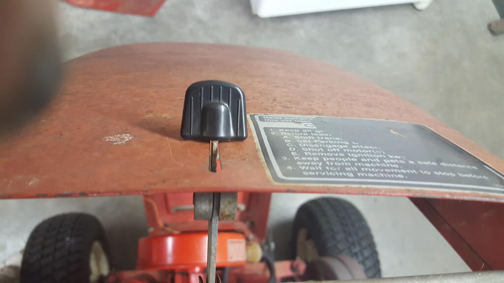

Gregor 4,847 #1 Posted October 31, 2020 (edited) Has anyone ever successfully removed and reused the plastic knob for the hood latch? It says they are still available to order, but I have been fooled before. NEVER MIND. That was much easier than I expected. Edited October 31, 2020 by Gregor Share this post Link to post Share on other sites
rjg854 12,841 #2 Posted October 31, 2020 I've had them come off, and reglued them with super glue, seems to be still holding up well. Glen Pettit was selling them at one point. Not sure if he still has them or if he's able to make more Share this post Link to post Share on other sites
SylvanLakeWH 30,587 #3 Posted October 31, 2020 Here’s a link to vendor section if needed: Share this post Link to post Share on other sites

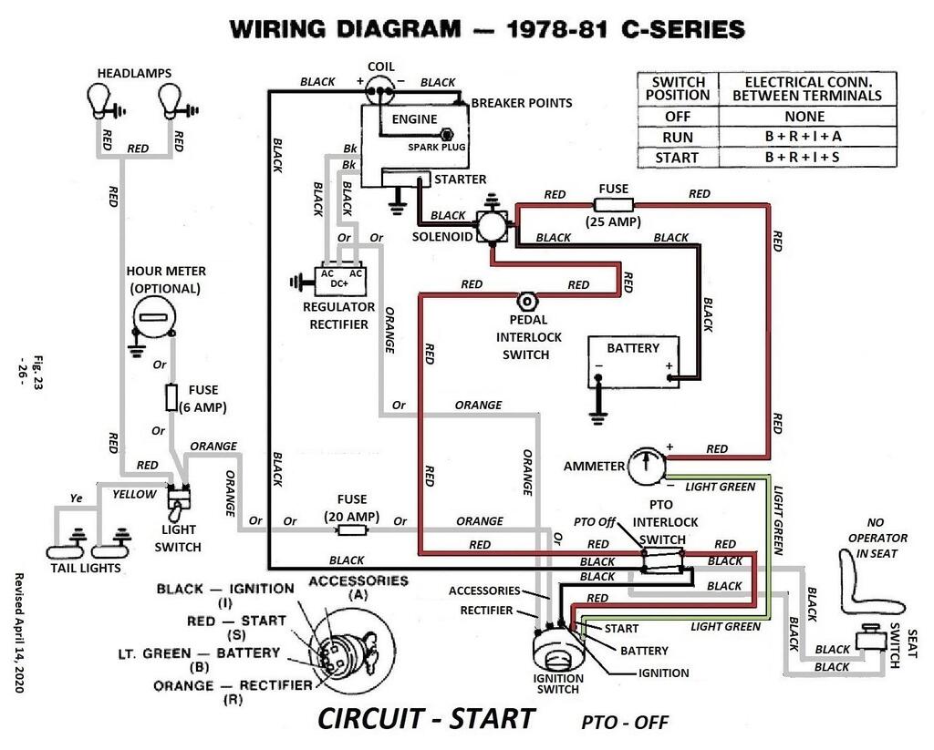

Gregor 4,847 #4 Posted October 31, 2020 I am tearing own the C-141. I am making a legend of all the wiring, and where each individual wire goes. I have seen a wiring diagram for this tractor, and have it saved on my computer, but it doesn't match my wiring. Is there another wiring diagram available? Share this post Link to post Share on other sites
8ntruck 8,601 #5 Posted October 31, 2020 With the current 3d printer technology, seems like this would be an easy piece to reproduce. Woulden't be a very tough one to model in CAD either. Share this post Link to post Share on other sites
Gregor 4,847 #6 Posted November 1, 2020 I did manage to find another wiring diagram that matches my tractor. I find it interesting that they show a black cable running from the battery + side to the solenoid, and from the other side of the solenoid to the starter. Is this factory correct? I like to do things as they were done originally, but this seems odd. Share this post Link to post Share on other sites
lynnmor 8,623 #7 Posted November 1, 2020 23 minutes ago, Gregor said: I did manage to find another wiring diagram that matches my tractor. I find it interesting that they show a black cable running from the battery + side to the solenoid, and from the other side of the solenoid to the starter. Is this factory correct? I like to do things as they were done originally, but this seems odd. It's likely that all of the heavy battery cables were made from black wire. 2 Share this post Link to post Share on other sites
Horse Newbie 7,402 #8 Posted November 3, 2020 (edited) On 10/31/2020 at 8:47 PM, lynnmor said: It's likely that all of the heavy battery cables were made from black wire. My 1994 520H has a black wire on each battery post. The red rubber boot/ cover helps to show it as a positive (+) wire. Edited November 9, 2020 by Horse Newbie 1 Share this post Link to post Share on other sites
Pullstart 68,878 #9 Posted November 9, 2020 On 10/31/2020 at 8:21 PM, Gregor said: I did manage to find another wiring diagram that matches my tractor. I find it interesting that they show a black cable running from the battery + side to the solenoid, and from the other side of the solenoid to the starter. Is this factory correct? I like to do things as they were done originally, but this seems odd. Wheel Horse tractors are of the finest quality, but they weren’t known for spending the most money to build them! Likely, black was cheaper in more bulk than red. 1 Share this post Link to post Share on other sites
