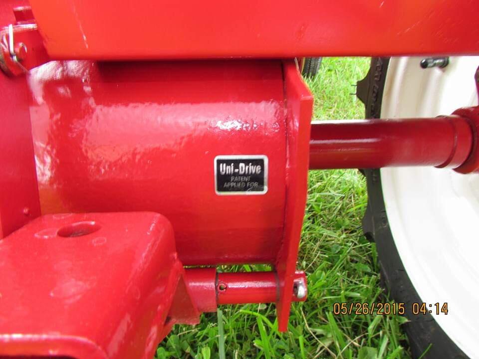

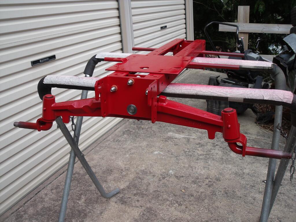

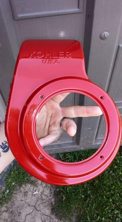

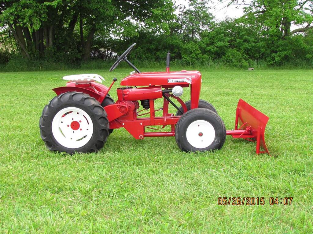

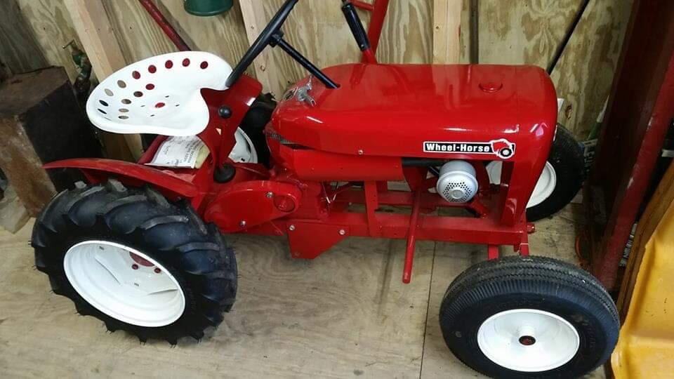

bottjernat1 2,194 #2 Posted October 29, 2020 This is what i have been doing for years. I either have someone blast the stuff or i use oven cleaner for the small stuff and a wire brush. Then i use these Rustoleum Primer and paint. My restored rj58 looks fantastic. ALso on my rj i used 2 or 3 coats of paint and 2 coats of a clear coat. I finished my rj in 2015 she still looks perdy no paint issues. Now the hood and rims were done by a local tractor body shop. But I painted the rest with rattle cans. Perfect match I think! 4 Share this post Link to post Share on other sites
