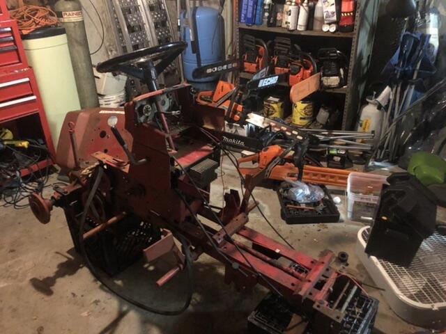

WheelhorseBob 1,550 #6 Posted October 26, 2020 And here she sits in my basement, it is literally the only space left under cover. Gonna give me something to do on snow days! 3 Share this post Link to post Share on other sites

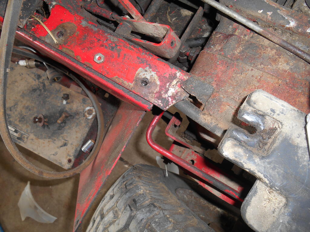

ohiofarmer 3,383 #11 Posted October 27, 2020 (edited) Now that your tractor is apart, it could be a great opportunity to add some reinforcement to those pesky transmission tunnel ears that come to a point at the back. the later tractors with an underseat gas tank are even worse because the metal is so thin. Those ears hold up the front seat mount and if you use the horse hard and on slopes, those ears can crack loose and even make the seat pan crack. I suck at posting pictures, but you can see the problems I am having. i added angle iron from a bed frame and a recliner to stiffen the whole affair up. Furniture steel is thin and tough and well suited to the purpose. With any luck, i will get a repair thread showing the process that will hold up big people like me and Eric Edited October 27, 2020 by ohiofarmer 1 Share this post Link to post Share on other sites

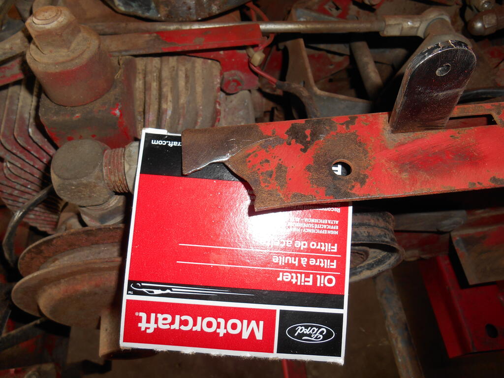

scWHhauler 96 #12 Posted October 28, 2020 I see that I not the only one using good Ford Motorcraft parts on their Wheel Horse 1 Share this post Link to post Share on other sites
