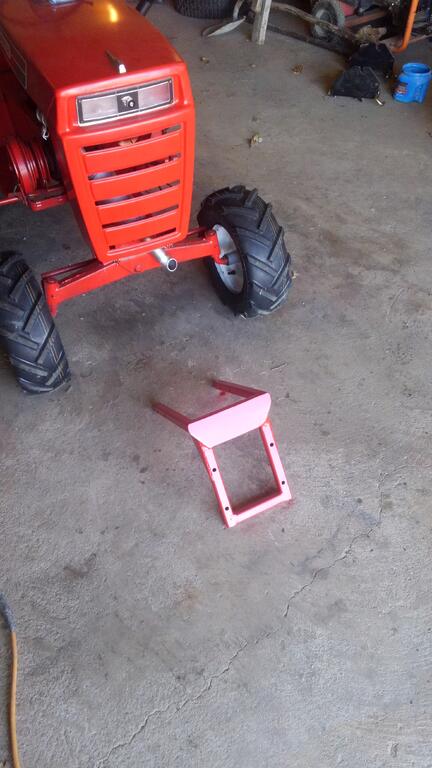

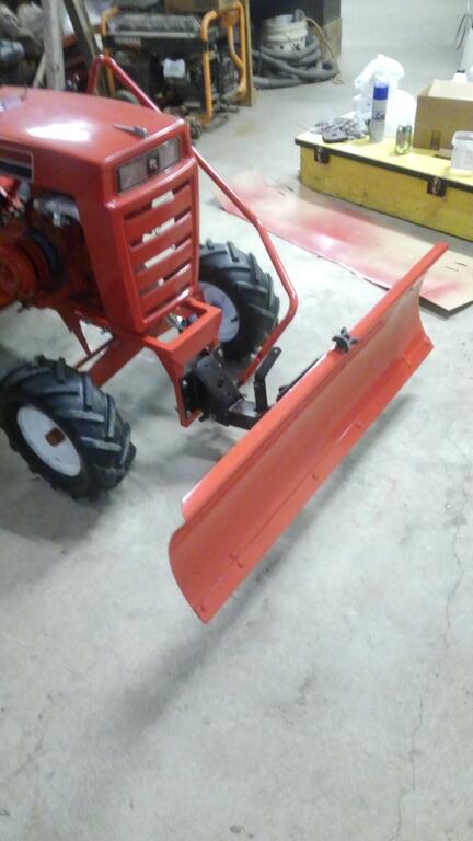

Rusty Tinsnips 477 #1 Posted October 24, 2020 I made an old MTD snow blade (square peg) fit on this Raider 10 with Tecumseh HH100 (round hole) by fabbing a bracket to mount it on until I find the proper wheel horse blade. I have changed the oil, gas filter, and transmission oil and tires. Put a rebuild on the LME 29 carb but still seems a little sketchy. I put a new spark plug in it and it felt a little "off" going in and felt like it wouldn't get completely tight, like it was stripped. Started it up and it ran for 5 seconds and blew the spark plug 20 feet out into the driveway. Oh man, that sucked. So I put the old plug back in, it seemed to go in fine and snugged right up. Don't know what's going on there, now I'm scared to try and change it again. Right now it runs pretty good. Seems to have a slight miss, can't tell if it's the carb or plug. Have started running seafoam in the gas. Hope it snows tomorrow. 8 Share this post Link to post Share on other sites
