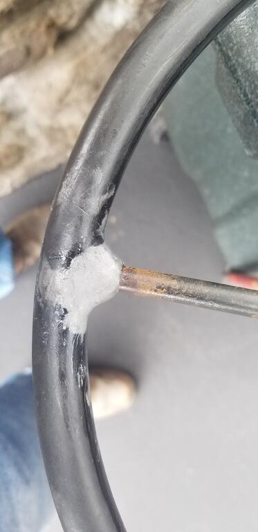

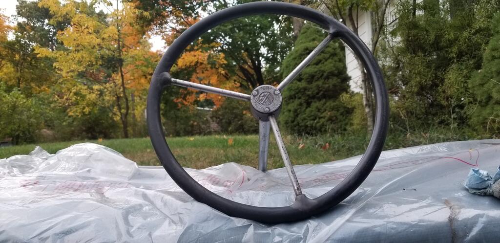

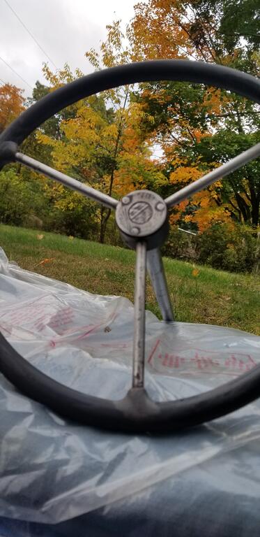

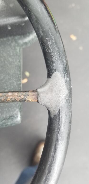

AMC RULES 37,220 #1 Posted October 21, 2020 Getting close to putting this RJ wheel back into paint. Thinking I' m going to paint the whole thing, rim, spokes, hub and all. Wondering what is the best way (product) to prep the rubber rim for paint. Anyone else have experience doing this, willing to share here? Thanks in advance. 1 Share this post Link to post Share on other sites
AMC RULES 37,220 #2 Posted October 21, 2020 Getting close to putting this RJ wheel back into paint. Thinking I' m going to paint the whole thing, rim, spokes, hub and all. Wondering what is the best way (product) to prep the rubber rim for paint. Anyone else have experience doing this, willing to share here? Thanks in advance. 2 Share this post Link to post Share on other sites
echris 1,425 #3 Posted October 21, 2020 Is that JB Weld on the spoke ends or something else? Looks really good either way. 1 Share this post Link to post Share on other sites
WHNJ701 4,165 #4 Posted October 21, 2020 On my david bradley suburban the wheel is welded on, I redid it place, I dremeled out the cracks and filled with jb weld. I scuffed the wheel real good, primed it, sprayed it Rust-Oleum gloss black and then cleared it. No issues 1 Share this post Link to post Share on other sites

echris 1,425 #8 Posted October 21, 2020 Oh, I loves me some epoxy. There's a flavor for nearly every job. Nice! Share this post Link to post Share on other sites
Achto 29,478 #9 Posted October 22, 2020 (edited) 10 hours ago, AMC RULES said: Anyone else have experience doing this, willing to share here? When I did the steering wheel on my Raider I wet sanded the steering wheel with 600grit then washed it with a preps all solvent. Same solvent that I use for washing all parts before I paint them. Note if you have to prime over your filler work, use a black primer. This way if the paint does eventually rub through the primer is still black giving more time. Edited October 22, 2020 by Achto 4 Share this post Link to post Share on other sites

AMC RULES 37,220 #13 Posted October 22, 2020 Is rubber, yes. Hard though, the non squishy type. You can never get the black crap to stop coming off of it. 1 Share this post Link to post Share on other sites
ebinmaine 73,228 #14 Posted October 23, 2020 I've consulted with my local Paint Department and the concern we have is that the rubber does not have the same flexibility as the steel, obviously. She and I are both thinking that if you try to put paint on the rubber it's going to chip off eventually. I don't know if there's an additive that you can put in regular paint or automotive paint that would make it more flexible. Her best suggestion would be to combine what Richard said with the vinyl dye on the outer rim and then try to get a regular metal paint that is the closest possible color to do the rest of the wheel. 1 Share this post Link to post Share on other sites

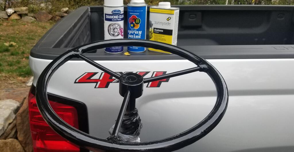

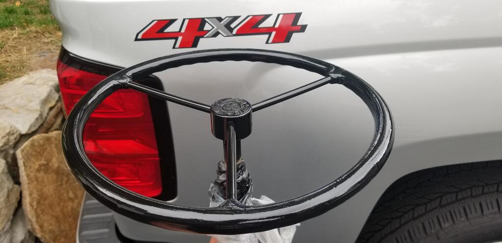

AMC RULES 37,220 #17 Posted October 24, 2020 A Scotchbright & straight acetone finally cut through all the rubber gunk. Sealed the new paint with Eastwoods Diamond Clear coat. Certainly not perfect, but a night and day improvement over what I started with. Going to work until a better one is found. 2 Share this post Link to post Share on other sites
