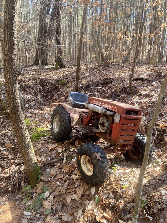

Greentored 3,221 #52 Posted January 10, 2021 12 minutes ago, ebinmaine said: Holy Overdrive Batman!!! Whatsya pulley sizes there mistah?? 8/4. It’s a little much, will probably drop to a 6 up front. It’ll run a good 5mph in low range 3 haha. Id leave it and just run in lower gears on trails and save high 3 for the occasional blast, but can’t help but think of that poor input shaft zinging almost 3x the engine speed haha. I want this thing to last! 1 Share this post Link to post Share on other sites

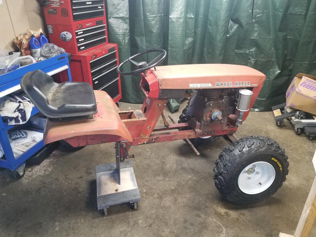

8ntruck 9,358 #53 Posted January 10, 2021 On 12/19/2020 at 9:30 PM, Greentored said: Got some bills to pay and need to move some Horse inventory, but raided the parts and made a little progress. Going to run a C gas tank out back in tandem with the B tank. No 30mph wheelie machine this time ha, going more for a 15-18mph utility machine. Pretty sure it’s gonna be Kohler powered since I have somehow acquired a stack of K301s. Since it started as a B100, think I’ll name it the B-1 bomber! Going to build yourself a bone then. Share this post Link to post Share on other sites

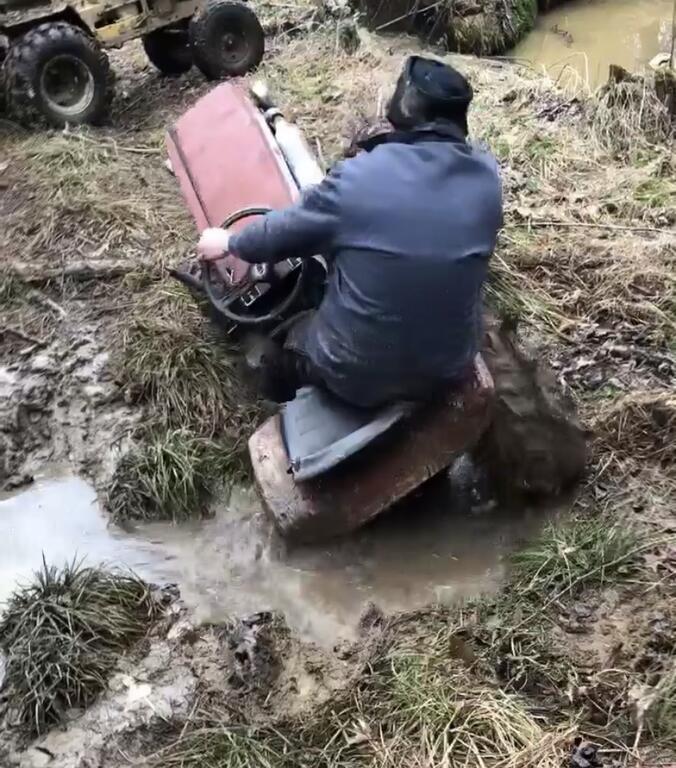

Greentored 3,221 #54 Posted January 23, 2021 Update: first shakedown woods run! IMG_2215.MOV 2 1 Share this post Link to post Share on other sites

Greentored 3,221 #57 Posted January 23, 2021 10 hours ago, ebinmaine said: VERY nice Thanks buddy! Still plenty to do- theres a lot of masking tape and zip ties holding things they shouldn't ha. OH- and went to a 5" on the trans, so 8/5- MUCH better. Low range is still relatively 'crawling', and maybe 15-16mph flat out in high. Plenty. 4 Share this post Link to post Share on other sites

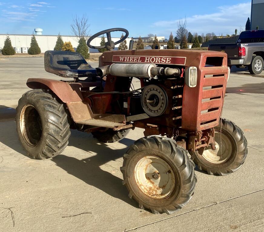

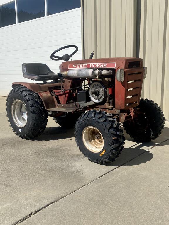

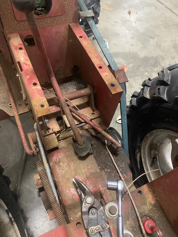

Greentored 3,221 #66 Posted February 21, 2021 More updates: made some linkage and hooked the brakes up to the deck lift arm, fabbed up a dual throttle setup (dash and foot) and threw some 19x7 and 26x9 atv tires on. This thing is a beast! 5 4 2 Share this post Link to post Share on other sites

OldWorkHorse 3,156 #69 Posted February 22, 2021 9 hours ago, Greentored said: More updates: What is the speed on sumthing like this and pully sizes ur running? I'm building somthing like this and just trying to see what pulleys work well for people. 3 1 Share this post Link to post Share on other sites
Greentored 3,221 #70 Posted February 22, 2021 1 hour ago, OldWorkHorse said: What is the speed on sumthing like this and pully sizes ur running? I'm building somthing like this and just trying to see what pulleys work well for people. I have an 8 on the engine and 5 on the trans, it runs 16mph on gps with the 26” tires, at 3000 rpms. 7/5 seems to be the standard for the guys trail running Horses. You can run a smaller trans pulley but they can slip if you get into mud or water👍 1 3 Share this post Link to post Share on other sites

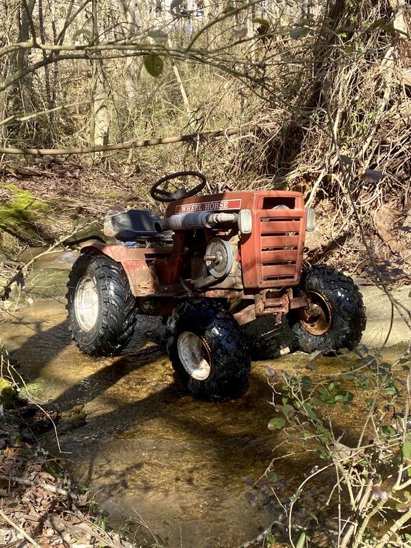

Greentored 3,221 #71 Posted March 1, 2021 The B-1 went on it’s first group ride on Saturday! Fouled a plug, followed by a ‘not charging’ issue which was a loose connection at the regulator. Replaced the plug, then later shorted one of the wires and killed the regulator. Threw a new battery in and rode the rest of the day without a hiccup! Stay tuned- there’s a lot more to come on the ol bomb. 2 1 Share this post Link to post Share on other sites

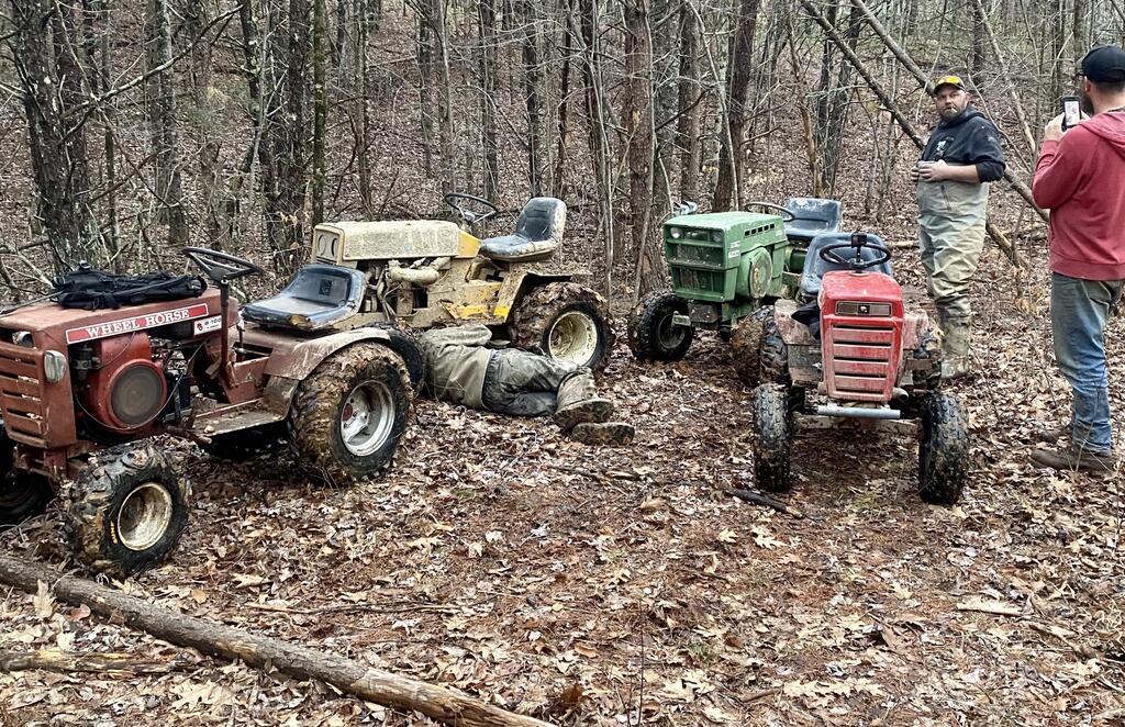

Greentored 3,221 #72 Posted March 1, 2021 We love our horses best but respect these other bombers too. That yellow machine is an animal, powered by a fully built, 5000rpm K341, making close to 30hp! 4 Share this post Link to post Share on other sites
