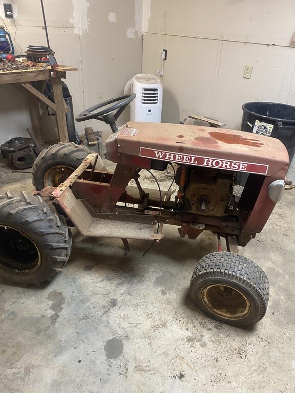

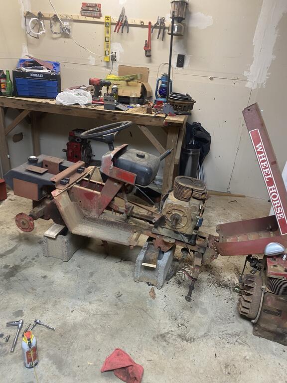

Greentored 3,221 #46 Posted December 20, 2020 Got some bills to pay and need to move some Horse inventory, but raided the parts and made a little progress. Going to run a C gas tank out back in tandem with the B tank. No 30mph wheelie machine this time ha, going more for a 15-18mph utility machine. Pretty sure it’s gonna be Kohler powered since I have somehow acquired a stack of K301s. Since it started as a B100, think I’ll name it the B-1 bomber! 2 Share this post Link to post Share on other sites

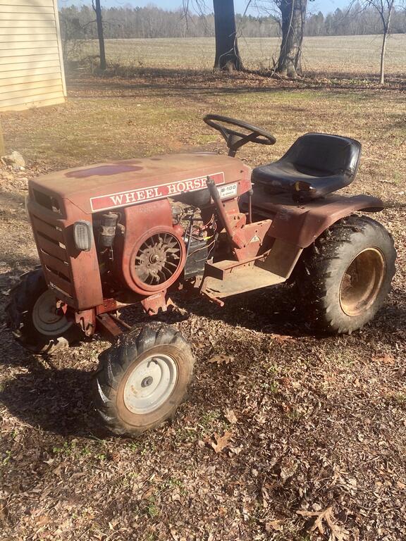

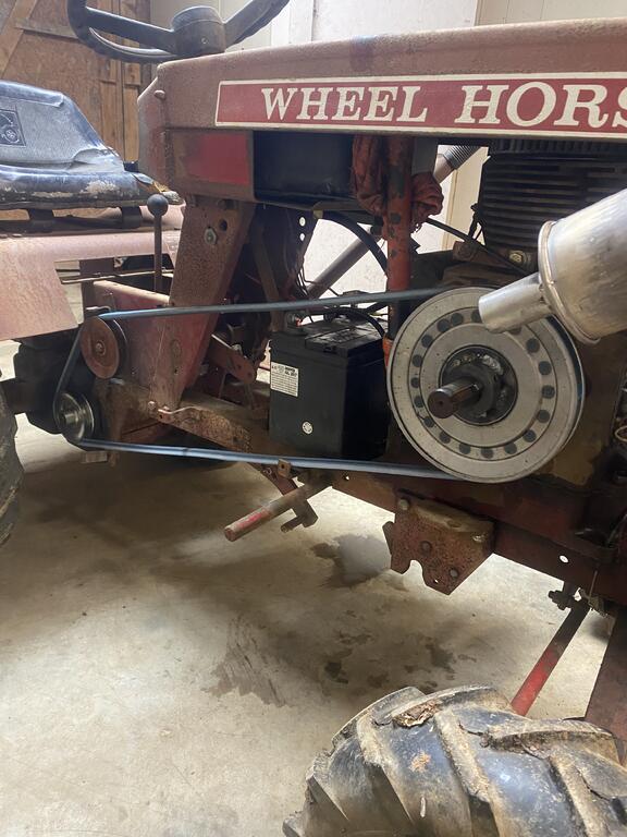

Greentored 3,221 #50 Posted January 10, 2021 Update: locked myself in the shop after work Friday minus one trip to the store for a belt and exhaust elbow. Raided parts, swiped tires off the ‘for sale’ section for now, 22 hours later including a full nights sleep, the B1 bomber drove out under its own power! Plenty left to do, like brakes, wiring correctly instead of twisting and masking taping ha, lights, side exit exhaust, belt guard etc, but it lives. The stock, tires K321 is more than enough for this👍 2 3 Share this post Link to post Share on other sites
